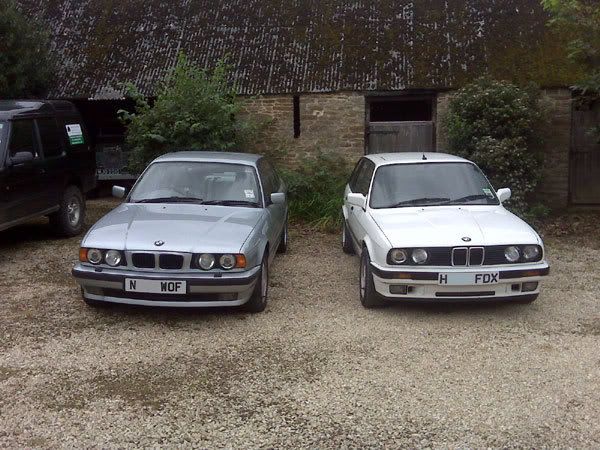

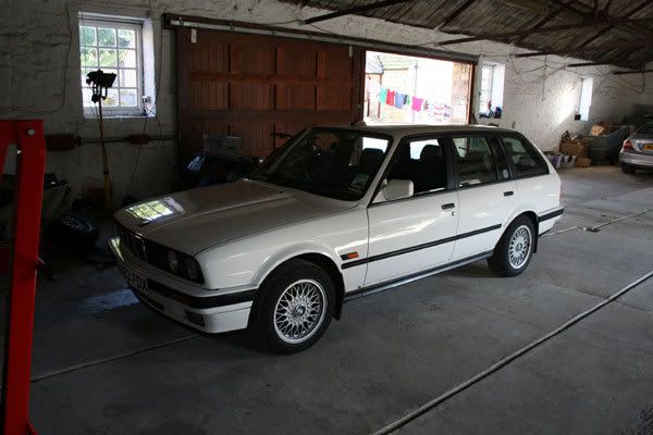

Base car is a 320i touring, picked up from Coventry a couple of weeks ago. Here it is parked up to my in between car - 525iX.

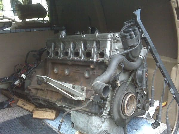

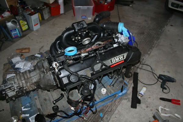

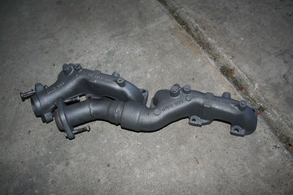

A month or 2 ago after deciding to do the project I bought an M30 engine from Theo:
Then got the car oop north to Derbyshire, were hopefully it hasn’t found it’s final resting place!

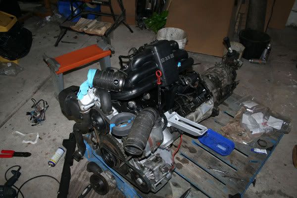

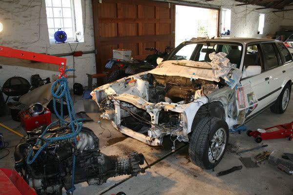

Got to work finishing off the wiring loom on the M30 (had been tidying it up a bit at work when I could grab a few minutes on the sand blaster at work.

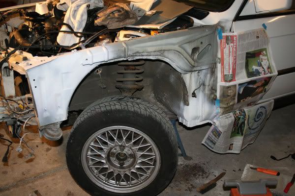

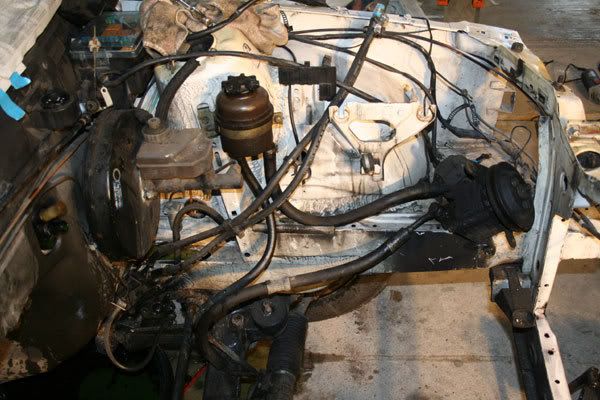

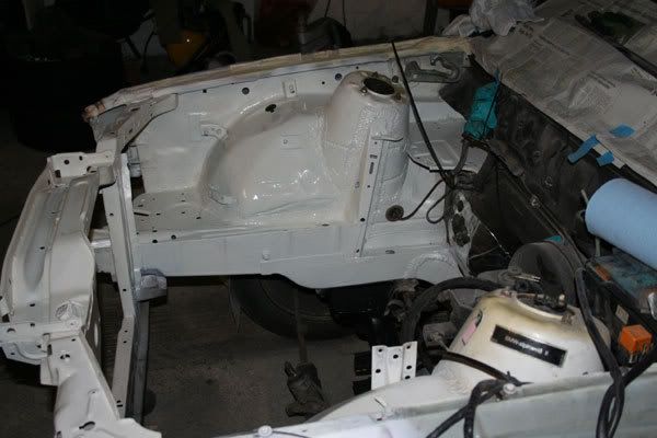

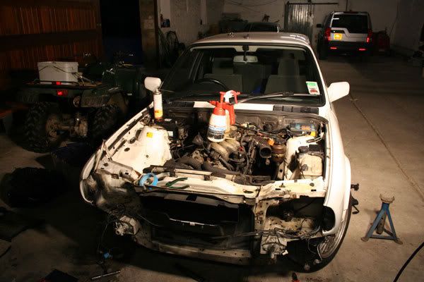

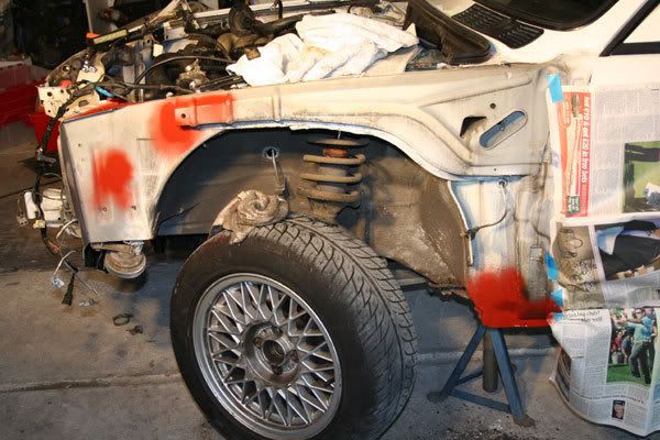

First night I got the front end stripped as I decided I wanted to try and spruce up the engine bay a little

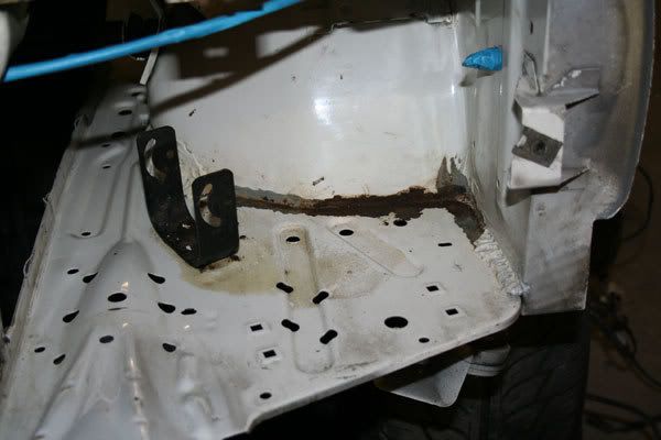

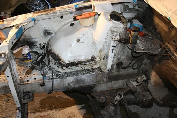

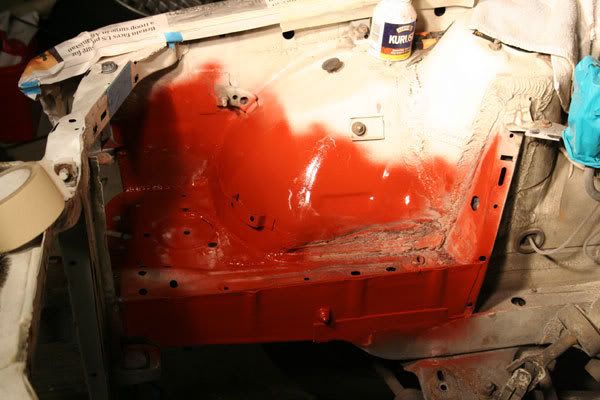

Found a small sport of rust under the n/s wing so that came off and got Ku Rusted then red oxided and painted:

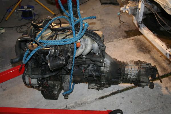

During a quick lunch time break (broke the digger!) the engine came out:
Then I started to get some weir noises from the timing cover of my other weekend toy so it was change the cambelt time! :( Another few hours lost”¦

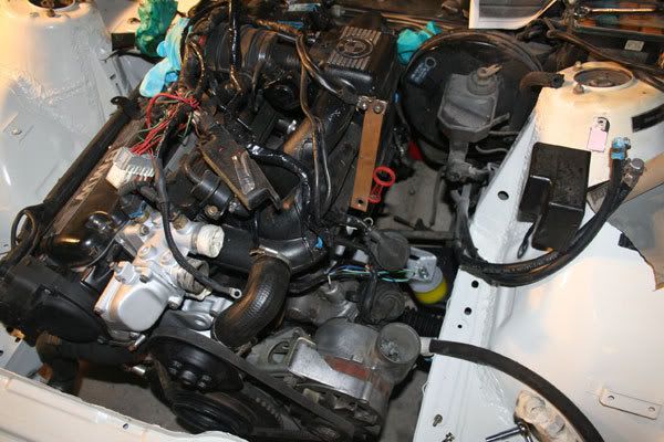

Same treatment as behind the wing for the engine bay as well as getting rid of the airbox bracket on the n/s inner wing

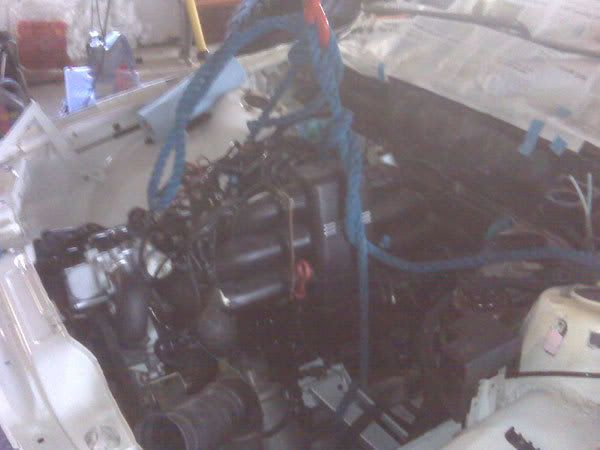

Then on Sunday morning I decided to try and ”˜pop’ the M30 into place before the Grand Prix ”“ I have to watch it really, working at McLaren people always ask about the GP and I look stupid if I can’t comment! Fortunately this one turned out to be the best of the year imho.
Anyway engine is nearly in, dad comes out to help whilst I am underneath manoeuvring the gearbox he decides a crowbar and pry bar would be useful, this denting and scratching my new paint. So out came the engine again!
This is how it stands at the moment, with a long way to go yet but good to have got it started, hopefully be able to spend a few more weekends on it before my 2 weeks off at Christmas, will be a perfect excuse to get away from the family!:

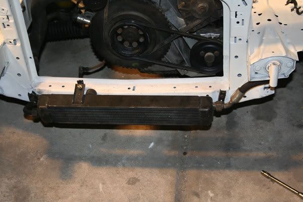

Oil Cooled bolted up and connected:

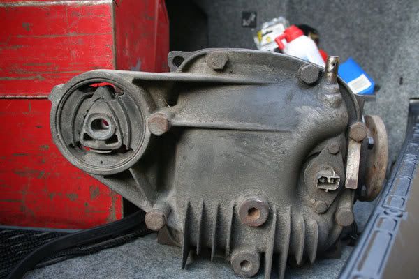

M3 rear diff, needs a new bush:
And renewed:

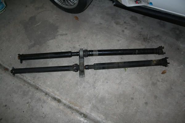

M3 prop ready to be bolted up:

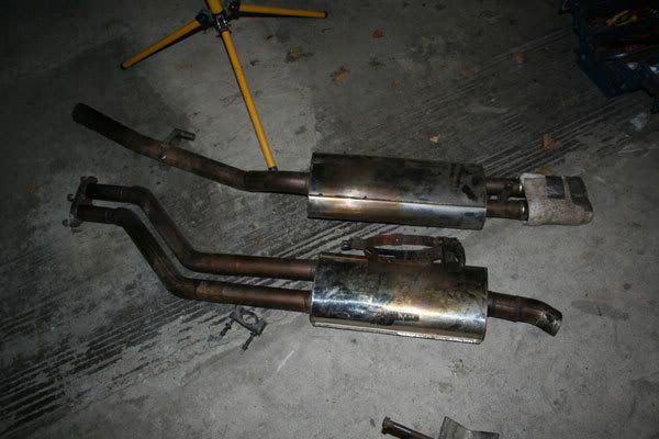

and exhaust:
And that is as far as I got!

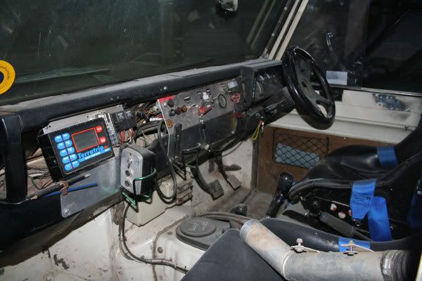

Well no progress to report on the E30 but thought I would show what is taking up alot of my time at the moment!
Got the next race on 16th November so in a bit of a rush!
Spent a couple of hours giving it a real rough and ready rub down ready to paint it (just so it is all the same colour, it has had such a hard life racing it'll never look nice!)
