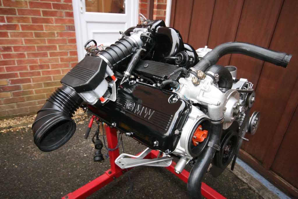

M30 install into calypso cab. Back on the road :)
jimbom30cab
- Tech 1 freak
- Posts: 7631
- Location: in the garage
I've got a M30 e34 535 gearbox but need a 325i output flange still.
I've managed to get the e28 M535i flywheel and clutch kit so it should spin up well and a BBR star chipped ECU.
What exhaust are you running on yours?

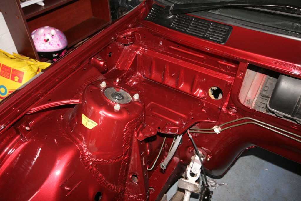

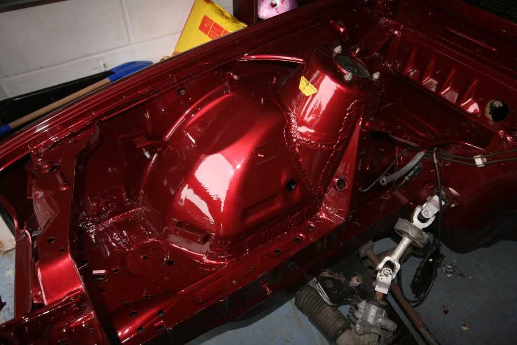

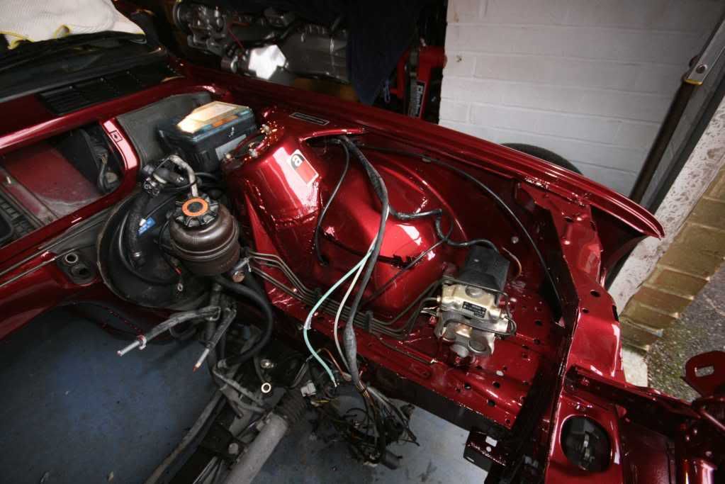

got the cabby back from the spray shop today and the engine bay is looking nice and Calypso'y....
few pics
Getting ready to go:
nice and red, should hide the rust well.
So next up is to put the engine bay back together and tidy up the wiring. Then fit the flywheel, clutch and box to the M30 lump, few final bits like prop shaft and get the radiator brackets sorted.
few pics

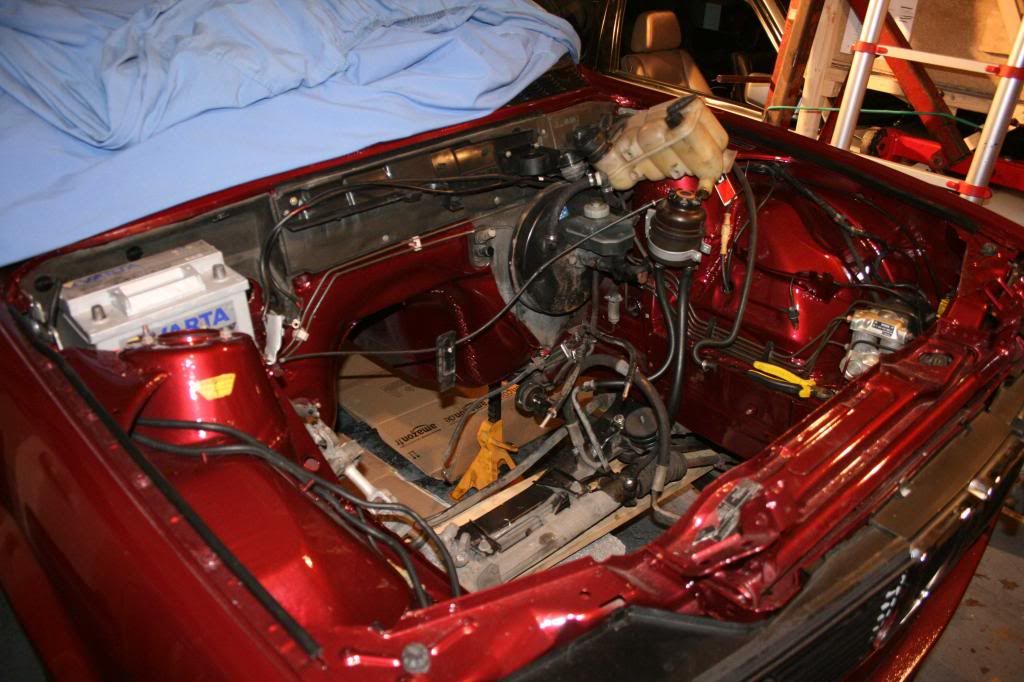

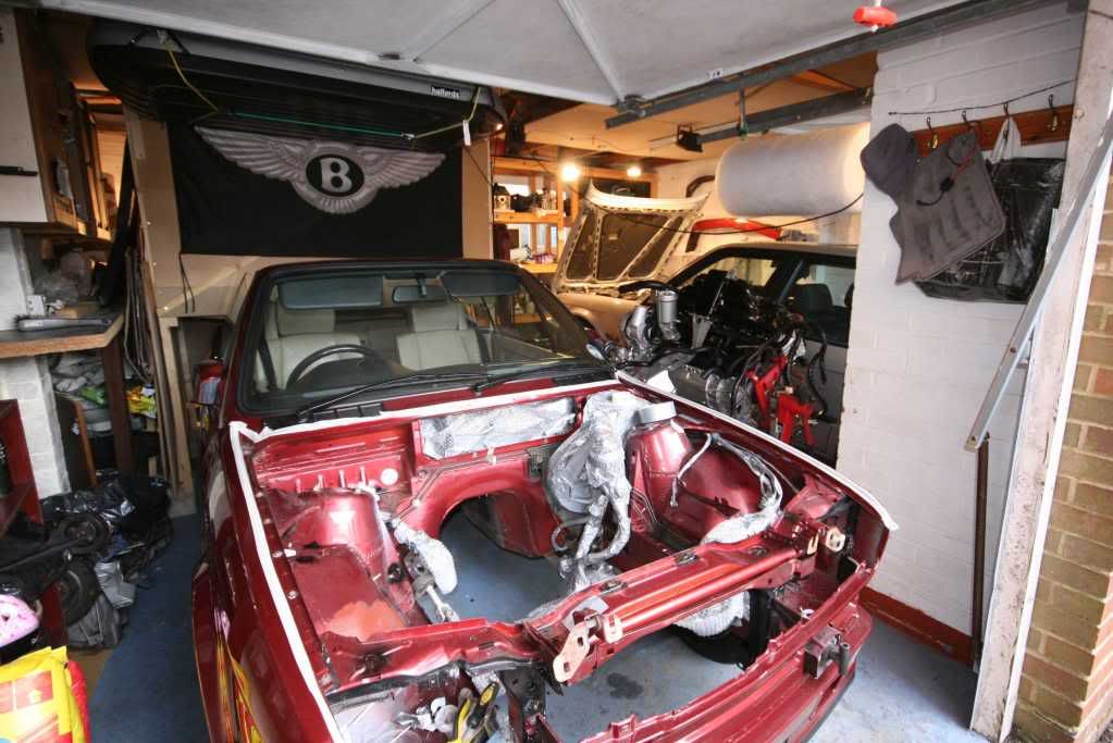

Right gents, we're back on track for this conversion after a little love affair with a tech1 in need of some TLC
So got the car jacked up and started putting the engine bay back together.
Need to find a nice way of securing the header tank as the donor car was a 318.

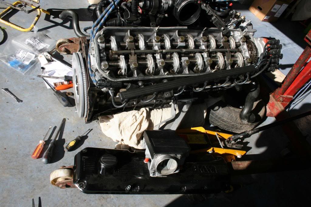

to be honest, i'm lacking a bit in confidence getting this conversion done, so thought i'd share my tribulations on here for everyone to laugh at
The problem with the engine crane i think is the piston seals passing, i'll need to get a mobile repair bloke out. Its a really solid crane so worth spending a few quid to get it fixed. Besides, i need to get it done as this lump ain't going anywhere otherwise.

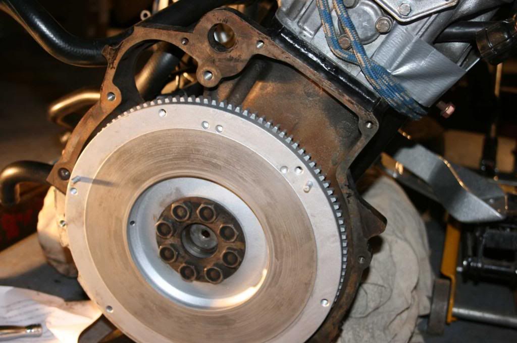

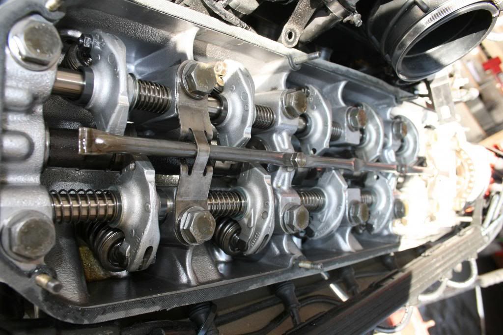

So whilst putting on this e28M535i flywheel, i noticed the engine was quite easy to turn over and i didn't get the usual 2 "stiff" bits per revolution as the pistons compress. The timing is dead on, head bolts tight, valve clearances set and the spark plugs are in. Is there a problem or do they turn over quite smoothly ??
There was a spigot bearing in there already which i was surprised about for a auto lump ? Anyway, i couldn't get it out at all, so i greased it up and fitted new cover, felt and cap.
I've tightened these flywheel bolts up to 105nm
I've ordered a load of clutch cover bolts and gearbox bolts from BMW as i had none with the manual box i bought.
I'll next get the clutch and gearbox on.
Then i'll change the diff, fit the prop and heatshield.

Jim, is there no resistance at all on turnover?
leeparkes
- Posts: 9535
- Location: Black country
No, imo M30's can be a quite heavy to turn over when they compress, can you hear any hissing anywhere?jimbom30cab wrote:
Good to hear you got cracking on it though! unlike some *cough* Rav.
jimbom30cab
- Tech 1 freak
- Posts: 7631
thanks gents, i guessed it must be the valve clearances, can't be anything else as the head has been pressure tested and is tight on and the timing is correct. So i re-did the valve clearances and it is now a bit better, there is resistance and lots of hissing and puffing. its still quite easy to turn over but the belts are slack and i've not done the crank nut up yet (if this makes a difference) and i was levering it with the flywheel bolts.
can you see anything obviously wrong here?
Anyway, don't have much choice but to fit it really and do a compression test so i thought i'd start by changing the diff and then the first torx bolt sheared off. Gutted. So I removed the hydraulic ram from the engine crane to take in for a service tomorrow.
Gutted !!
thanks again
Gutted !!
thanks again
