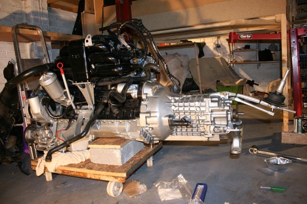

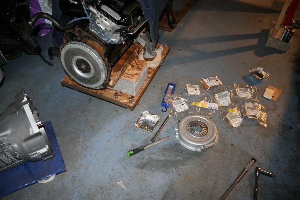

Right, got the clutch gear and gearbox on, went ok, nice for something to go to plan for a change
had to get new clutch cover and gearbox bolts
chain block on the gearbox as engine crane is still dead
and here she is
Prop and heat shield next

Jim, is there a spigot bearing actually fitted in that flywheel photo?
jimbom30cab
Tech 1 freak
Posts: 7634
Location: in the garage
Sat May 04, 2013 9:10 pm
There is John, it was well tight in there. I was surprised as it was an auto lump, it was definitely there as I couldn't get the f!ucker out at all mate.

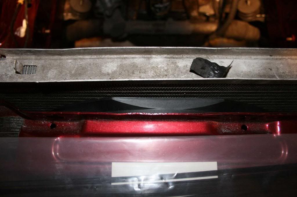

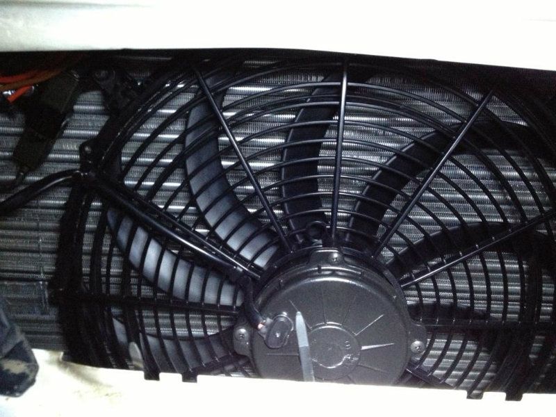

Needed to get the fan fitted and the header tank as my donor car is a 318. So wondered round B+Q looking for inspiration and found this 2mm thick alluminium strip
Used it to mount the fan, its really close to the front of the rad which is good.
and made a couple of brackets for the header tank
i'll take em all off, paint them, rust proof the holes and job's a good um

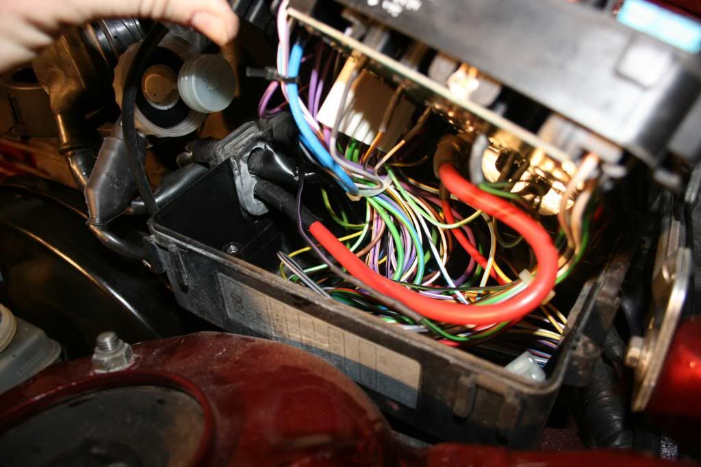

Made a bit of progress today

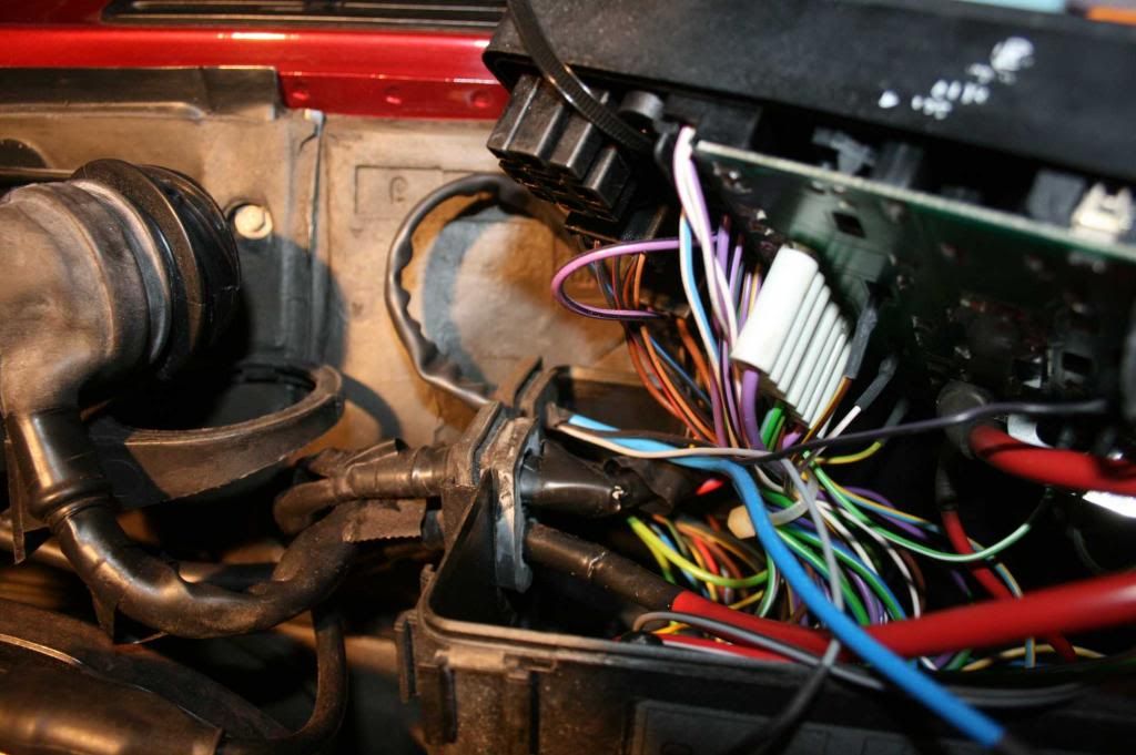

fitted the lovely Danthe loom, great bit of kit and absolute bargain also :wink: , thanks Dan
Then tidyed up all the engine bay wiring and fiddled a bit with the fan to get it right up to the radiator.
bit of rust proof painting and that's about it really, takes longer than you think to get everthing ready in the bay.
should be ready for the engine any day now but my engine crane is still in for repair, for the sake of £150 i'm tempted to just buy a new one

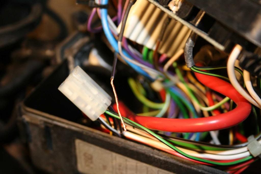

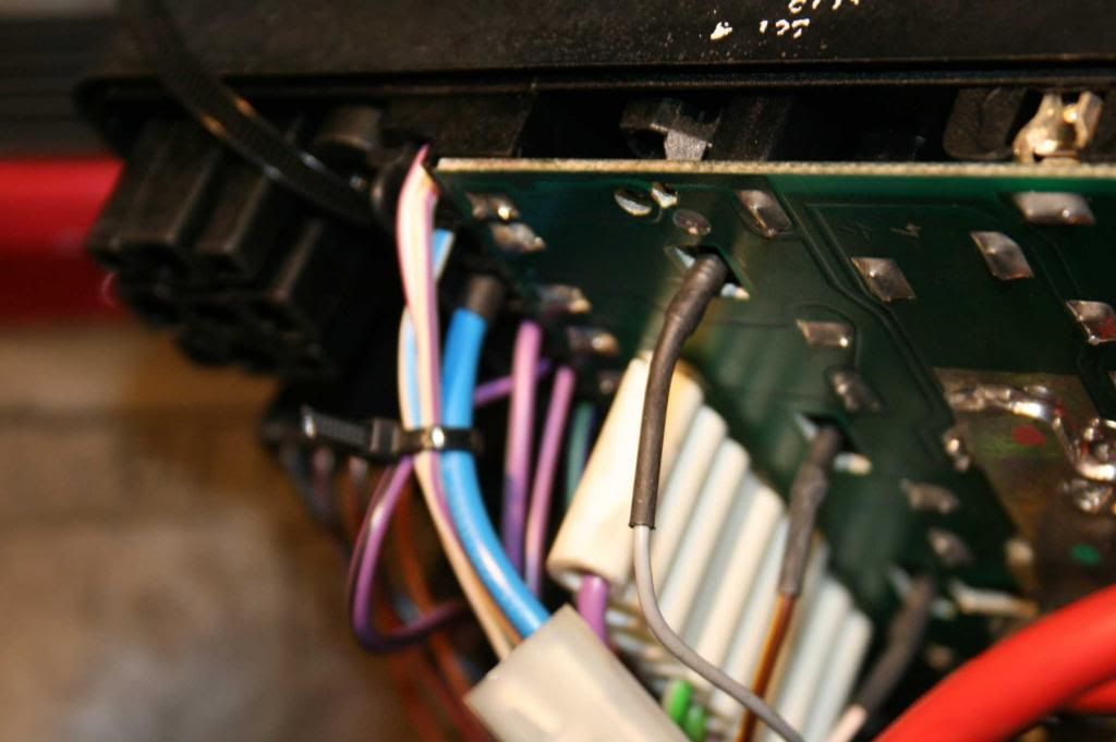

i ran the fan loom through this spare gromit
put a relay into K1 and attached the wire - the one with the long heatshrink on here
also attached the power to the underside of fuse way 3 - its the big blue one here
power to the thermostatic switch wire joins this black and green (unused air con wire)

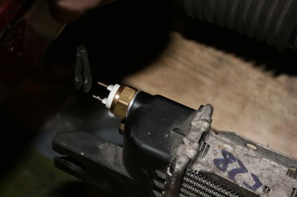

thermostatic switch

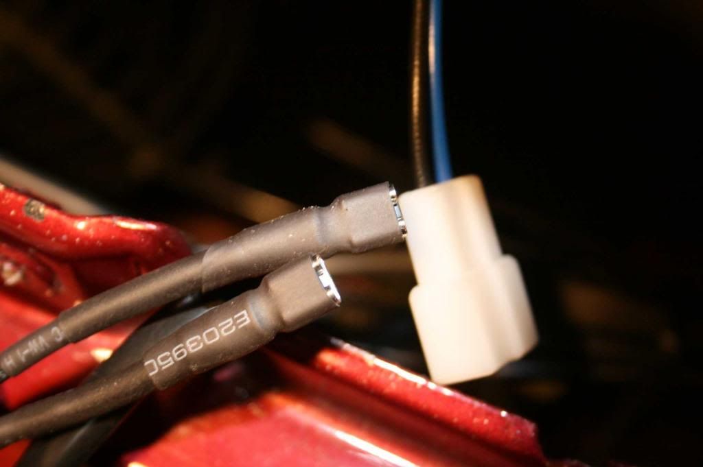

put these heat shrink covers on the connection to the fan
got the fan right up to the rad to maximise cooling
soldered then heat shrinked the fuse box wire

Wire up another relay/temp switch to your rad while you can!
It's just 2 more wires from your fuse box to the front of your car.
You can have your low speed resistor sitting in stock position
M30s do generate heat - and you don't want to have your fan spinning at full speed all the time.
