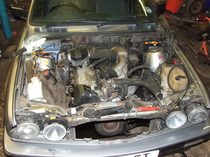

I missed this again... Yeah the 50mm are the ones to go for, I just ordered my latest set for my new M30 conversion about a week ago, they ended up around £22 delivered IIRC. Good mounts, BUT won't work with any factory BMW cast ally engine mounts as they are too thick to have enough thread to bolt up. Lee's steel mounts work perfectly though :cool:
Awful picture but you get the idea
Sit the engine in lovely 8)
