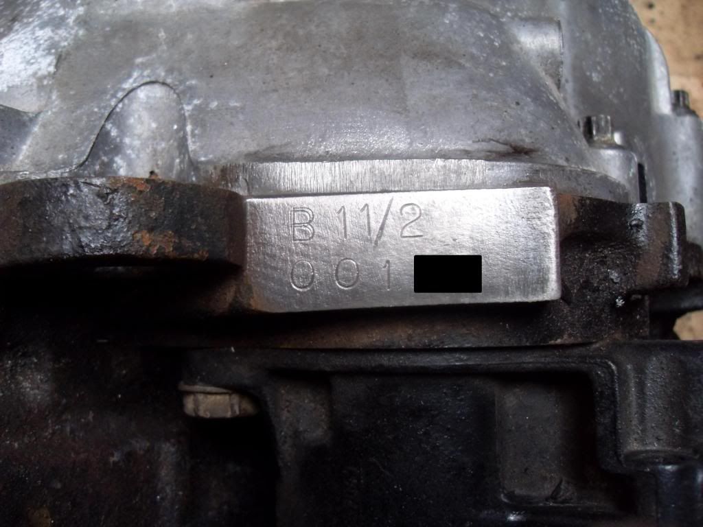

Engine number is on a machined flat to the right of the inlet side engine mount, just above the block:sump interface.
You often need to use a wire brush and Jenolite to see the numbers though. :wink:

Speedtouch wrote:Engine number is on a machined flat to the right of the inlet side engine mount, just above the block:sump interface.
Thats for an M20 Maurice. :)
M30 number is just above the starter motor, yours will start 34 6K B.
As for DVLA i just sent my log book off with new engine number and cc, came back good! my log book says its a 325i but cc is 3430.
