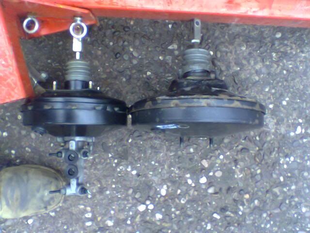

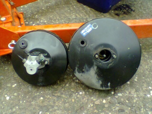

can anyone confirm whether or not there is a clio servo with a double diafram which helps given its small size? ive read it somewhere but they didnt go into detail.
Mon Mar 01, 2010 7:00 pm
They are all the same mat, ive had them from the 2 litre engined things and they are no different.
Mon Mar 01, 2010 7:01 pm
They are all the same mat, ive had them from the 2 litre engined things and they are no different, even the diesel donks have the same servo

When I was looking for a clio servo I found there were 2 different ones.
Mon Mar 01, 2010 7:49 pm
Yes, Mk1 and Mk2

would there be no real benefit to a swap from golf mk2 to clio then? thats what i really wanted to know.
Mon Mar 01, 2010 8:31 pm
Eko thinks so, he has used both and rates the clio, I have a golf on mine atm and it will be getting changed to a clio as it doesnt work very well. Ive fitted these to E30's before with no other brake mods and its made them a lot better than standard

So the MK2 clio servo gives more clearance/space, improves the effectiveness and the feel of the brakes (which in my opinion feel pretty crap as standard), and all for around £20 and half hour at the breakers.
Seems well worth it to me. :D
