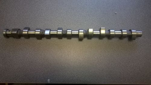

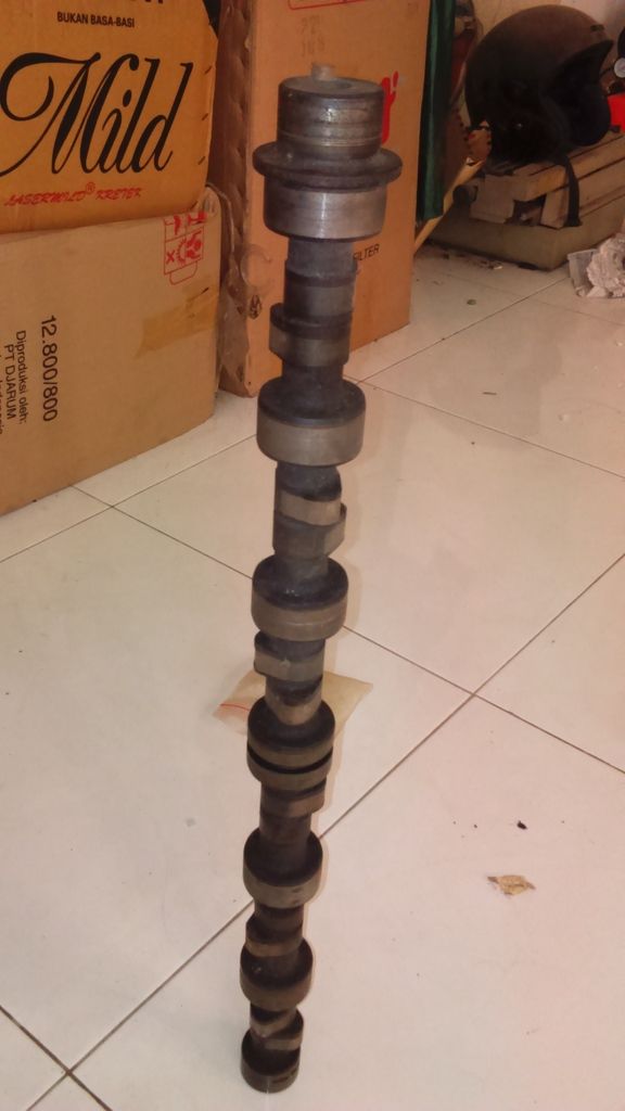

I just buy camshaft but ebay seller make some info that make me confused. The parts is still in the delivery process but i feel i have bought wrong camshaft.
he sent me ruville 215023 that he said same with bmw 11311706655 and he give me picture A that is not same with my original camshaft, i have also check ruville website and i found that it is same A picture.
And picture B is my original camshaft.
A
B
