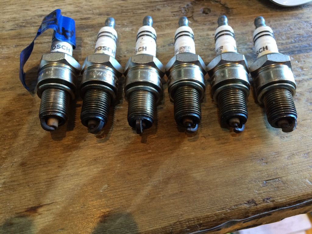

I did some research on the plugs that were used. They were Bosch Super Plus WR7DC. The gaps were 0.029 to 0.031”a These are ok for a well tuned car but maybe not perfect for a 400 odd hp car with a supercharger.
I put in some NGK BPR8ES plugs gapped to 0.025”a

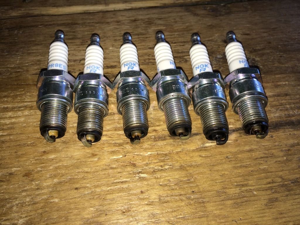

I checked the spark plugs to find number 5 to be much darker than the rest. I decided to get another set of new plugs, re gapped them then put all the bits back together, put a new coolant sensor in (to match the gauges) bled properly etc and got it running. All seemed good.

I checked cylinder number 5 and it was dark again.

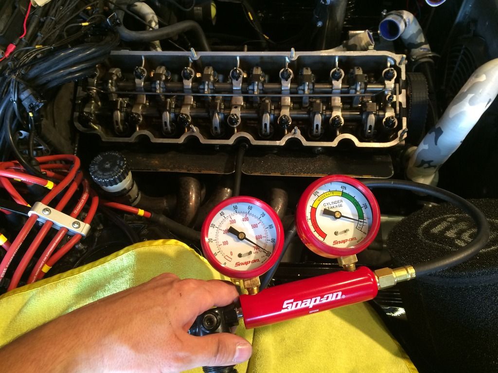

I also carried out a leak down test and found there was 20% more blow by on cylinder 4, 15% cylinder 5 and 10% cylinder 6. All the others where spot on. The air seemed to be passing the rings rather than the valves etc but I’m not an expert. However this was all enough for me to justify pulling the head which I did.

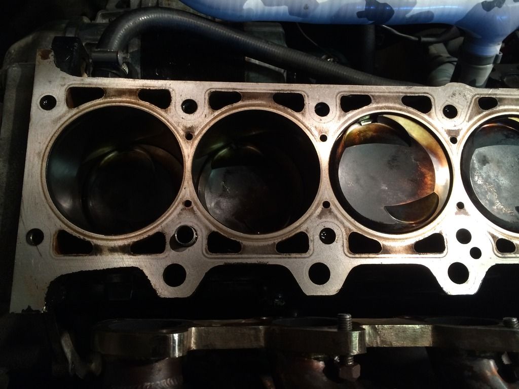

Good pistons leak down reading:

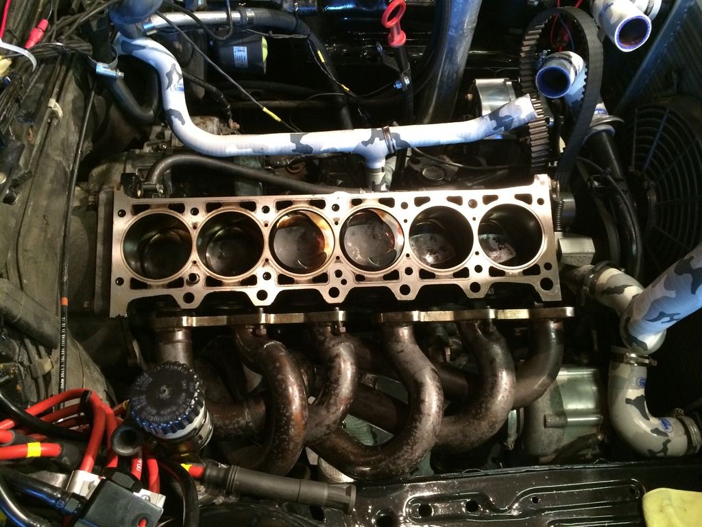

This is what I found:

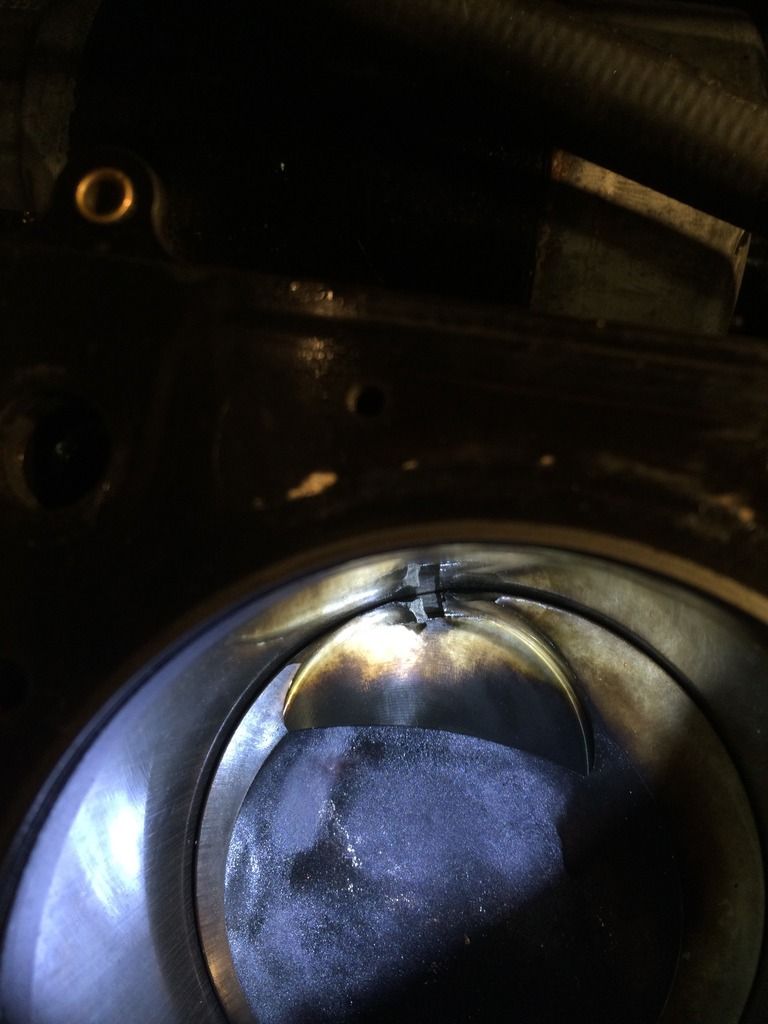

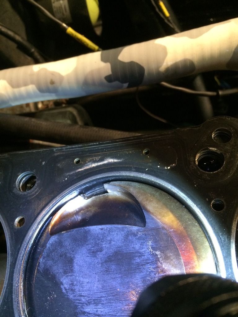

Piston no.6
Piston no.5
Piston no.4
There are chunks missing from the 3 pistons nearest the bulkhead. One of the chunks looks as though it has been pulled up which shows it happened on down stroke or from the piston ring moving up or ??
I’ve noticed there really isn’t much meat on the bone between the ring and the cut out for the valve. A design flaw?
The bores on the 3 good pistons look like they have never been used. The bores on the damaged pistons look as shown in the pictures - there are visible vertical markings although I can’t physically feel them.

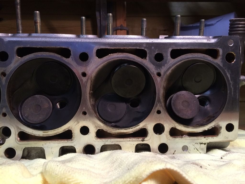

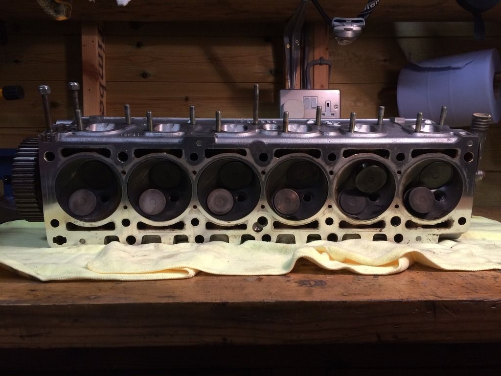

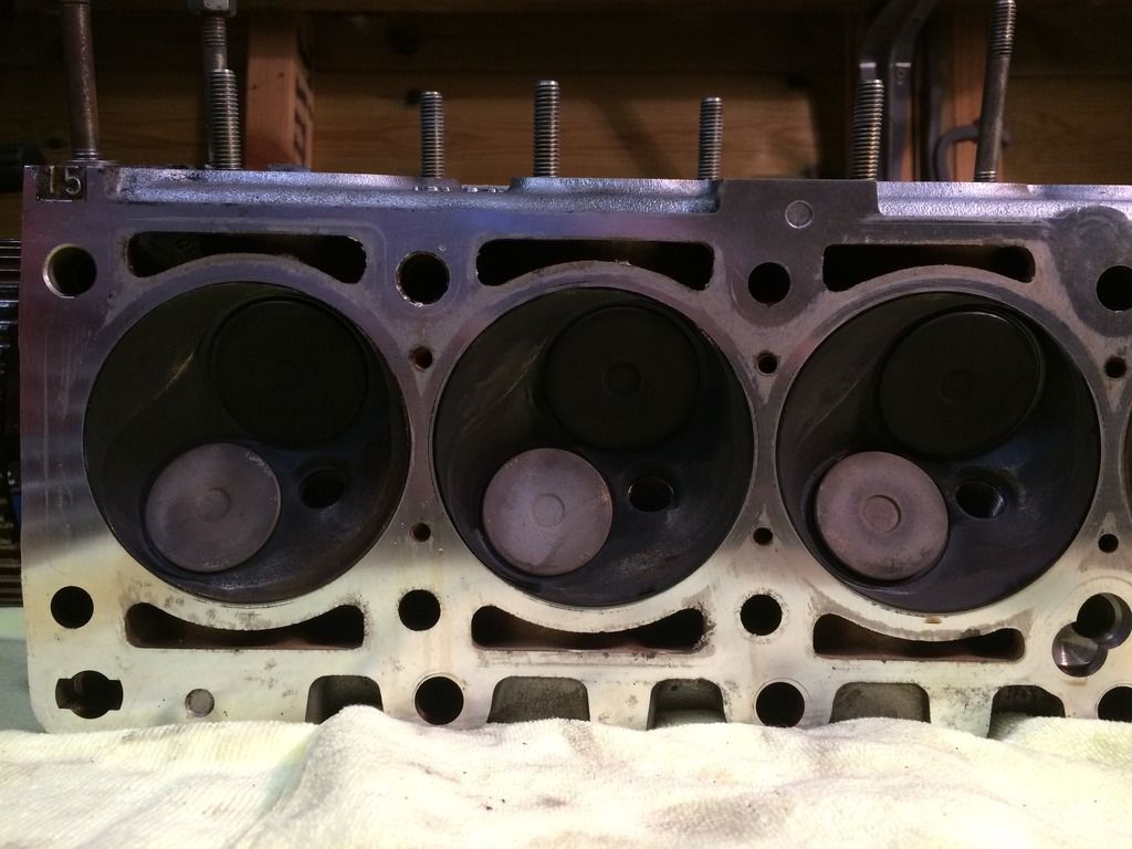

There are no marks on the valves from hitting the pistons:
I’ve managed to put a very small scratch on the head between a dowel and the cylinder position so I may need to get this sorted but apart from that the head, to me, looks fine. Clearly given the circumstances, it will have to be checked properly.
Should forged pistons do this?
What on earth has happened here?

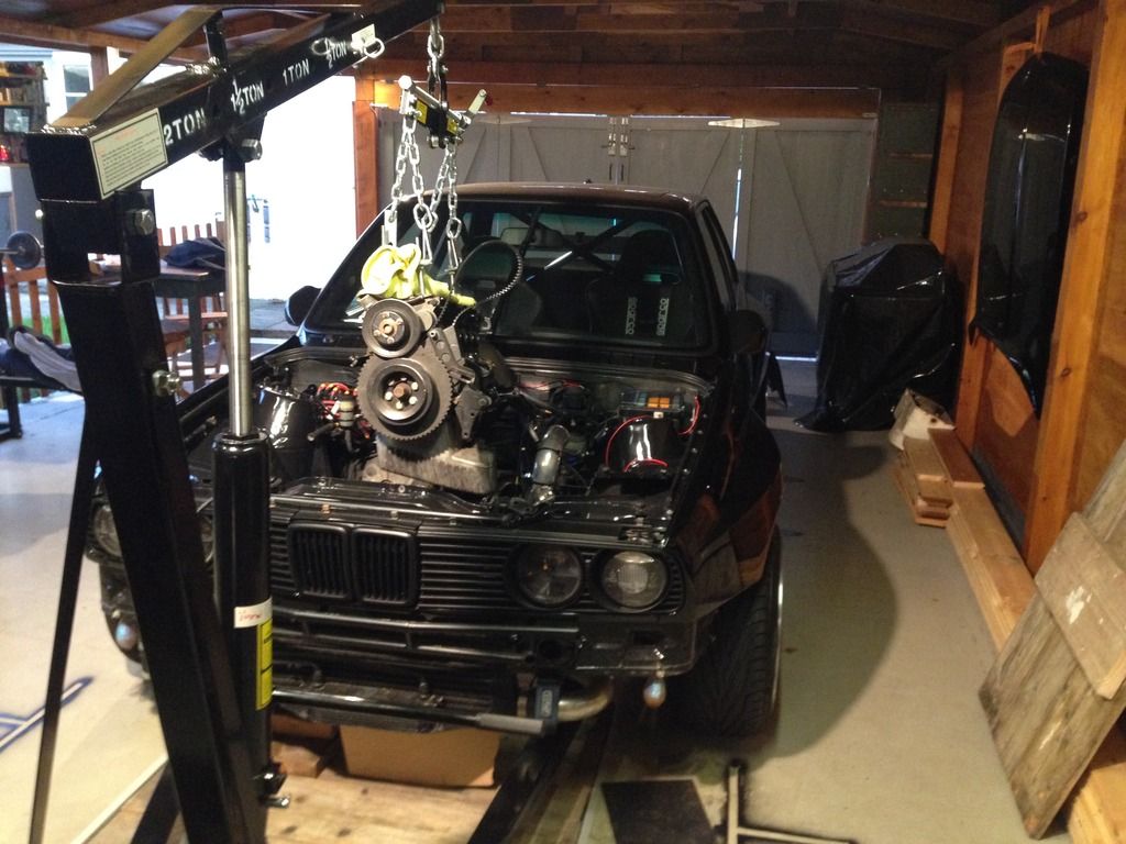

I guess I need to do the following:
Take out the block (I assume honing is needed and replacing pistons may be tricky with he block still in the car)
Have it re-honed if its ok enough for that
Get some new pistons and rings of a better quality and get them installed - which pistons?
Plop the extra baffle I have ready into the sump whilst I’m at it
Get the head checked over, pray it doesn’t need machining so the compression ratio stays the same to avoid loads of extra tuning and make sure it has strong springs.
Order up new gaskets and seals - MLS gasket again? Maybe from another source, preferably one with some sealant for a sure fit?
Either get the person checking the head and block to put them together with my ARP bolts and I will drop the engine in and finish off or do it myself
Sort out the crankcase evacuation
Install oil cooler
Put new oil and filter in
Flush coolant passage ways and use nice antifreeze -maybe a drop of water wetter.
Get an accurate coolant gauge and re-position the sensor”¦
Have it all checked over by a reputable tuner ready for me to drive on track.
Another option is do it all myself but I work 70-80 hours a week so learning how to do a head and hone/build a block may be out of the question right now?
