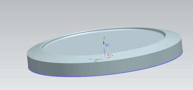

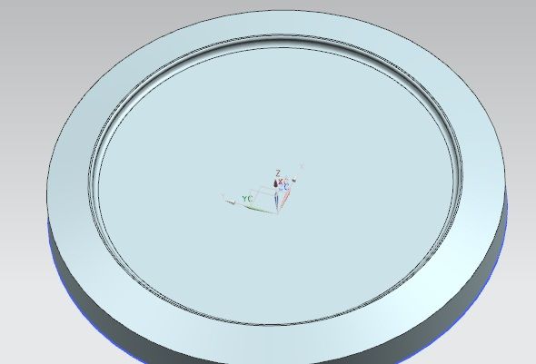

I know there is ~8.5mm on the top of a m52 piston leaving about 2mm to play with, infact a piston top like below has been toyed with.
Intended to be used with a slightly opened up alpina style chamber (drops squish from 15% to 11% but needs must etc) and the squish band angled to suit the head and other side of the chamber.
Bowl would take out about 1.5-2mm to give around 11:1 and 6.5mm crown thickness which I am reliably informed is fine around this size bore and with good quality stock pistons.
A hard ano coat or a thermal barrier coat would actually be more significant than keeping those 2mm of thickness.
Other beauty of that shape is the valves pass into the bowl, meaning absolutely minimal valve recesses.
