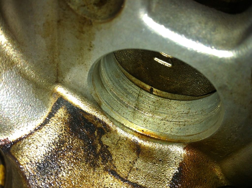

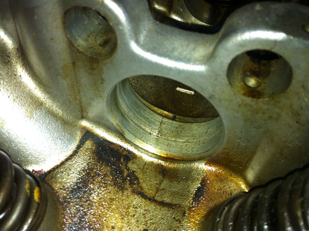

Ok the head ony 325 engine is scored where the cam sits can this be fixed ?

You might be able to find someone to bore it out and fit a bush or even metal spray it but it won't be cheap. It looks like it's cracked across the width though. Could be just the photo but if it's cracked it's probably scrap. An expert will probably be along shortly to correct me.
