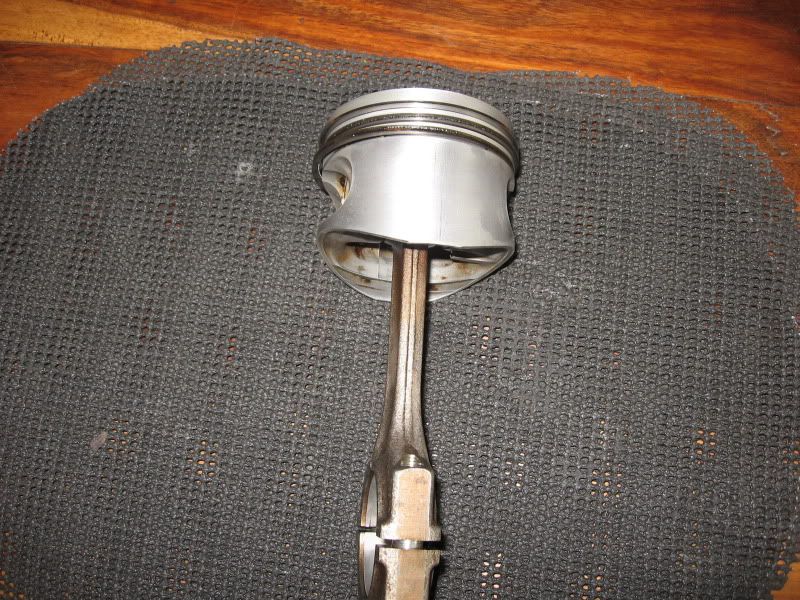

Late pistons with 9mm machined off the skirts

Did you machine the late Piston skirts as a weight saver, as i was under the impression
later pistons would not need any machining :?:
My early ones fit fine. :D

Had to machine the pistons to get them to fit, 9mm all the way round, quite a lot i thought, but it was the only way to clear the crank webs. Perhaps my car had a replacement high comp engine in it? No idea how to tell? I did read somewhere that there are different types of later pistons and that some need machining. One thing I remember though, is even at 9mm skim I had to ever so slightly notch the skirts to allow for web clearance, approx 1mm.
