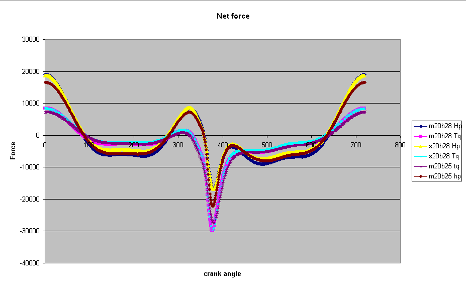

if someone can give me the weight of the eta piston and gudgeon pin then i can bung it into the spread sheet iv formatted to calculate the reciprocating forces. (god bless formatted spread sheets.
, does allow quick easy number crunching though)

the facelift pistons i have here have been weighed in at 540g with pin and rings.
heres the force caused by the reciprocating mass, the rotating mass and the combustion on the shaft of the conrods for a normal b25 a 320 rodded b28 and the one im working on.
hp=6000 rpm
tq=4000 rpm
hp=6000 rpm
tq=4000 rpm
