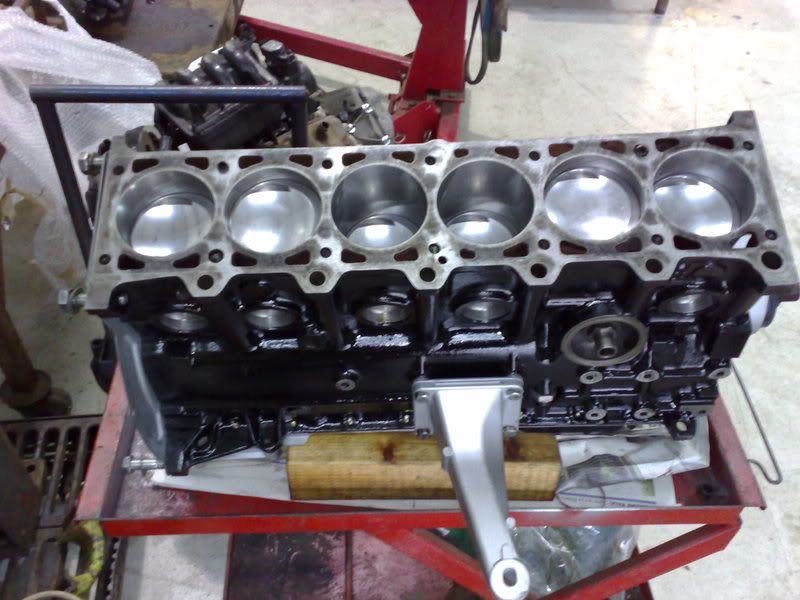

As from previous posts we know i embarked on a 2.8 build last year with the following spec:
M20 2 ltr block bored to 84.0mm
Single vanos M50B28 crank (thanks march109)
M20 2 ltr conrods
M20 2.5 facelift (low comp) pistons (cheers theo)
Catcam 285/285 degree camshaft (thanks Ant)
885 headcasting
BBTB (Thanks Ian)
Hottuning 6 branch and scorpian system (yes its just as good)
2.8 Motronic chip (thanks Ant)

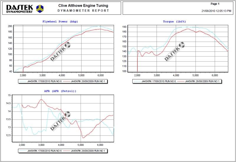

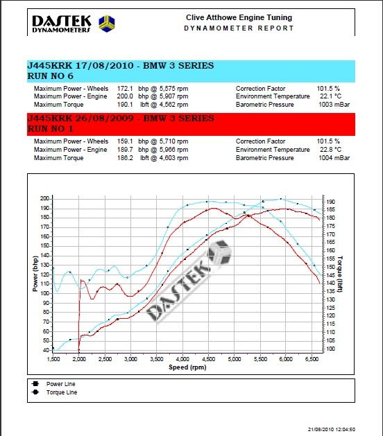

After assembly, fitting and running in i was very impressed with what i'll call the basic improvement over the 2.5, indeed, a few zoners who have driven this car were suitably impressed with the manner in wich it picked up around 3500rpm.
on or just after 5000 miles of very enjoyable driving i went onto Clive Atthowe's dastec rolling road in Norwich and put down the following:
A fairly respectable result which i was happy with but obviously i was looking for more.

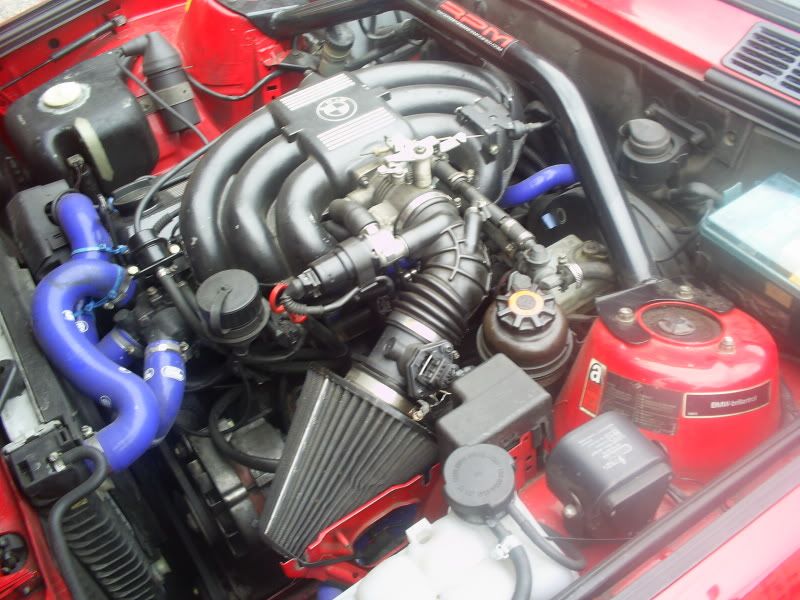

So a few weeks ago i gave the car to Ant for some development with a MAF and some techno-trickery.
First impression on getting back into the car from the turn of the key all the way to 3000rpm was 'fu*k me -theres torque...' as before power below this point, as you can see on the graph, was not abundent.
Also, part throttle with varying loads was very impressive, in fact i was using far less WOT for acceleration in favour of the new found torque. In short it became a plesantly complient 'grunty bastard'.
Initially the WOT maps proved to be a bit problematic but with a bit of trial and a bit more trial we had the first WOT pull to 6800rpm.
Compaired to before its savage even having dropped the diff ratio to 3.7 from 4.1, these is less of a 'coming on cam' sensation at 3500ish with the low end improvement.
The improved drivability of this conversion is but one bonus.
Installed with the MAF are larger injectors that dont have to work at max output, also that damn clicking is gone lol!
Whilst cruising the mpg swingometer is planted firmly toward the 50 point and for a 55 ltr tank 355 miles from full to reserve light is respectable, especially as i was pasting it everywhere with a massive grin on my face.
In short, very worthwhile conversion, the end RR dyno will be the proof but for far better economey, drivability, and power -the Motronic MAF conversion is real bang for buck.
In my opinion Ant has done all of us a serious favour in putting the R&D time into making this a viable alternative to 'other' products and that fu*king restrictive AFM.
Anyone building a stroker, or in fact any m20 owner wanting a bit more instead of settling for a AFM -call Ant
Many thanks from me dude,
Its definatly not 'Miller-time'
Please feel free to comment/discuss,
Brgds :D

1stly the MAF is soo much bigger the M30 injectors were a must have( thanks to Haken for pointing out the soloution when I was blindsided lol ! ) as the engine with no load would not pull past the 3k mark without going 19:1 lean and the code was maxed to 100% (255) on the part throttle map !
hurdle hurdled, we move onwards...
obv the yellows flow too much fuel in some areas even with the MAF so theses areas were mapped using the road, Chris's foot and my trusty wb02, live with an emulator, process was repeated for the high load maps to achieve the desired stock ( as measured with afm fitted, so the target for the exercise if you like )
come the full throttle stuff an issue arises, @ 5K |WOT resulted in 10:1 or richer AFR, obv no good so the WOT maps were located and logged to see what was what and where.......
end soloution was a simple find, having failed to witness the ECU use any of the known WOT maps I plotted a workaround, out the WOT and make those maps part of the high load MAF driven maps ( following me here ? ) we had the resolotion on the maf output to run to max rpm and load so the theory was sound.
then it hit me....... the bloody WOT switch was fubarred !, quick swap out and off we go, Wot maps in use and we tweak to again the stock AFR logged on the stock AFM, good pull up top and stable afr everywhere under all loads/rpms.
time invested .... huuuuge TBH but its always annoyed me that the accepted way to MAF is piggyback a fully mappable system with another, easy and quick yes, but I like a hard life lol !
Chris had the need, i had the tools and no e30 of my own so the match was spot on, massive thanks to Goosie again for his trust in this above all else, risky ? disagree , if I broke it \i fixed it FOC :D Never gonna happen.
obv I've simplified a little in the hope of more peeps getting the idea of how we did this.
final remap to max hp and tq ( with biggest area under.. ) will come v soon.
Discuss :thumb:

This sounds very interesting.
So which MAF was used, the one from an M52B28?

First results are in from the dyno:
Did achive 203.5 bhp at best run but the final adjustments after quite a few runs left us with the above, from 1st dyno run the conversion has yeided a 16.5bhp increase at the wheels, and an excellent increased area under graph.
The driveability and economy are also sublime.
Again the car has been driven by impartial testers in current form and all were rightfully impressed,
Ant = Legend
Discuss! :D
