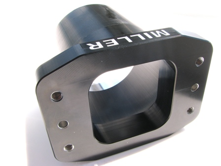

Cat flap cost me 6bhp, and all the installers i spoke to told me they rarely save the AFM anyway.
The only practical MAF with standard airbox is miller IMHO. Get to keep the trumpet inside the airbox too.
I had to give up on stock air filter with MAF AND BLOS, my new air filter will sit underneath the MAf with a large 80mm u-bend. I'm hoping to encase this to some extent inside the old air box, albeit cut largely to pieces. utilising the original cold air feed.
Tinley tech had mixers as described for me, very limited on designs though, I'd go miller MAF with a round od mixer. PS) ebay is very cheap for silicone hose adaptors which are normally availble in black, although I've had to go with red to keep all the same colour.

Stuart, tweaking the Miller for any AFM/MAF is difficult as they dont allow you access to that section of the maps iirc
the key maps are the 1x8 measured AFM lookup map and the 1x32 calculated % open (AFM flap) in the M1.3 code, these plus the IAT/CLT and TPS data + the RPM data and rate of change data( inc/dec or static throttle ) and the fuel maps themselves are where you may get issues.
increase the PWM on petrol to get more fuel, if emulating on LPG the PWM on the Gas inj will also increase, so would required closed looping for triming puproses or mapping to suit.
LPG/Petrol can be a pita to get both right especially on LPG that uses the pet inj PWM for its trigger , commonly referred to as injection emulator iirc.
I have skimmed a bit there and simplified but I hope ya get the gist.
you will need to map the petrol, then LPG and then possibly revist both to get some of the transient "right" then move onto the timing, beware though, chgange the metering device and ALL that mapping will need tweaking again.

e301988325i wrote:The link i posted on your MAF thread is stated to have very similar outputs to an M30 AFM, which is 50% bigger than an M20 AFM, the M30 AFM has an extra 50% of output over the M20 AFM giving very similar voltage outputs to each other at low flow rates.
Yes, I've been looking at that Alex. If I'm going to do it, I think that's the way I'll go. I might even be able to cope with that myself. 8O Thanks for that link, it could well be very useful to me. :thumb:
My current thinking goes like this.....
There doesn't seem to be anything to be gained from using a MAF that is a lot bigger than the diameter of the TB unless the main priority is for max power on petrol, which mine isn't. Am I wrong? If so, someone please correct me.
If I'm right, then I'm looking at a 70(ish)mm unit such as the M44B19 one Ant mentioned on the MAF thread, or the M50B20 one I was originally thinking about. Also by keeping it smallish, I shouldn't have to go beyond the 325i injectors I'm using, right??

StuBeeDoo wrote:
Ant wrote:Stuart, tweaking the Miller for any AFM/MAF is difficult as they dont allow you access to that section of the maps iirc.
So are you saying, then, that their MAF probably has identical outputs to the standard AFM? When you buy the chip they don't ask which you are using, so I assumed that you just mapped the chip to suit the rest of your set-up - AFM, MAF or possibly even Alpha-N.
FYI the miller MAF comes with a chip to match their MAF!

StuBeeDoo

e301988325i
Posts: 3701
Location: Taunton, Somerset
Post Fri Jan 21, 2011 8:45 pm
Ok, rephrase, the miller maf comes with a map for the WAR chip to closely match your engine/ although inherently that's probably available for free.

StuBeeDoo
Posts: 6756
Location: Up My Own Arse
Post Fri Jan 21, 2011 8:57 pm
e301988325i wrote:Ok, rephrase, the miller maf comes with a map for the WAR chip to closely match your engine/ although inherently that's probably available for free.

Post Sat Jan 22, 2011 9:59 am
Ie there won't be so much mapping to be done buying a known quantity of the Miller MAF.
