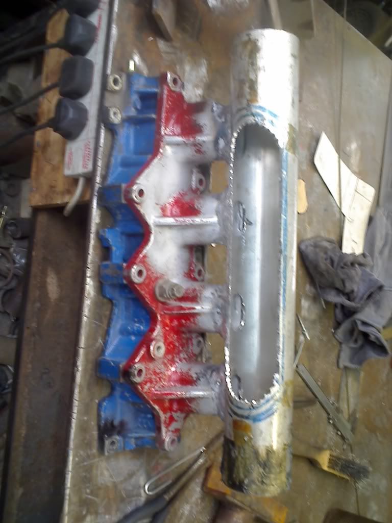

flow was done as industry standard 25 inch water. which is considered to be the average pressure difference across a port during engine operation.

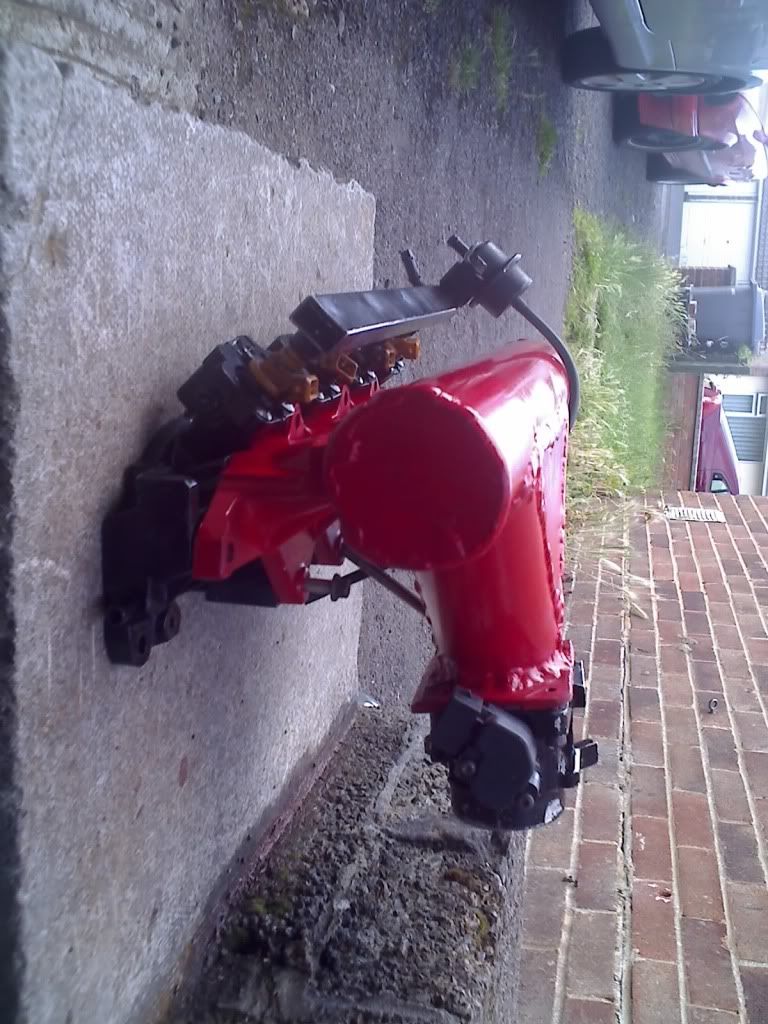

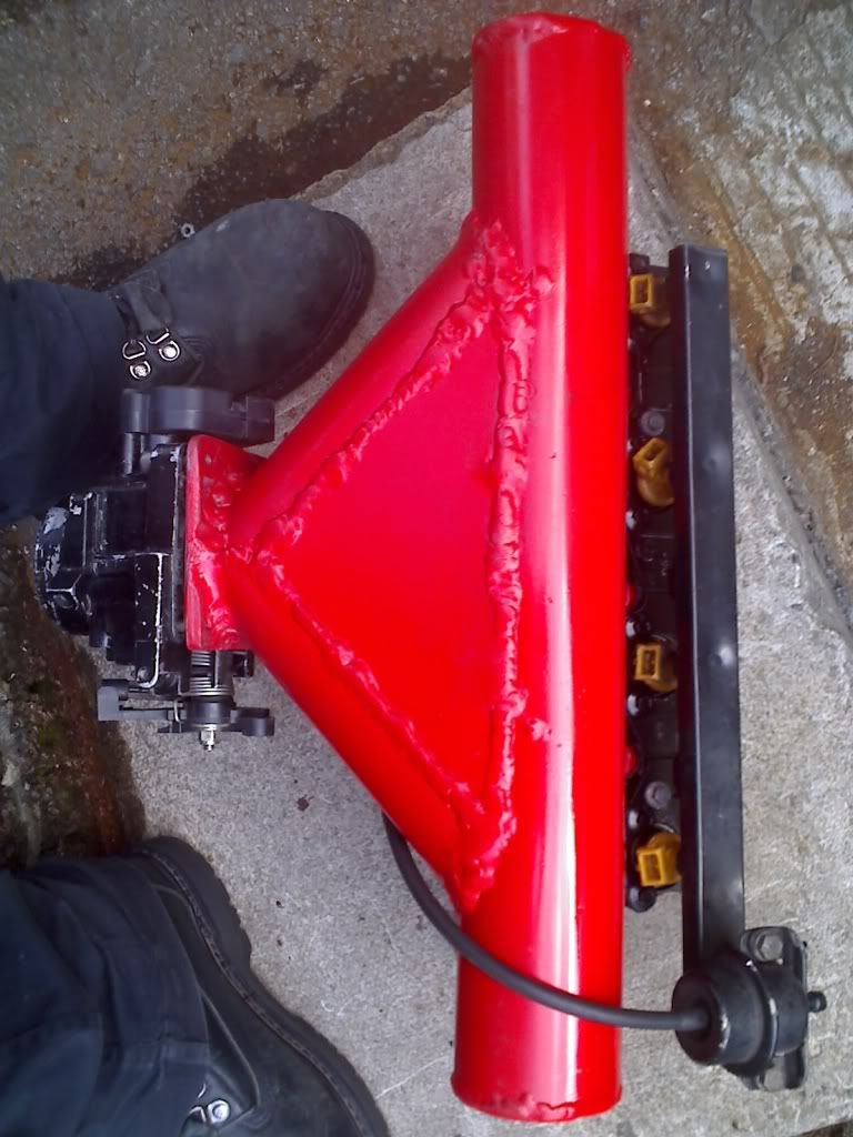

the manifold situation will be solved by yet another custom manifold. probably a tunnel ram manifold with a tuned plenum and single throttle on the end.
something like this but with longer runners. (this is for the zetec turbo)
A better flowing head will be able to create a stronger vacuum behind the manifold resulting in more airflow (higher pressure ratio across two points). The gains are minor as they will be unlinear.
your correct to a certain extent on that, although the average should remain at 25" water. and i expect things to get turbulent in the rough casting at higher air speeds. (note to self should have done a high pressure pull through it.)

If I might pick your brain again, would or could the manifold actually flow more if all 6 ports were drawing air. As the extra volume of air would activate the plenum (opposite to vaccum) chamber so to speak, a bit like coming on cam (when the valve overlap starts working) but the manifold coming on err manifold?

no, the plenum works as a helmholtz resonator, the flow is restricted by the geometry, diameter and surface finish of the runner.

i have been considering some form of variable length intake for the e30, i think something designed to work at 5500 rpm and a longer runner aimed at 3000 rpm could be a good combination.
iv been thinking log style plenum, with 6 direct straight as possible down draught long runners that curve down by the turret to the log, with some method of short circuiting between the plenum and the port.
obviously this will require some sort of trick, and may stuff up the porting, its all things ill have to make up as i go along, cause right now i just dont know how the intake will behave on the m20 6pot, its uncharted territory.
i think the first thing ill do is build a couple of wave models to determine the best lengths for cylinder filling at 2500-3000 and at 5000-6000, which are your normal road cruze and GLF revs,
those lengths and sizes should give me an idea as to what will be needed for the manifold, and thus if its feasible to build or not.
making the intake stacks longer or constricting the length of the runners is another way of doing it, but may be much more difficult to implement.
one of the troubles of this is i intend to put it on lpg at some point so what ever i make has to be backfire proof in some way shape or form, failing that it has to have the provision for near port gas injection.

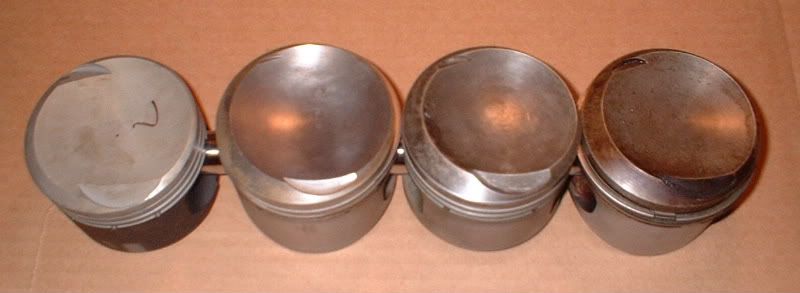

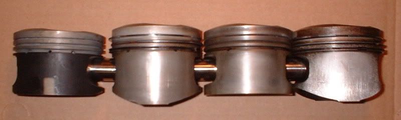

ok time to reliese some more of my research,
bit more discovered on the piston front.
i cant find any off the shelf pistons in 84mm that have a crown that is sutable or could be worked to suit the m20 head. its chamber shape and bore size is nearly unique, so all we are left with is either stock bmw pistons, modified bmw pistons or custom after markets.
having done a bit of combustion chamber research i can say that a flat top will be wank compared to a similar compression b25 shaped piston with correct squish clearance. as has already been hinted at in this thread and mentioned by ant previously.
in terms of aftermarket pistons it would appear that most are either a concentric bowl in piston type, a flat top or a gentle concentric dome.
all of which will fucking suck in an m20.
the chamber design of the m20 requires a eccentric bowl positioned over the spark plug, this keeps the combustion chamber as small as possible and centred around the point of ignition.
this design also keeps the fuel air mix as far as possible from the hot exhaust valve.
now basically bmw have done a brilliant job of designing the combustion chamber, its a really nice design with only two flaws, the compression sucks donkey balls and the squish band is a little slack.
now how good the combustion chamber is can be seen from the actually fairly low emissions for the age (remember if the engine came out in the 1977 it was designed in the early 70s or late 60s.) its tolerance of ignition advance, its tolerance of misfueling and there ability to take near 1.5bar boost on stock pistons etc.
as standard these things seem to run a large squish clearance, im not 100% why but i assume its a combination of running on the safe side (tight squish not really needed at 8.8:1), leaving a lot of room for the gasket to be compressed, leaving room for the head to be skimmed, and playing it safe on the stacked up production tolerances.
the result seems to be the stock squish band is bearly ok at 0.045" (1.71mm) and when the piston is 0.5mm further down the bore were well into the realms of harbouring end gas of the combustion chamber producing hot spots, and preventing combustion of areas, which just throws fuel down the exhaust increasing emissions and back fires.
the clearance between the piston and the head over the squish band becomes ~2.2mm
"chamber cavities ranging from 60 to 120 thou are most likely to cause detonation..." (1.524mm to 3.048mm)
what all of this has led me to conclude so far is a skimmed m20b25 piston will be by far the best solution, its allowed me to tighten the squish band up below the generally suggested 60 thou.
currently the new piston is running 1.07mm to 1.14mm from the head, which allowing for measuring error is probably a more even 1.1mm, which so far im told is enough clearance on a rod of this type and length and a piston of this type. (over the next few months we will be doing calculations and fea on rods that will allow me to say this for sure.) these were done by compressing clay and comparing the sections to gauges. so its not accurate as far as precision measurements go but its close enough for giggles.
the americans have found the small block chevy will clip its heads at 7000rpm when running only 0.024" (0.609mm) clearance to the head. considering they are dealing with a longer rod and a heavier piston then i think we should be fine at 1mm and arguably stronger rods.
HairyScreech
Posts: 6265
Post Thu Oct 07, 2010 1:12 am

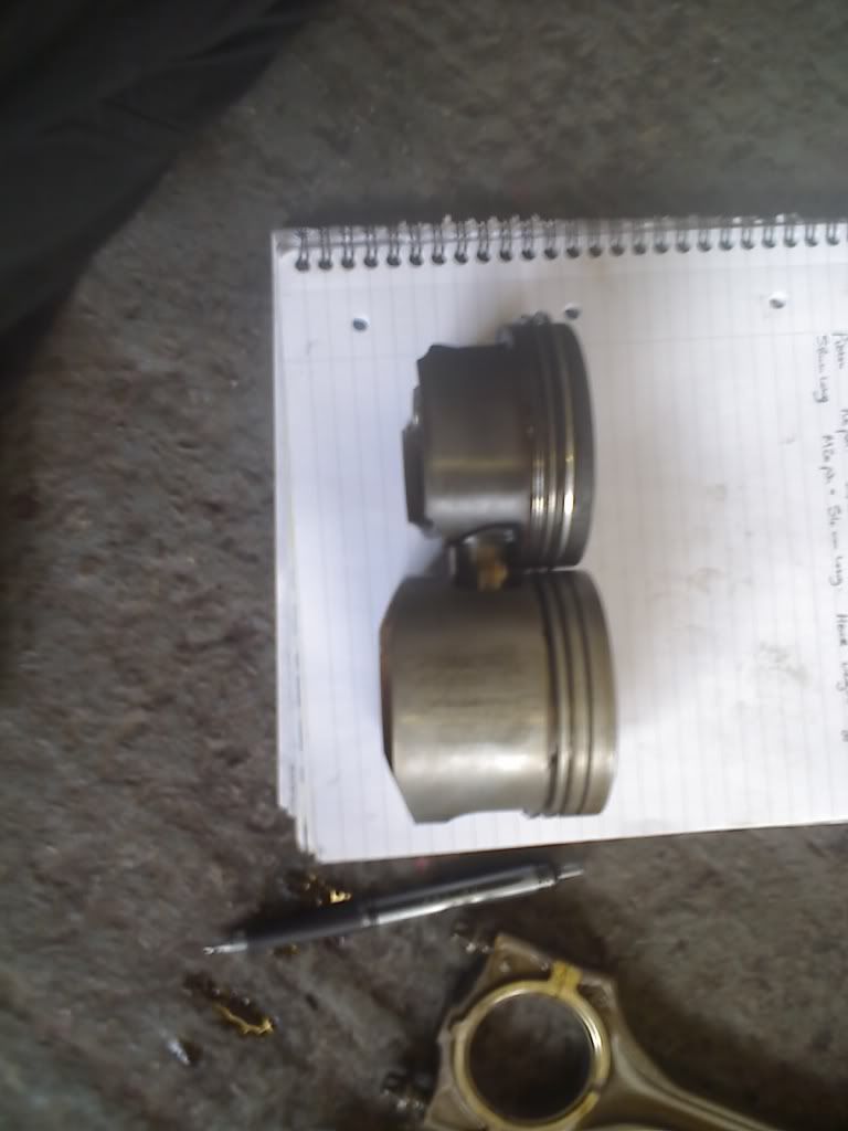

the next thing is by skimming the pistons will reduce the depth of the bowl, this will bump up the compression, atm with just a piston cut down and no pockets the compression is 12:1. to me this seems high, but ant has hinted in another thread that this has been run on an m20 just fine before.
his further input here would be appreciated, as although i have a lot of technical info and analysis hes the one with the real world empirical testing to draw on.
as said before the crowns are real thick and the top ring is a way down the piston, part of the reason they work fine under boost, plenty of meat and good thermal resistance.
iv measured the two angles of the piston dome and the head bowl, and the squish bands are a 23 degree angle for the piston and a 21 degree angle for the head, im not sure on why the variation, but i intend to find out,
for now i have just cut the pistons to 21 degrees to match the head, this has resulted in a squish band that almost exactly matches the head squish band. it almost feels like im taking it back to its original spec.
i still need to work out a good way to hold the pistons in order to cut the valve cut outs, which i have measured to be 4mm deep stock intake and 3mm deep stock exhaust. im thinking a jig of some form involving a tube and a hole for the piston pin, welded to a mount that puts it at the correct angle.
next thing i have been considering is the structural integrity of the piston. the centre of the piston is no thinner at its thinnest point, which is under the bowl near the centre, which will mean the middle will be no problem in use.
the ring lands are now 3.8mm from the top of the piston. from what i can gather this is more than what quite a few after market pistons have, and there are a hand full of stock pistons from other cars that are similar to this, namely the 70s aston martin engines and once again the small block chevy at 0.150" (3.81mm)
even still i have been considering using a thermal barrier coating on the piston to keep heat in the chamber and reduce the heat transferred to the piston.
i have so far been either considering a bake on coat or a hard anodize.
im swaying towards the hard anodizing for tow reasons, it hardens the surface of the material and holds lubricant, two thinks that the bake on coatings dont.
only trouble is the anodize layer is 0.0254mm to 0.1524mm and the piston to bore clearance on these motors is 0.02mm.
so just banging anno on is going to result in binding pistons.
next trouble is just boring the block a touch will open up the ring gaps, and to stay in spec only .50mm gap is allowable, which means a 0.095mm max bore increase before the rings get a bit gappy.
not sure on the solution to this yet but ill get there.

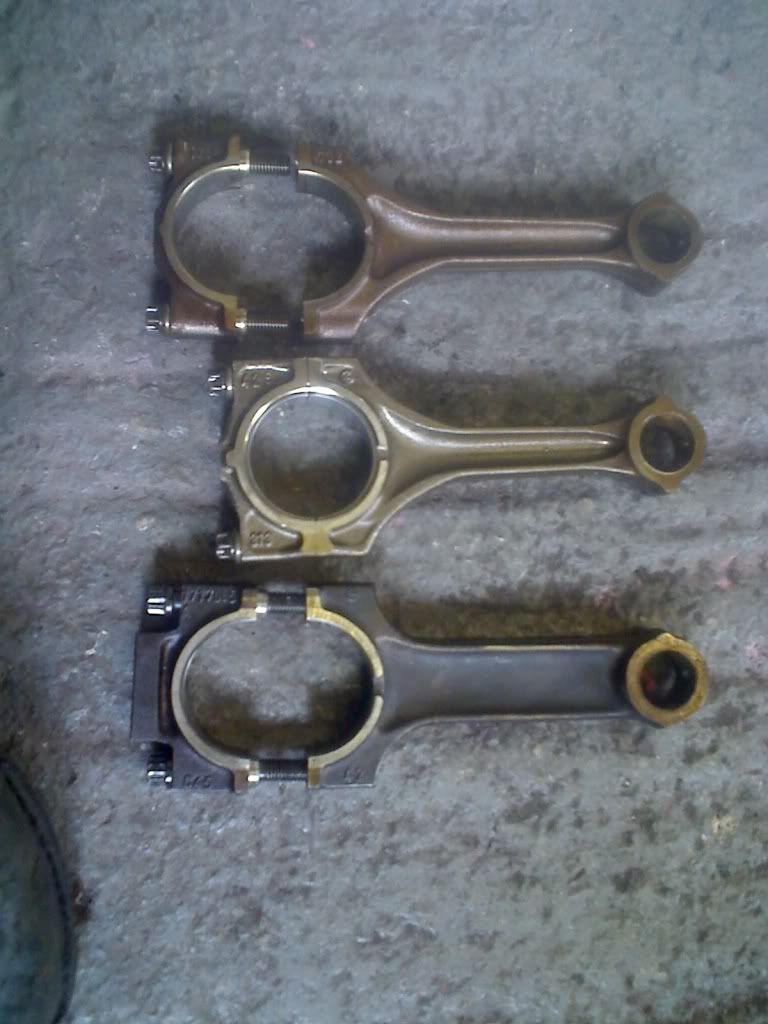

with all that said iv got some more weights and measures of components.

Piston weights
Stock 325 piston = 513g with pin = 407 no pin
Modified piston 1 full skirt 12:1 = 389g
Mod 12:1 short skirt = 380g
M52b28tu piston = 342g no pin (with rings) pin weighs 112g
Pin = 54mm long, m20 pin = 52mm long, hence weight change.
Skirt length from bottom of oil ring. = 35mm
M20b25 LC = 48.6mm
Shorty piston = 43.19mm
Slipper modifed m20b25 piston = 37+39mm skirt = 376g (no valve pockets)

and a few piston pictures for your delectation.
Key to piston pics
1 2 3 4
1 = alpina 10.2:1 for 135mm rod 81mm crank.
2 = us SETA piston (mahle)
3 = us wieght reduced skirt cropped 325I (mahle)
4 = us long skirt 325I piston (KS)
m20b25 euro bottom and my cut down piston top
m20b25 euro bottom and m52b28 top
now from this i can see that iv got the thinnest top ring land, with the alpina coming a very close second.
it would seem the b28 piston has a lower top ring than other pistons.
it would also seem the piston i have made from the m20b25 piston is not far off an alpina piston but with higher compression and shorter skirt.
guess we cant be far off something that works.
now just to be totally clear (or as clear as mud) the modified piston was shortened even more from that pic, to this
all thats changed is the skirt though.

a few things iv noticed about the rods.
bmw rods seem to be very close in weight, approximately 2g variation.
but they seem to be done as a whole assembly, and not big end little end.
in terms of polishing the beams the rods will be stronger for the removal of the stress risers around the flashing left by the forging. if this it done it must always be done up and down the beam never across the beam so as not to leave machining marks across the beam which are just as bad.
once this has been done the rods will need to be rebalanced.
internet rumor has it that the m52b28 rods are slightly heavier than the b25 rods but are significantly stronger.
this would hold true from the measured weight of the rods.
they also appear to be very similar to s50 rods.
compare:
not the middle rod in the top pic is a b28 one and the others are s50 rods.
seem very similar to me, mainly the beam shape, cap shape etc.
considering hom much m3 tech the rest of the e36 328 used is it possible they are just slightly longer prodictionised versions of the m3 rods?
or perhaps it means m3 rods are nothing special?
