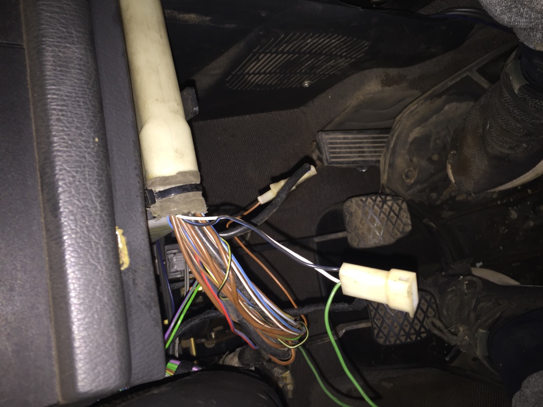

Hi guys is it a green wire in this loom up the column thanks

I don't want to start messing with the loom if it it's not the green wire in there I carnt imagine that would end well so could you let me know if it is that one thankyou

Any plain green wire would do, because they should all be ignition switched live, but the one I'm on about is part of a loom of only about six wires. The main wires will be plain red, plain green, plain purple and black or black/yellow, and it should go behind the steering column shroud, coming from the ignition switch.
I'm far more familiar with the post facelift E30 looms than the pre facelift ones, but AFAIK both are similar in this area.
