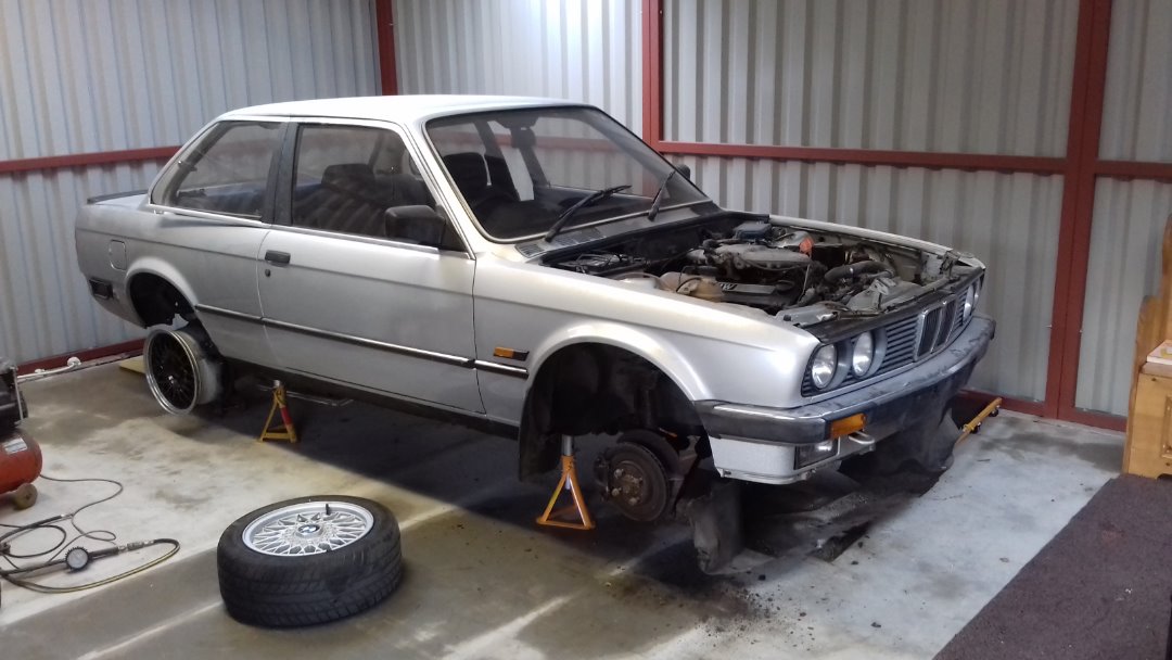

Car bought as a Project (1986 320i Auto) after selling previous cars ('85 320i & '90 318is) 10 years ago.
Previous owner stated it ran, but very badly - hasn't been on the road since 2011
As it was bought as a project, and it was a 3 door, 135k miles, very original, solid and the right price, I wasn't overly concerned about the engine.
I replaced oil, checked everything over, set value clearances and replaced a number of Vacuum pipes, fitted battery and it jumped to life on first turn of key.
Unfortunately it sounded like a diesel
I looked on web and this is exactly what it sounded like:
Convinced that the timing was out, I read up on timing belt replacement and after sourcing all required parts, took front of engine apart.
When I set the camshaft to the timing mark and removed lower cover, I noticed that the crankshaft timing mark was about 20mm away (anti-clockwise / behind) from the timing notch.
I had a look online and found this, which seemed pretty much exactly what my problem was:
https://www.r3vlimited.com/board/showth ... ming+marks
I made sure cam mark was spot on, removed belt and then turned crank slightly clockwise to line up with the notch.
I then put everting back together, battery charged, new fuel, crossed fingers, turned it over and now it wont fire at all.
I have checked for spark and its sparking well & plugs smell of fuel
Can anyone shed any light on what I have done wrong, or what I could try next?
