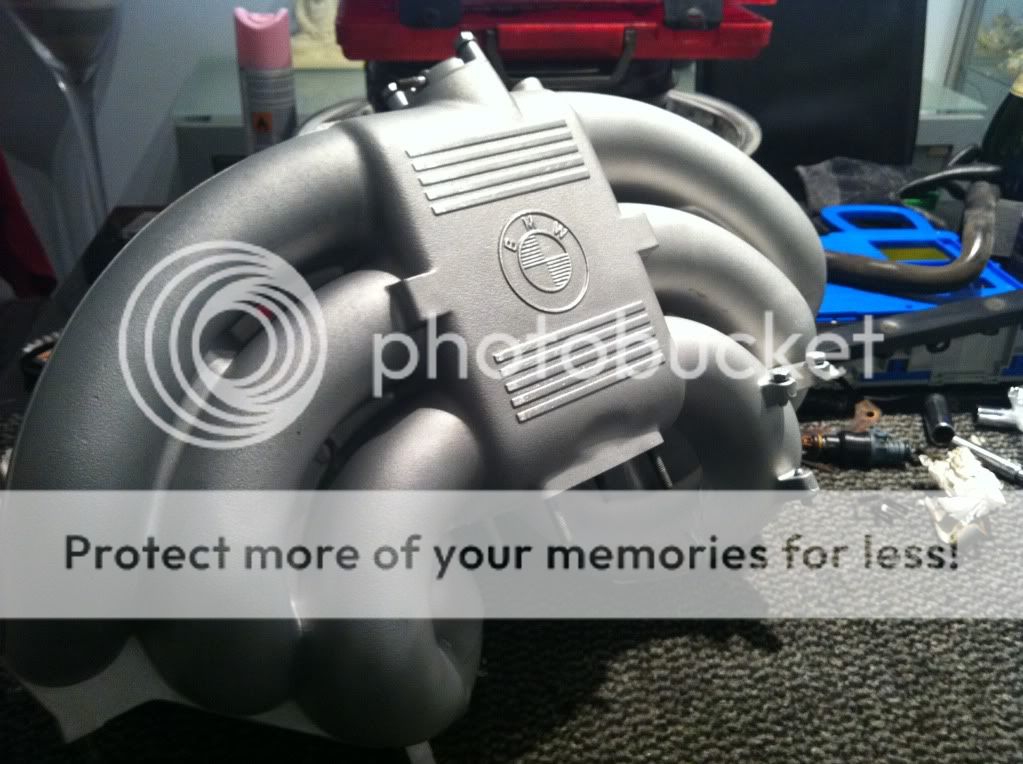

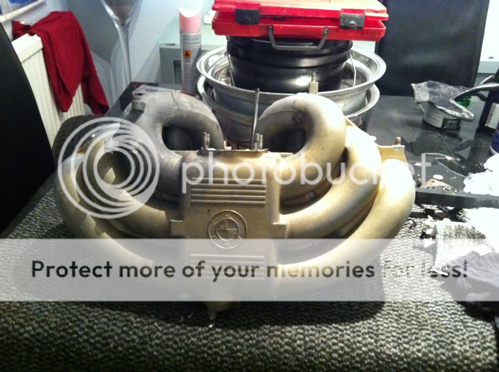

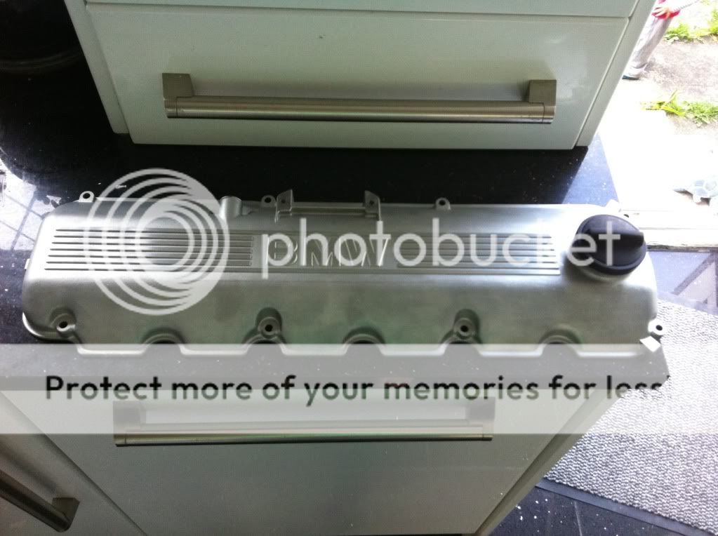

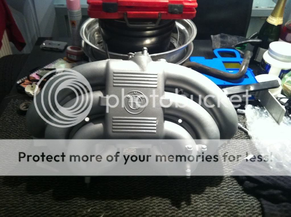

Like a nob I couldnt see the gaskets on the head - they look fine so they wont be getting changed. I thought id upload some pics of the rocker cover and inlet manifold I shot blasted.
Before
After

Sun Apr 03, 2011 11:54 am
they came out good :cool:
