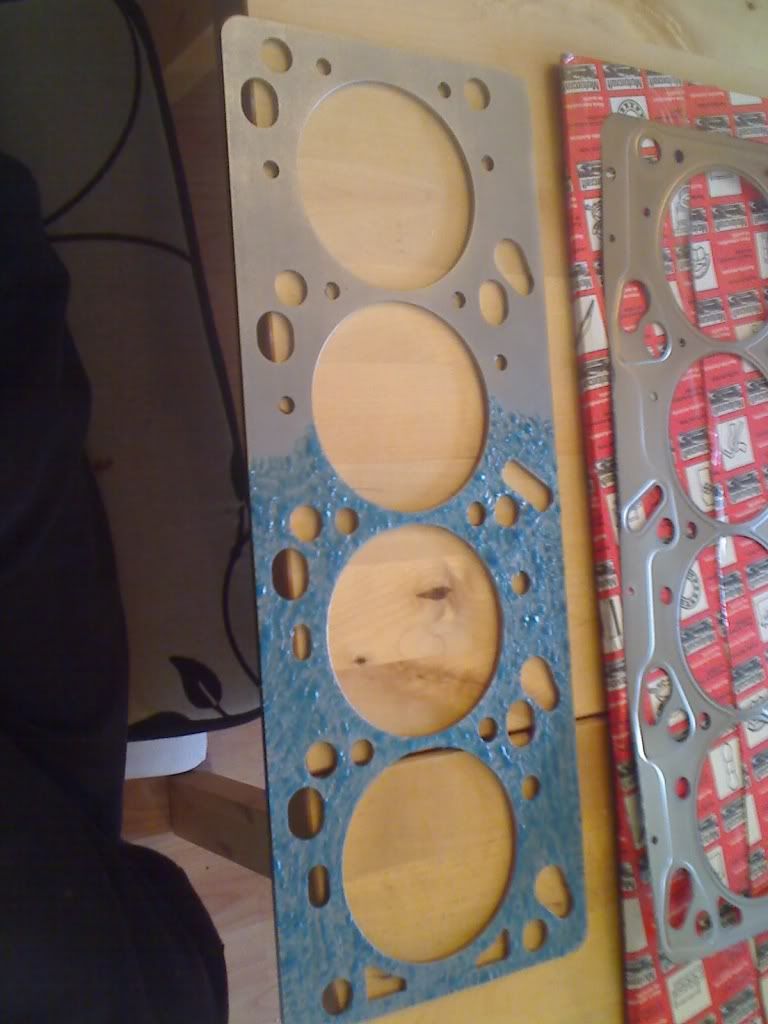

Decomp plate :D
Got a 3mm one here :D

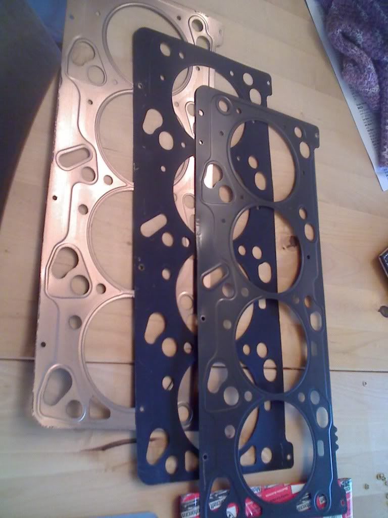

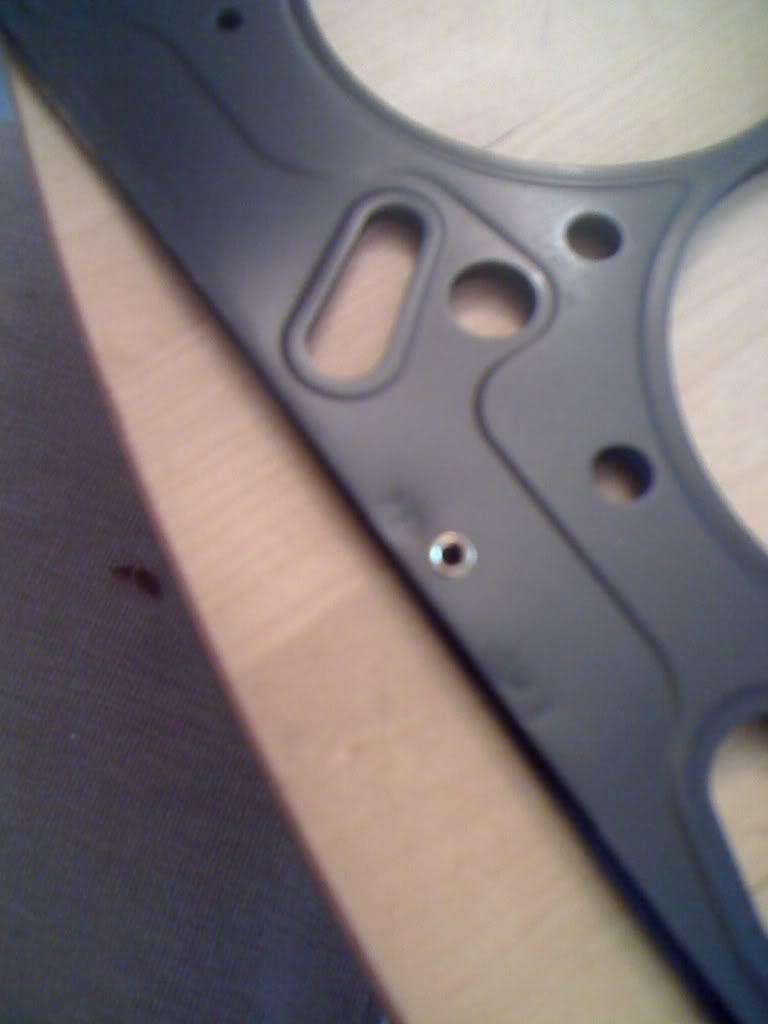

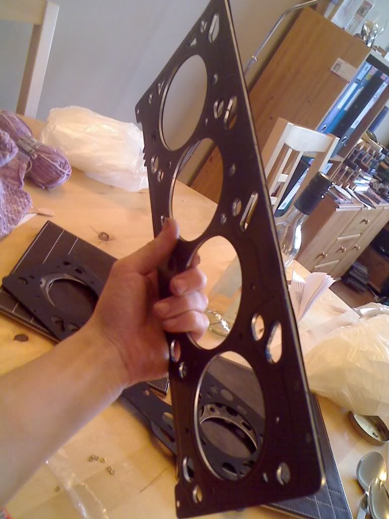

or split a 3 layer mls and put the decomp plate in the centre as the middle sheet.

BadDave
Posts: 6012
Sun Nov 21, 2010 9:02 pm
HairyScreech wrote:or split a 3 layer mls and put the decomp plate in the centre as the middle sheet.
My decomp plate came with them already attached,and with it being 3mm thick, it means you don't have to remove quite so much material from the piston crown :)

decomp plate or use low comp face lift pistons.
aand dave that ones ~3mm to drop a silvertop zetec to 8.1:1. been run up to 100 Deg water temp and held just fine, hasnt been tried in anger under boost yet but i see no reason for trouble.
