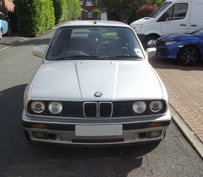

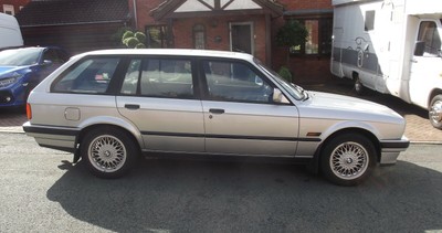

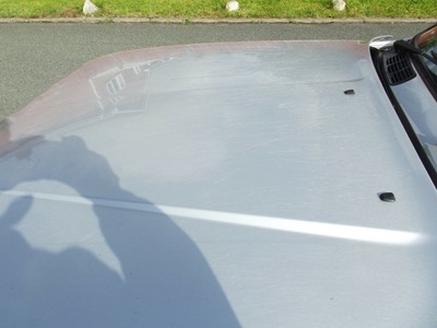

Haha well, a quick assessment of a couple of photos for me could be worth many thanks and an e-pint..?
There's some rust on the rear arches and the sills, is it safe to assume it'll be behind the arch liners and need a fair amount of work?

Firstly I'm no expert - however there are many on here that are and can offer better advice than me.
Difficult to form an opinion from these three pictures as there might be areas much worse lurking elsewhere ( or not if your lucky?)
For what it is worth this looks fairly typical of rear arches that will need a lot of work inside and out. The o/s looks worse and looks like it has had repairs/paint in this area before. Might be the light / reflection but the top edge of the arch looks a bit out of shape compared to other side. Not a problem if you are not paying too much and you can either live with it or be prepared to repair. Engine bay looks fairly original from this angle though it looks like a weld repair on the bonnet hinge ( or it could be grease? - hard to tell. Looks like a new(ish) insulation pad under the bonnet. Wheels don't look too bad.
Good luck - hope it is a good one for you.

The ad makes it look pretty nice and straight with a few issues including intermittent speedo, fuel gauge, rear washer, crazed bonnet lacquer.
