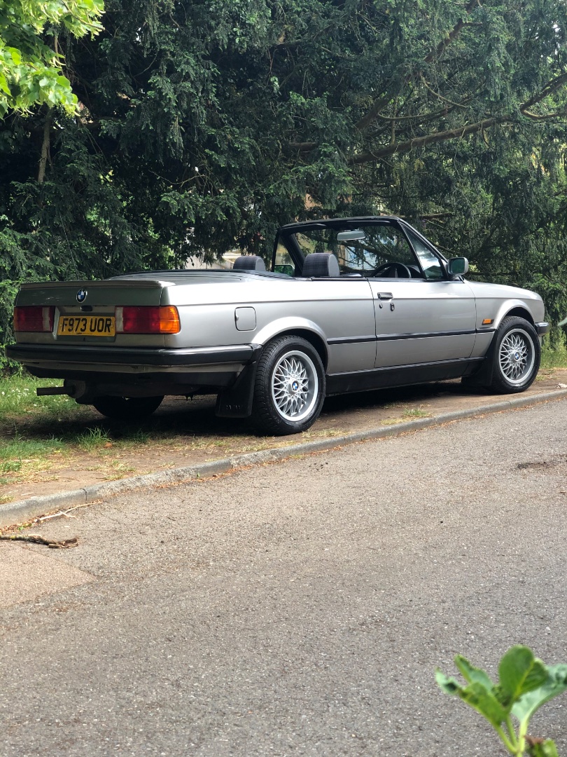

Hi everyone,
Nice to meet you all :)
Bought my E30 around 15 years ago when I was 18, which I converted to a 2.5 engine.
Has spent more time off the road than on it over the years but looking to get her back up and running.
Unfortunately I have an issue with it at the moment as it used to get stuck in reverse when I reversed out of my drive until I switched it off and took it out of gear until one day I decided not switch it off but force it, heard something click and now the gear stick is wobbly and the car is stuck in reverse :(
Any ideas on what I’ve done and if it can be repaired or needs to be replaced?
