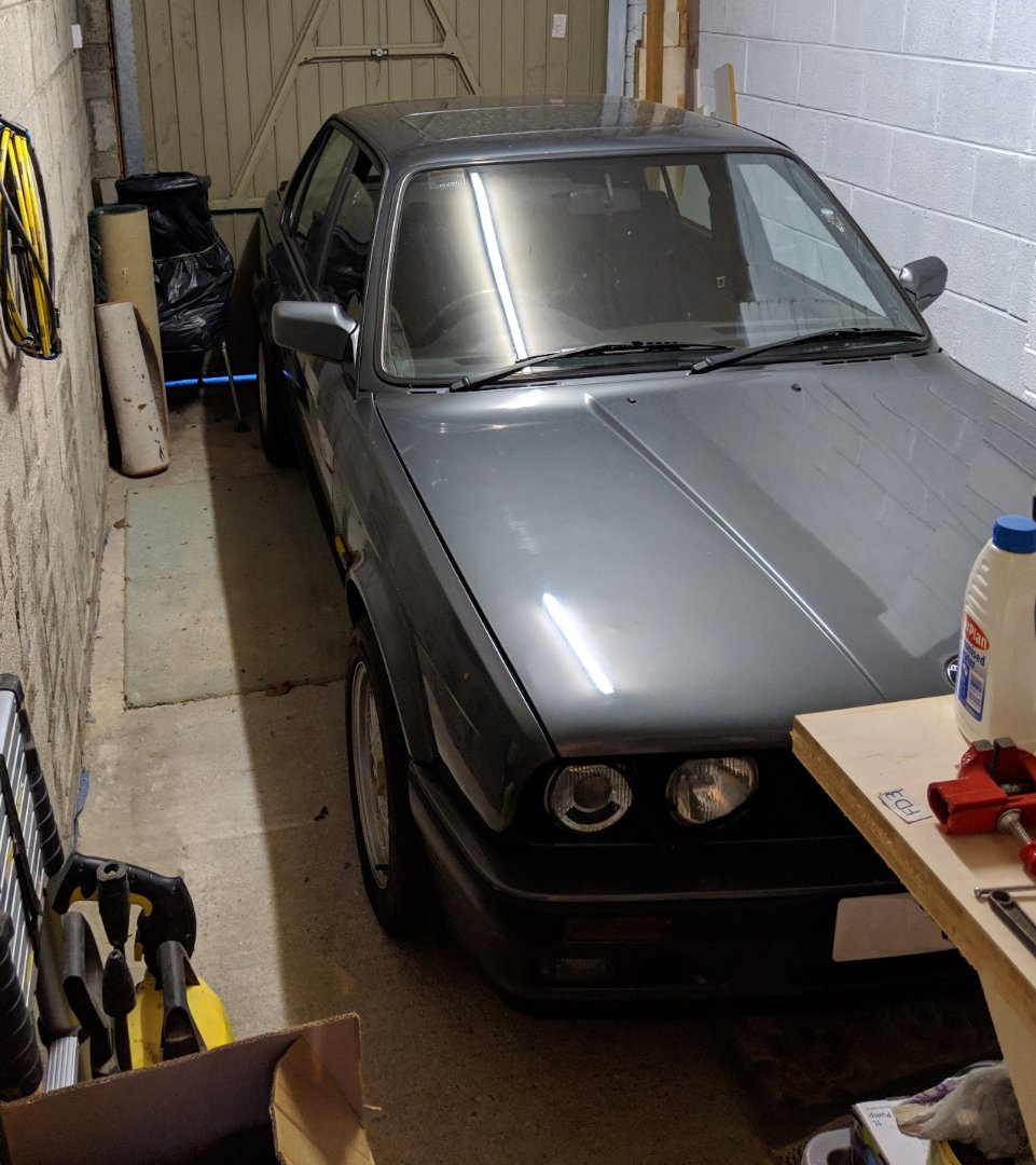

Thought it was time to say hi! I bought a 1989 325i a year ago and have been slowly "doing" bits here and there. More so now while the missus can't force us to go on walks or go shopping :D (seriously though hope everyone is keeping safe).
For some reason I only took one picture of the car whilst I was sheepishly driving it 100 miles back from where I bought it, as below and then in my garage. After that the only pictures have been of parts I'm taking apart to replace seals and remove rust from etc and the bonnets been off for months!
Things I noticed on the drive home were that the brakes were extra soft (since replaced the rusty hard lines and have bought braided flexi's) and there was a ticking noise that seemed to be coming from the dash getting faster as the revs increased. Otherwise seemed to run pretty well!

Thanks, I'm going to start up a build thread and catch it up to where I'm at with the car now if I can. More pics appearing there, I don't know why I didn't take any others of the outside of the car before I rammed it into the single garage and took the wheels off!
