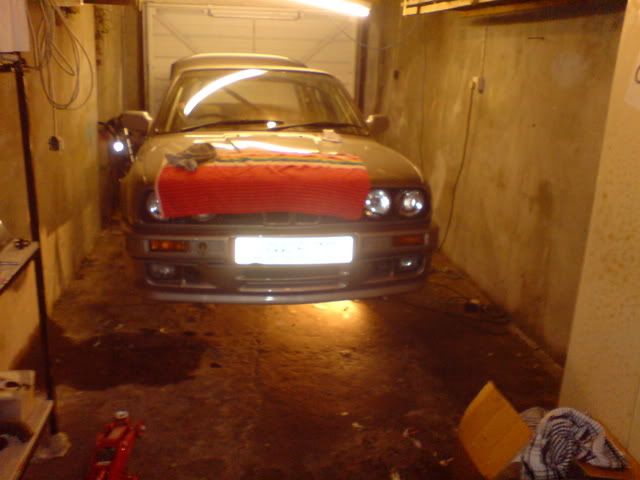

Well, i have been asking lots of questions so i thought i would show a few pics of my first rally car!
Its a £400 325i sport AUTO!! with 70k, don't worry, the auto box is on the list of things to change! :D

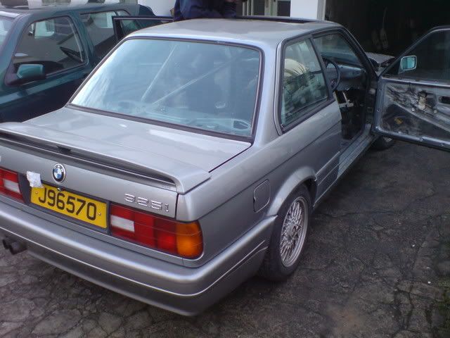

Anyway, here is the back of it :D

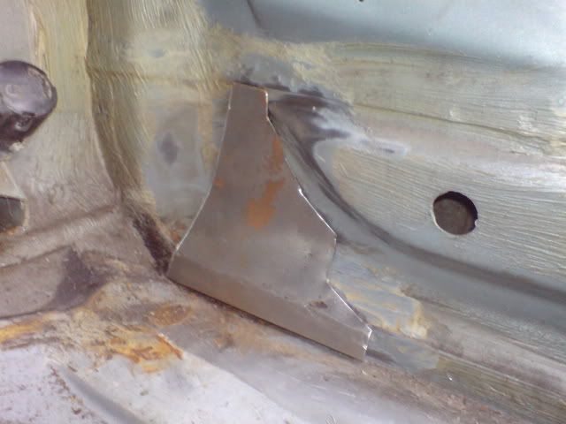

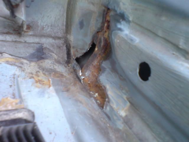

The first problem to sort was the big hole next the the throttle pedal :shock:
I cleaned it off and treated the rust then made a patch for it, i still need to weld it in though...

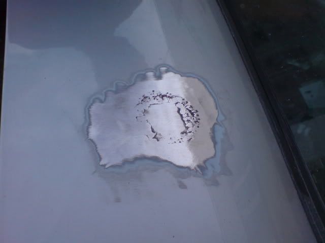

There was also a hole in the roof where someone had fit an areal, i cleaned this up and welded a patch in, be nice its the first patch i have ever done :oops:

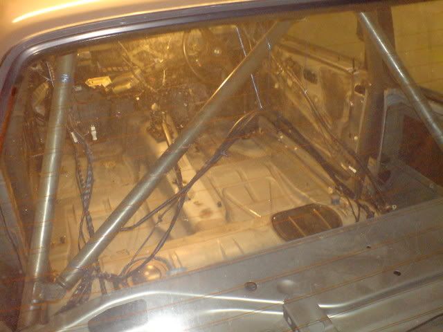

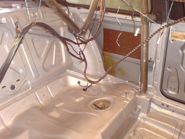

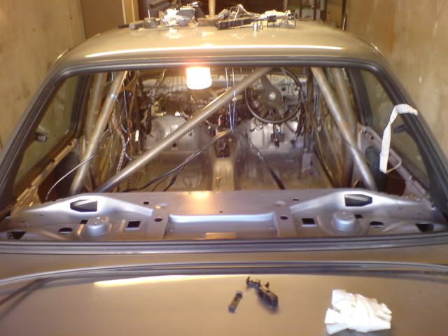

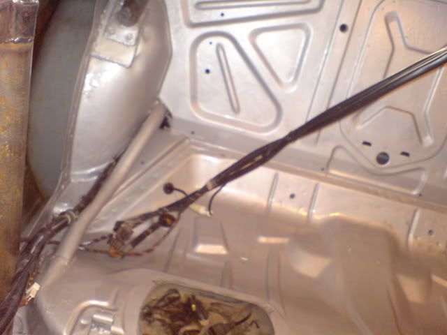

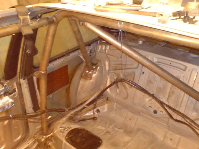

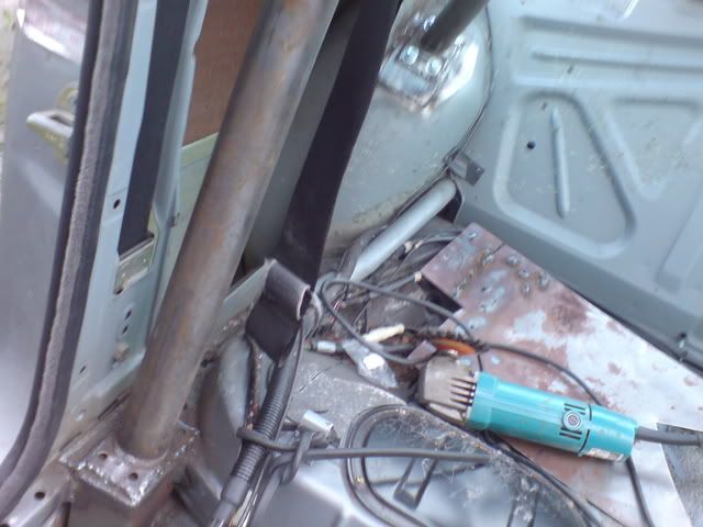

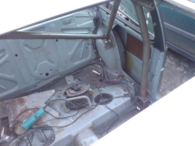

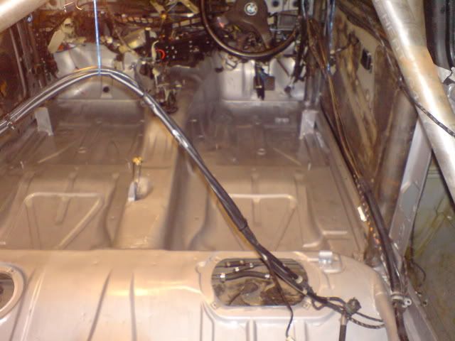

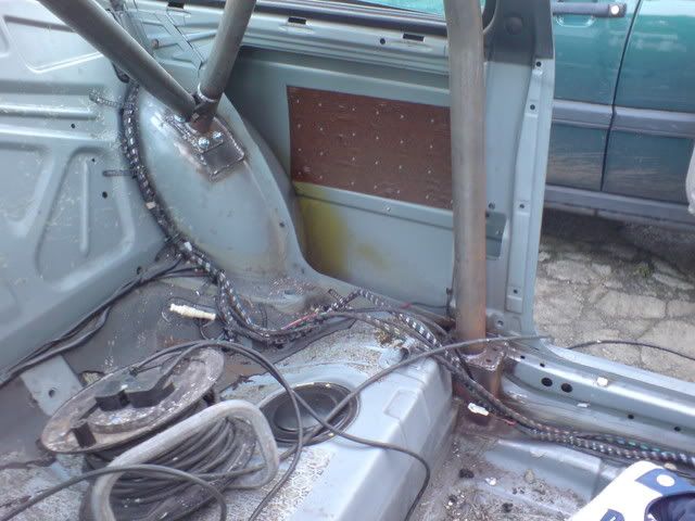

Next we welded in the back part of the mission that is an omp cage :shock:

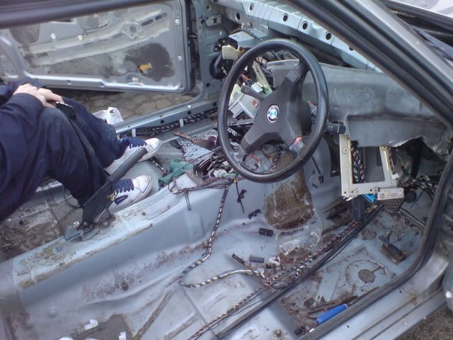

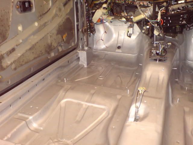

And the other job my co-driver has completed is removing the sound dedaning...
you don't think there is much of this untill you weigh it in a bag!
Thats it for now, this weekend we are gonna weld in the front of the cage and that patch!

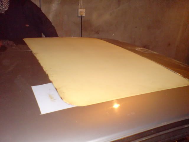

Thanks guys, ed no its not a glass sunroof :D i have just cut all of the old one out.....
The original is completely rotton so i think i will rivet a piece of aluminium on instead.....

Jay, its an OMP bolt in cage, the worst fitting cage i have ever seen, you have to do lots of fabrication to make pillers for the plates to sit on and mine was bent 8O but it was only £300 so i can't really complain!

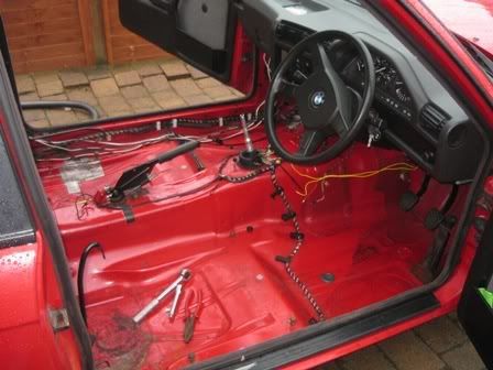

BTW - Just stripped the carpet out of my latest 2 door E30 325 and the passenger foot well is rusty too and a bit on the sills so work to do..
[img][img]http://i142.photobucket.com/albums/r117 ... G_0104.jpg[/img][/img]

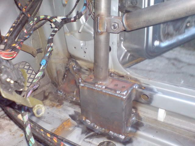

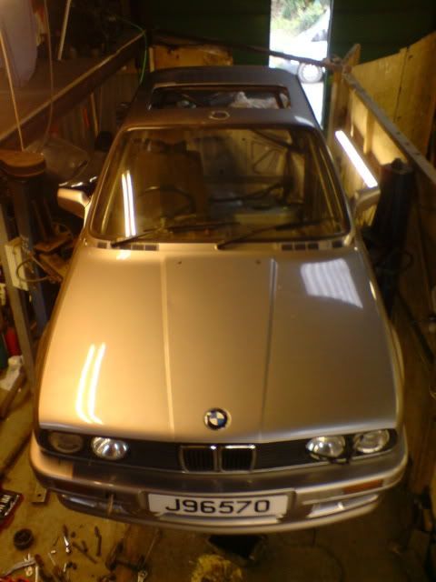

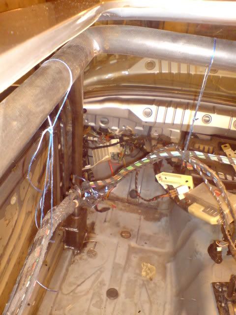

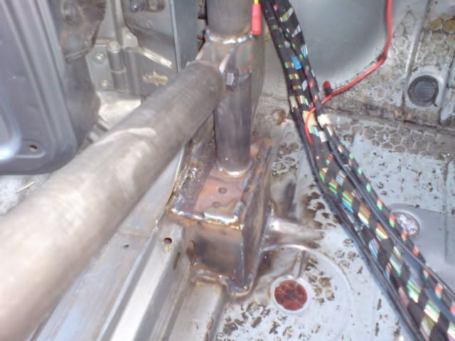

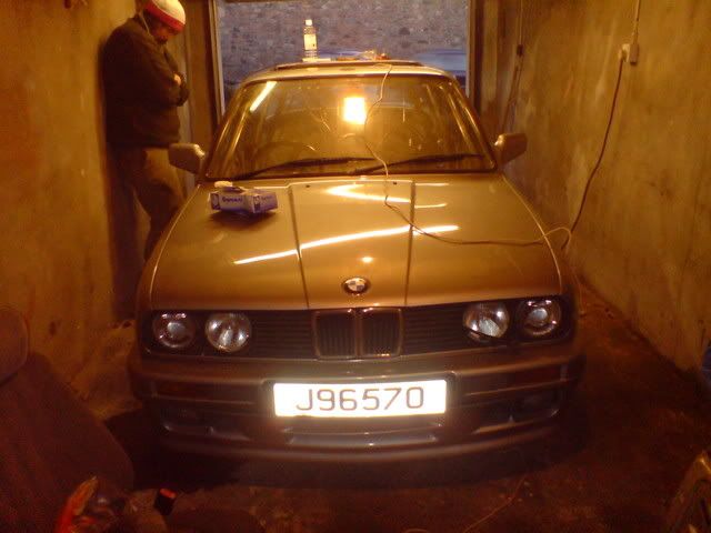

We did a little more over the weekend and the cage is now finished! :D :cool:
Here are a few pics of the front towers we built and welded in.....
Door bars are also weded in which was the best bit :D

how are you going to put the nuts on the other sides of the bolts?
maxfield
Posts: 15186
Location: Mansfield
Post Mon Feb 11, 2008 2:00 pm
mikekean wrote:how are you going to put the nuts on the other sides of the bolts?
The cage is now a weld in cage rather than bolt in, I think.
Awesome project anyway dude 8)
Trise30rally
Posts: 383
Joined: Thu Oct 18, 2007 11:00 pm
Location: Jersey
Post Mon Feb 11, 2008 2:24 pm
I have left the other end of those boxes open so i can get my fingers in for the bolts, the bolts are only there for show really as they are never going to be as strong as the welds......

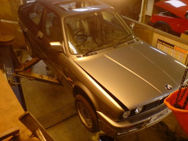

We started the Manual conversion on saturday but due to a seized spiggot bearing we had to stop :cry:
Parts ordered from euro car parts so hopefully it will be finished tommorrow night! :cool:
Whilst she's on the ramp we are also fitting some spax lowering springs, omp drilled and grooved disks, mintex pads, new front wishbones, new eccentric pollybushes and a solid diff mount bush, hopefully this will tighten the car up a treat! :D
This is her on the ramp....

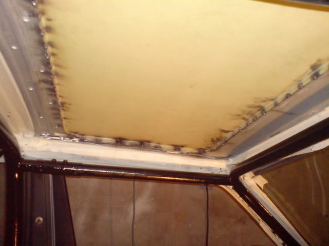

Well i have had a very busy weekend! The car has to be ready for easter monday as i have an entry for the local hill climb :D
I am not getting it to rally spec though, just modified production........

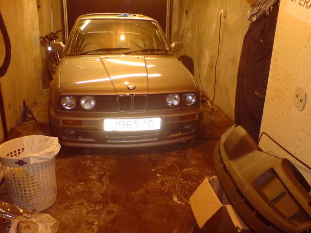

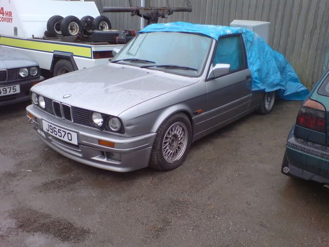

First i picked her up from my mate who has been doing the manual conversion, it is now manual with a z3 shifter which is lurverly! :D
This is her sitting outside the garage with a cover because it was raining and it had no sunroof!

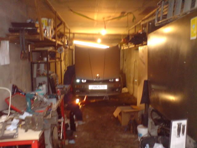

Next i drove her to my garage to test the manual box, yes, it does go sideways!!!! :twisted:

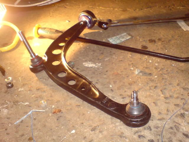

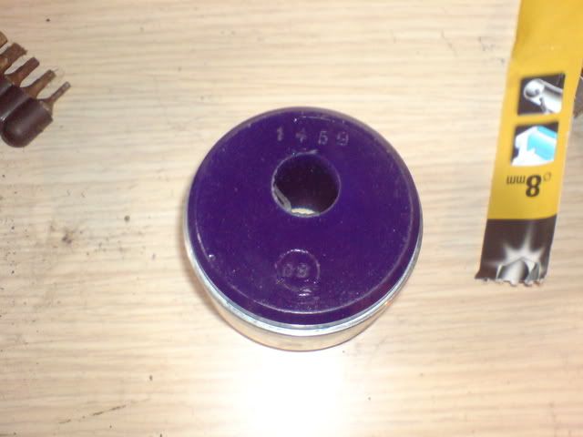

My list of jobs for the weekend was, paint the cage, fit new control arms and powerflex eccentric bushes, fit the new sunroof panel, put the back window back in and remove the leaky steering rack, just pack it with grease and go manual!
Here are a few pics :D
I was thinking about filling the sunroof before i painted it because it has a few flat spots, do you think the filler would crack when the body flexes??
Done!
