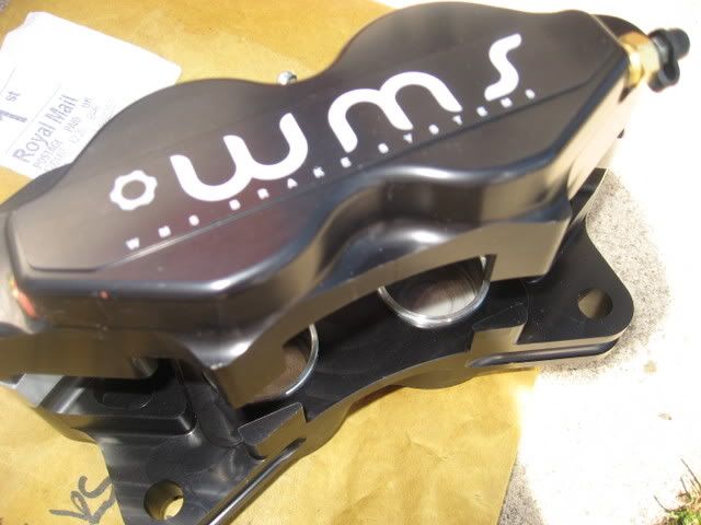

Try keri-wms mate, i fitted his 4 pots which made a massive difference. Pads rattle from time to time, but not an everyday car, so no hassel.....
