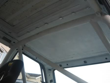

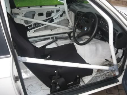

My OMP one is in a 2 door 88 325 - sunroof gone it went in easily (by two guys who knew what they were doing and i'm not included in that number.
Pics will follow when I get my camera back.
BTW - Fast Daves cage was made with scaffolding poles and a soldering iron

Here's some pics of the OMP 6 point bolt in cage, still work to do but it gives you the idea.
I use my 325 for track days, hill climbs, auto tests and soon (licence permitting) I'd like to start some of the tarmac rally stages.
Sunroof removed thanks to Fast Dave which saved 7kgs.

Went in no problems (thanks to two rally pals. I've removed the sunroof so that gives more room but ease of getting it in has to be 10/10. It's the OMP one that's FIA approved so I have a question: What would be required to get it to a PBMW approved cage?Jamese30 wrote:Still on the look out, saving up at the moment, having just paid out for a helmet!!
Great pics Lloydie38 - that looks like the route I may go down. Did it go in ok?

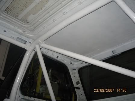

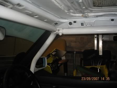

[img][img]http://i142.photobucket.com/albums/r117 ... G_2094.jpg[/img][/img]
[img][img]http://i142.photobucket.com/albums/r117 ... G_2093.jpg[/img][/img]

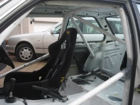

For PBMW just weld in another horizontal bar across the main hoop behind the seats, job done. When PBMW was the original SELOC challenge with lots of novice drivers, without the track day cones out for guidance they tended to drive into each other a lot. So rather than clamp down on driving standards, they changed the regs to make it safer to drive into each other
