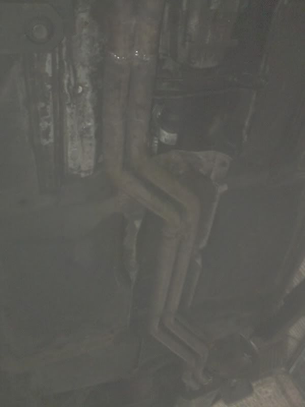

I use an aftermarket E30 M3 system on my M52 car, twin 50mm tube, I wouldnt advise anything less tbh, certainly not 2.5 inch single pipe.
It has only a backbox, no middle silencer, not too loud, I do have a reading from testing equipment somewhere, will have a look.
Crap pic, but its the only one I have

Thanks for the picture!. You know what kind of aftermarket exhaust this is?

Im not sure what the make is, there are no markings on it, it has an x pipe at the front just behind the joint to frontpipes, unless you have emissions rules to stick to theres no point using a cat, I seem to remember it being around 87db when ive had it tested at track days
