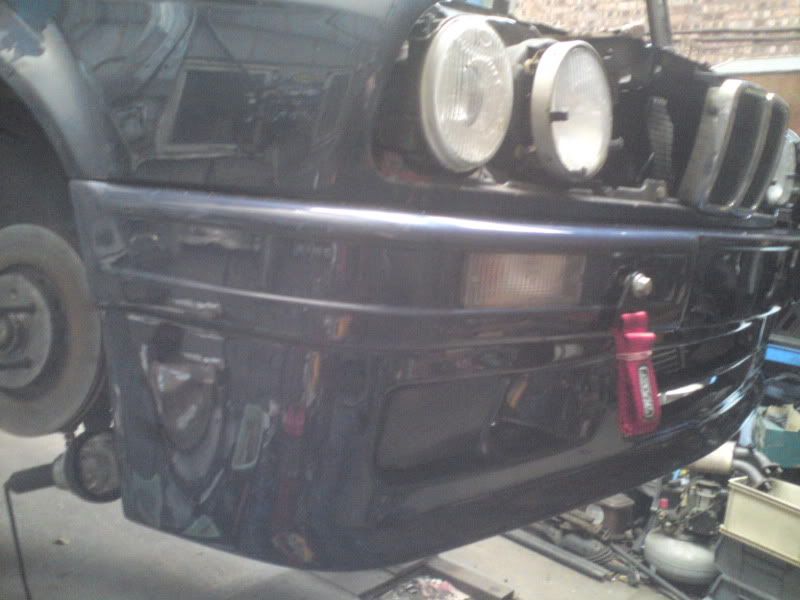

Rich got one of those myself and the local garage installed it:
Some welding was done, that's all I know sorry.

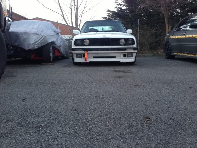

This how I bodged mine on

dan, what size bolt did you use to fit it??DanThe wrote:Neat job /\
This how I bodged mine on![]()

I just cut the bumper and went through the bumper bolt.

Speaking as a marshal, I wouldn't want to be standing in line with the tow line (usually a wire rope) when the head of the bolt snaps off, if it's as per DanThe's install.
With the greatest respect, the bracket is clearly designed to be mounted horizontally, i.e. above or below (or even on the side of, I guess) the chassis rail, so that there is no tendency for the plate to bend and try to pull the head off of the bolt.
I've seen these things fly off on numerous occasions (some even caught on live TV) and the results are never pretty - the best outcome is that your bumper gets pulled off, the worst is that the wire rope gets you at shin height - I'll leave you to imagine what the results could be.
The best install I have seen (NOT) was on a BTCC car built by a team of some repute where the fixing plate was fixed to a bracket which in turn was attached to the front subframe with four 3mm pop rivets - I kid you not. The result of that was that the front bumper of the car was pulled off and the marshals were roundly criticised by one and all for being incompetent - oh well, cant win 'em all. All caught on TV of course
Kim
Kim

The best is a nice solid bracket that welds to the chassis rail. I too would not mount a tow strap like that (but I think the bolt is seriously large so would probably hold!). With these cars you have to be careful of rusty bumper mounts!
