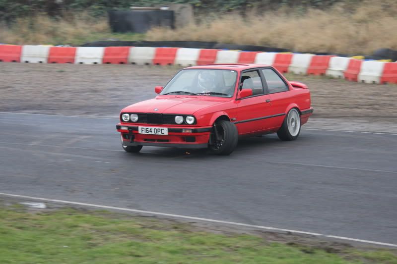

70º of lock!? Thats 10º more than what the best drift control arms will ever give you! Are you sure its 70º?
- Homo Hair
- Posts: 20362
Kos
- Posts: 15448
- Location: London / Cyprus
enough lock
Demlotcrew
- Posts: 13329
- Joined: Mon Dec 20, 2004 11:00 pm
- Location: East Anglia
That's the arms Kos, you can see them, they are anodised blue and offer a maximum of 60° lock. The arms are about £1k.

Darrenr
- Posts: 276
- Joined: Thu Jul 21, 2011 11:00 pm
The last pic is wisefab which is £1200 we made our own kit which has more degrees of lock, wisefab always run without wings etc the first pic is my car before i added fenders skirts etc

How did you get round the steering locking past 60º? I think that if you were able to make up your own arms then its you that should be telling us how prep for races

Those photos are classic - not seen that much lock on an E30 myself!
