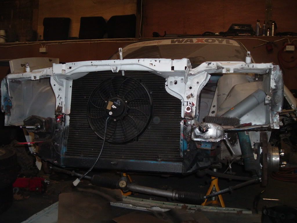

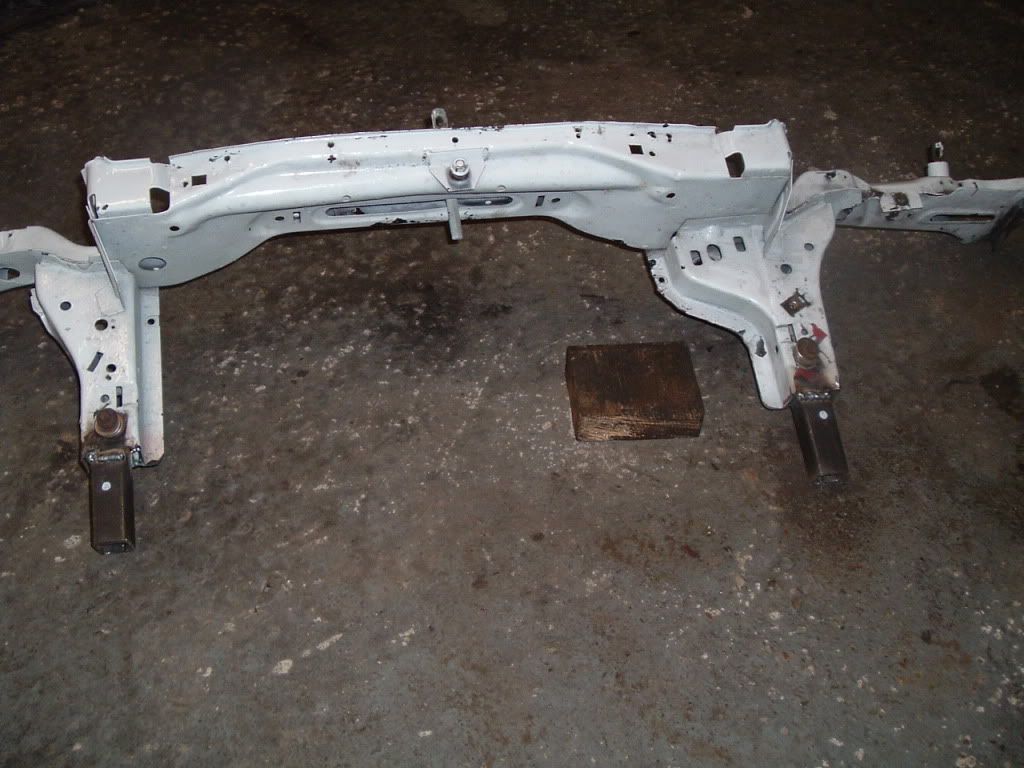

Hi,
We've done it on the E30 racer we're currently building.
Trying to upload images via Photobucket, but its running really slowly at the moment :x , so I'll try again later.
In a nutshell, we cut off the two main upright sections near the bottom (leaving enough metal to drill fixings in the remainder) and drilled out the spot welds where the slam panel fixes to the inner wings. 8O
We then welded short lengths of box section into the uprights of the removeable section, which then 'plugs' back into the base, and is fixed with through bolts. The slam panel is fixed to the inner wings with screws into captive nuts welded on underneath the inner wing panel.
The pictures would show it pretty clearly, so I'll have another go in a bit. :D
Kim.

kimbo
Posts: 150
Joined: Fri Aug 03, 2007 11:00 pm
Post Sun Jan 23, 2011 5:28 pm
Finally managed to upload pictures of the mod described above.
Hopefully all self explanitary.
Kim

Post Tue Jan 25, 2011 5:35 pm
staley_turbo wrote:I dont understand why?
So that if If I need to get the motor out quickly in the paddock during a race weekend, I dont have to beg an engine crane and lift the motor 5 feet in the air to do it. :eek:
With the front off, the motor could be removed by two people with a length of scaffold tube, one each side of the car.
Kim :D
