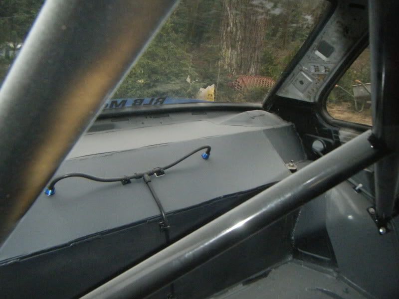

Here's some pics of mine.
Seat mounted using standard mounting points on a fabricated 5mm steel base:
Battery cable and loom wires are all covered in plastic spiral wrap to keep them goo free and tidy:
All rather busy but internal copper pipes, extinguisher lines and wires; wrapped and mounted using rubber lined metal p-clips and bolted using M5 rivnuts and M5 cap head screws:

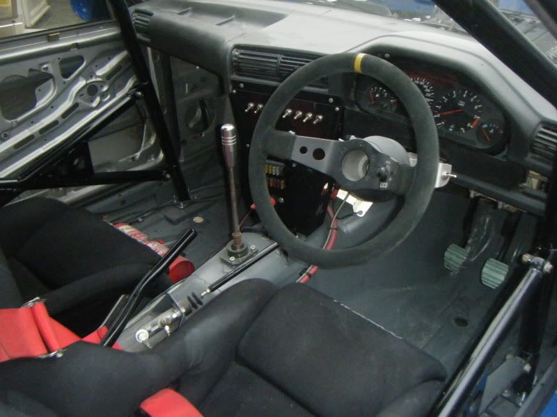

Here's mine, I rewired the car from scratch, hence no bmw switchgear or cables running all over the shop. How to do it depends entirely on the purpose of the car. Also remember that you want to build it to MSA regulations and not FIA. Contrary to how it should be and the way people think it works, FIA Reg's are not always treated as superior to those laid down by the MSA. Buy yourself a current MSA blue book and start from there.
Mine (it has changed a little since this photo, but the general design has not changed),
A pretty similar trend appearing, although I have retained the original look more than martinpallot. Again, like Martin said, it comes down to your requirement for the interior.
Mine has been completely striped as well, the dash removed and all unnecessary wires removed and all remaining wires bundled together using conduit. We then put the dash back in.
Also, a good idea is to re-position the alarm panel to the space made vacant when you remove the radio, or the heater controls. It fits a treat, and has heaps of wire so you do not need to rewire it (that is of course, if you are keeping the alarm panel).
