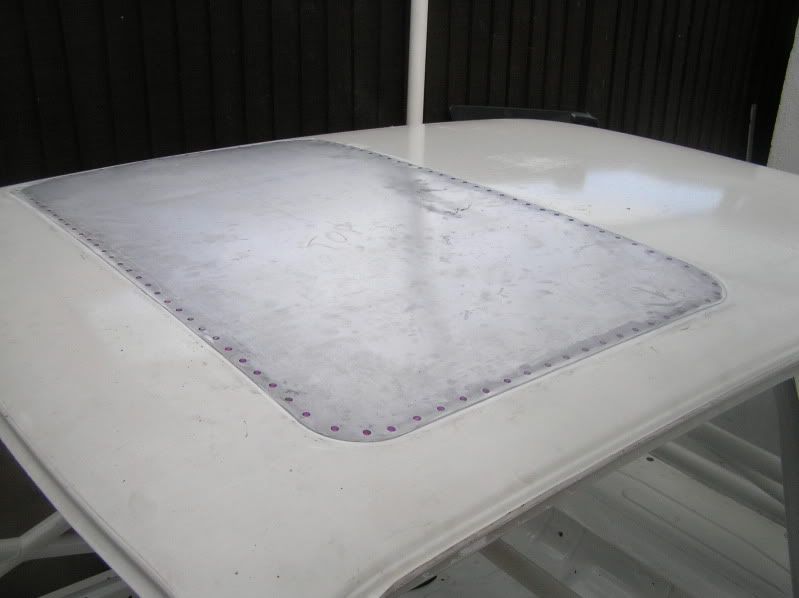

Have a look at my PBMWC build thread below, there are some pictures on there.
I used some steel the same thickness as the original skin and pop-rivetted it in place like you said.

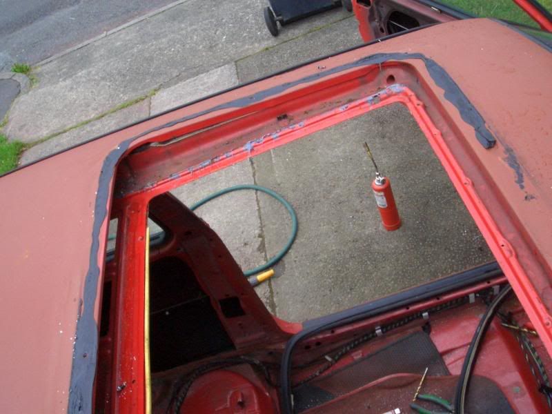

Just a quick update, been cracking on the last few hours, what a pig of a job. Found the angle grinder to be hard work and very messy so started drilling the welds. Went fine for the first 5 tabs, came off great, just doing the last one and started drifting off thinking about god knows what......
....result........10mm drill bit through the roof.....bollocks
Hers a pic or two, didnt take many as I was having a stressful day sorting the car.
Hole, in reflection its more 8mm that 10mm...
After already riveting and bonding the plate once I had to pull it out and remove it! Gutted.

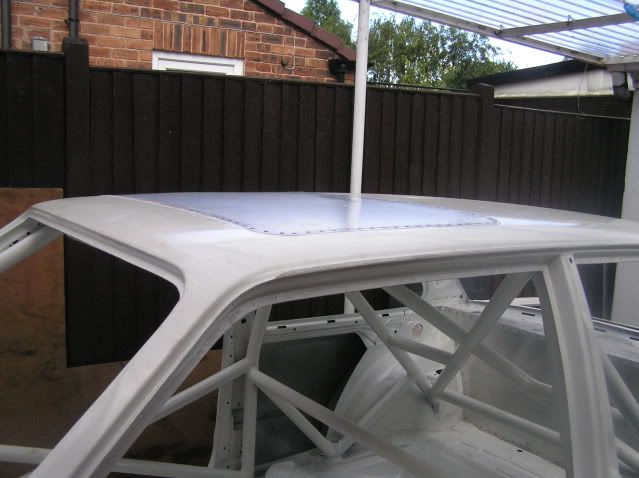

Did mine the other weekend. Went for the riveting option and really happy with how it came out! Just needs painting now.

Nice looking shell mate.... what are your plans with it? PBMWC? ;0)

Cheers guys! Looks a bit like a spitfire or something with the solid rivets being used every inch.
Plans with the car is to rally/hill climb it, and use it as a track toy occasionally. Wouldn't be eligible for PBMWC now, which is a shame as after watching it at oulton park the other week it looks like really good fun to do!
