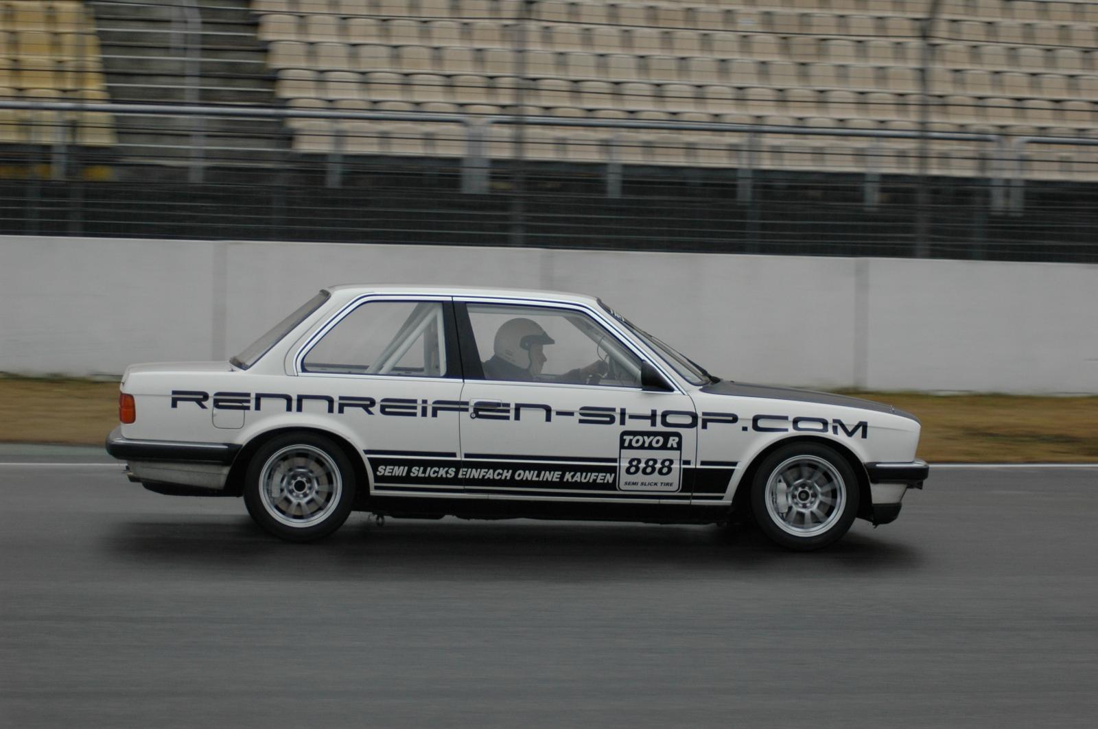

Hi,
last sunday i stay in Hockenheim for a Trackday / Touristicdriving. I had my first rollout after the winter to test the new brakesystem with Brembo calipers in front and rear. I use the original mastercylinder from 320i with 20mm/19mm but no brakebooster. The braking balance is perfect. No "overbraking" at the rear tires, normal pedalway and the brake is perfect to dose. For cars with brakebooster it will be better to use the mastercylinder of 7 E32 with 25mm. Otherwise you will have with small power on the pedal blocking wheels. The brakingpower is not so good to dose.
I think you know what i mean.
Here is a picture:
Here is a picture:
