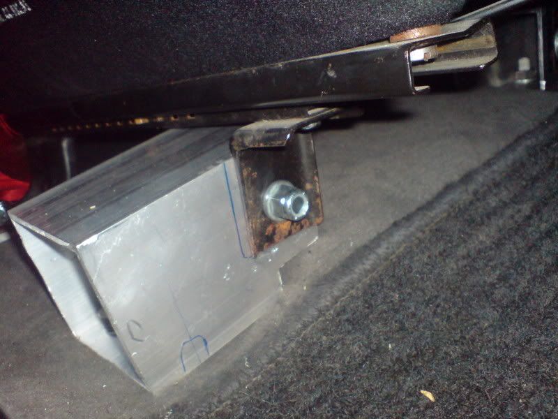

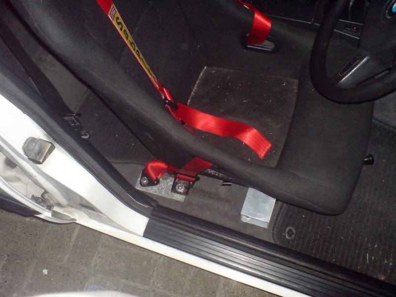

Needed something that I won't slide off, for the ring, and had an old pair of corb's with mini (classic) sliding subframes on in my garage, so had a crack at fiting them. Thought it'd be worth posting on here as it was easy, and mini buckets seats are dirt cheap on fleabay. Three piece harness bolted into original seat hole. and I extended forward with a 1/4 inch ally bracket with a bolt through.
front bolt hole needed to be brought forward and act as mini's crossmember, so 3x3 inch ally was £15 from ebay.
Had to cut notches out to clear rear heater channels. next time would probably go for 5mm ally box for piece of mind.

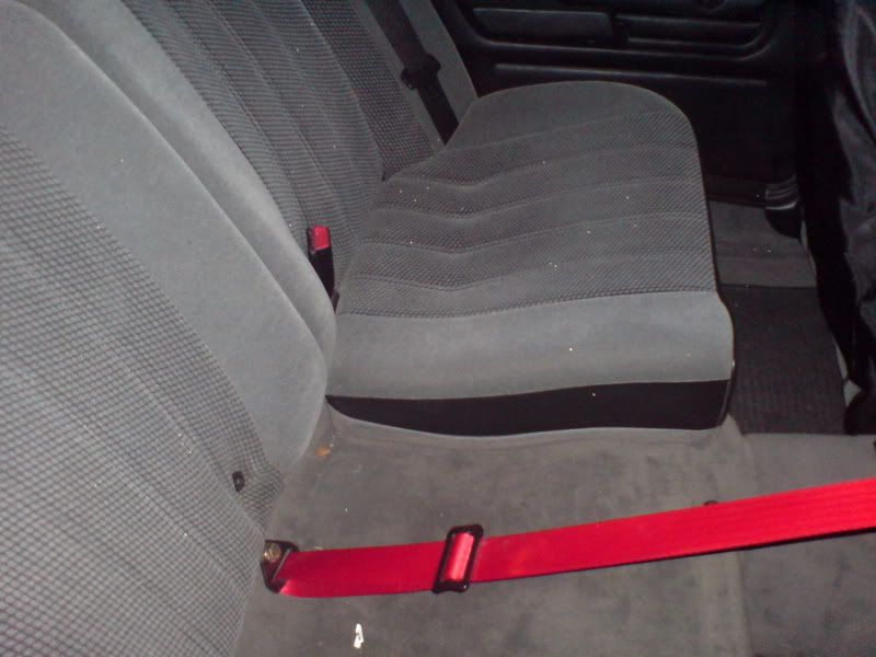

Rear part of harness bolts in where rear seat belt holder is removed.
Only did it as a stop gap measure, but quite like the look of them.

Just my 2p's I would be very worried about the choice of material on the brackets

Yeah I've had second thoughts and gonna find some 5 or 6 mm ally box.

I fitted some buckets (mamba they are originally destined for a classic mini but never used - ebay bargain!) in mine using box section from B&Q, think its about 20mm square and proper steel so nice and strong!

Yeah I can get hold of some 3.5mm steel box, that'll do the trick.
