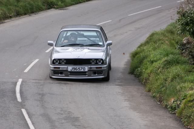

Image[/img]
Hill climb on the Isle of man
Image[/img]
A wet track day and went in way too quick - spun after this shot!!

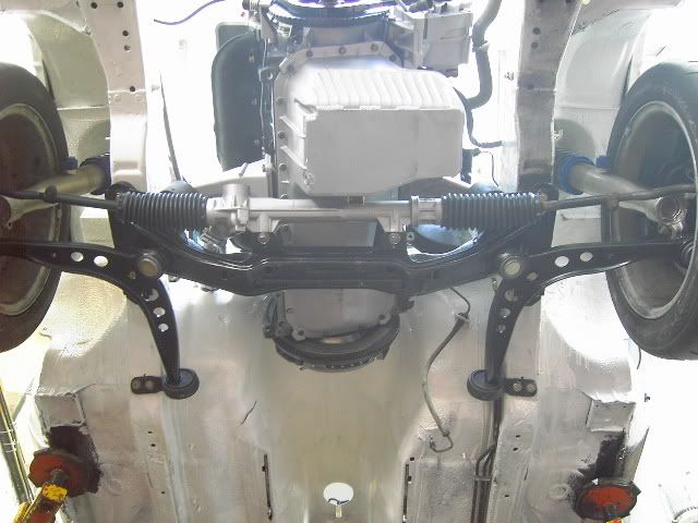

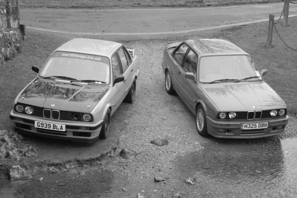

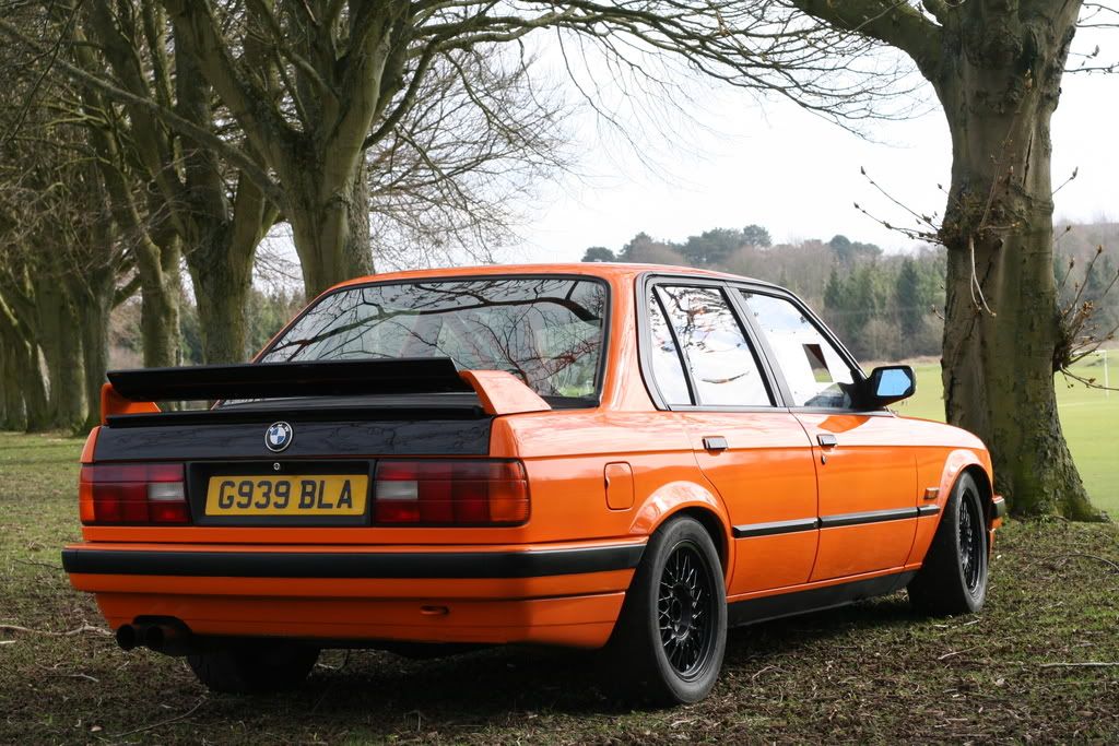

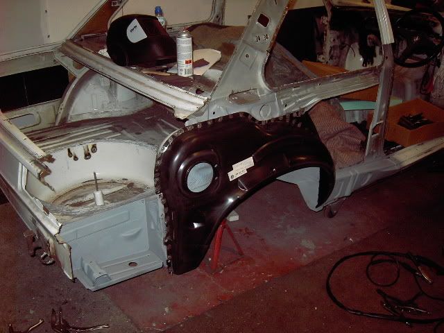

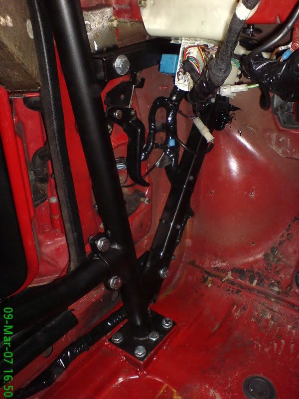

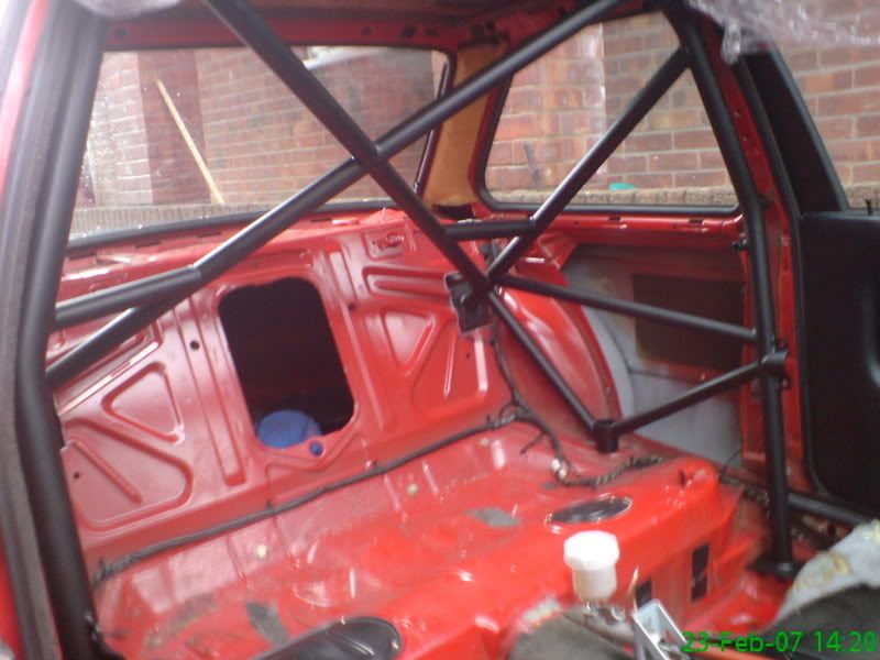

Pretty sure most of you have seen my build thread.
From this
18 months later to this
Custom cage (nightmare) roll cage
H&R coilovers
Std engine with a good service
Torque technique exhaust
Fully poly bushed
Fibre glass bonnet and adjustable rear spoiler
Placcy windys
AP brake bias
Z3 shifter
EBC pads and discs
One cobra evo with 6 point harness
Std wheels furbed and coated black
R888's
1060kg's. That's about as low as I can get it without going to extreme or very expensive measures.
loads of other bits and pieces I cant think of right now.

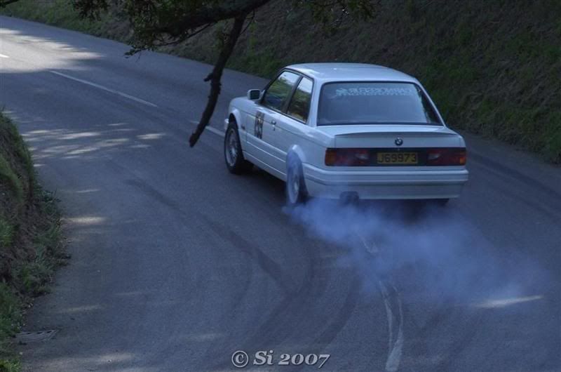

Me racing up the hill, i have fitted the new suspesion now so hopefully it won't roll so much!
I am thinking about orange wheels, what do you think??

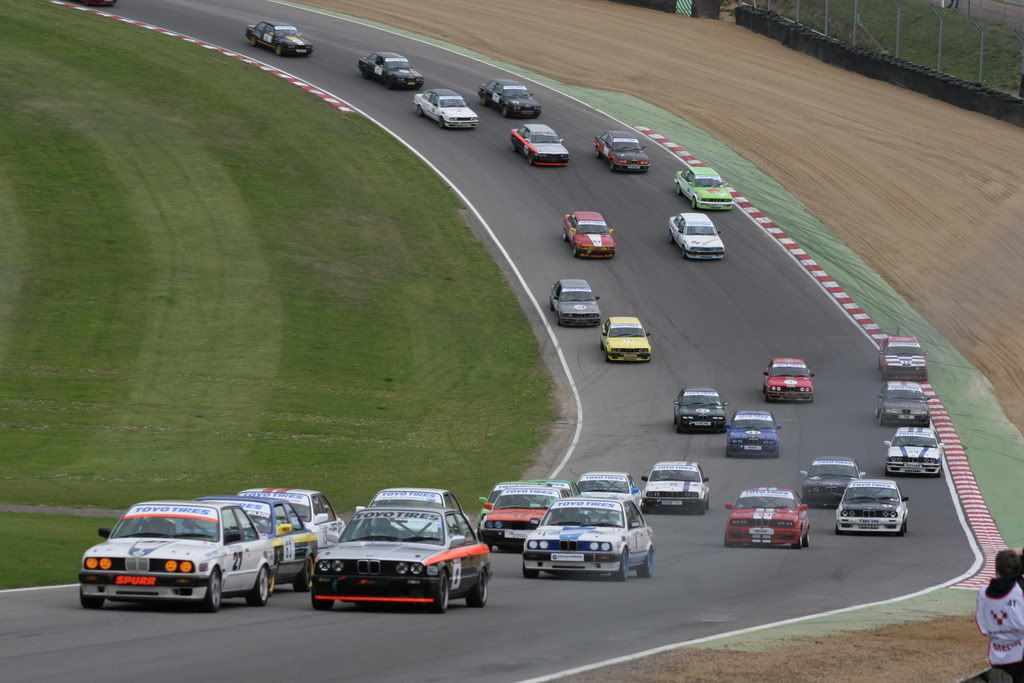

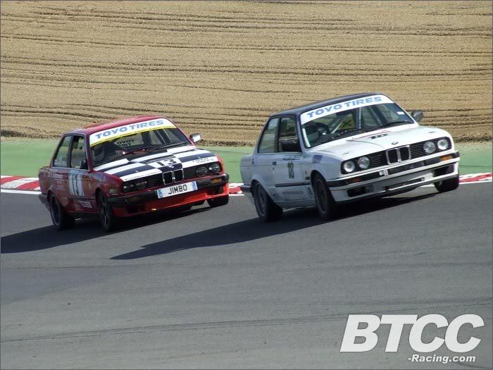

From shreks first race, Paddock sideways:
Made it to tenth at one point :)

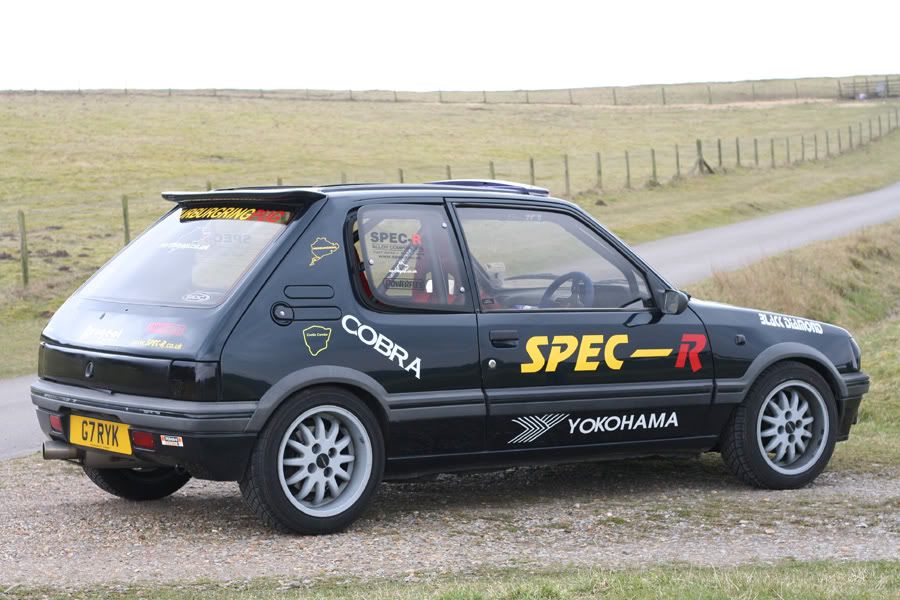

No one said anything about it being only e30's :P
Spec:
Pug 205 mi16 with a badly spaced number plate.
4 cylinder 1.9 16v engine
160bhp
80psi cold idle
45psi hot idle
39 psi very toasty idle
Surely a record for an mi16!
Partially stripped interior
Weight: About 870kilos
4 Speedline wheels with full racing slicks
2 Speedlines with toyo r888
2 Speedlines with toyo t1r's
EBC front pads for stopping
Adjustable front and rear suspension coming soon
Future plans:
Fit above suspension
Fit a cage
Fit some nice bucket seats
Probably fix it when it breaks
All in all, it owes less than a grand :D

I do like the 205 1.9 gti even if it's FWD wrongness, you have the best colour (girl comment I know)
A pal here has one in Rally spec similar power - nice :cool:
Anyway - Back to E30's :cool: winkeye :twisted:

Nice Pug, Jon.
Awesome little cars.

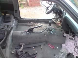

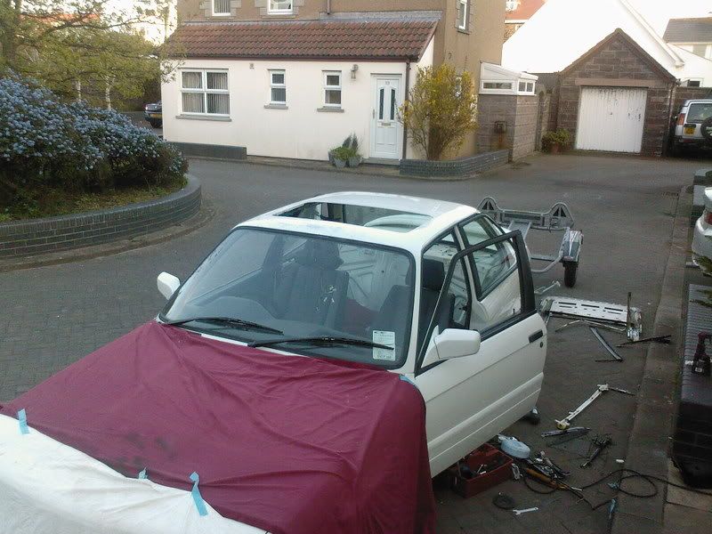

-and just ordered. safety devices B6 18 point roll cage with front triangulation.
so not really finished yet but good enough to have some fun in for the mean time.
took the sunroof tray out the other day after putting the job off for weeks. managed to bend the roof slightly, but my trusty pannel beater will sort that out while plateing the roof as if the car never had a sunroof.
i hope kevo doesnt mind me using his pics but this is the cage i have ordered. went with this one as it mounts to the rear turrets for strength wich is a good thing with the Gaz coilovers. and didnt want the hassle of a custom cages weld in. so this is the next best thing.
stuff i need to do to finish it is
-Gaz coilovers.
-wilwood brake kit,
-fibre glass bonnet and boot,
-sump and tank guards
-hydraulic handbrake, bias valve, lines in car
-extinguisher plumbed in.
-get it log booked.
-fit new engine, dont know what im fitting yet but will be 200bhp plus.
then just pretty stuff like
-guages
-flocked dash
-carbon interior pannels.
but before any of that i just want to drive it. :mad:

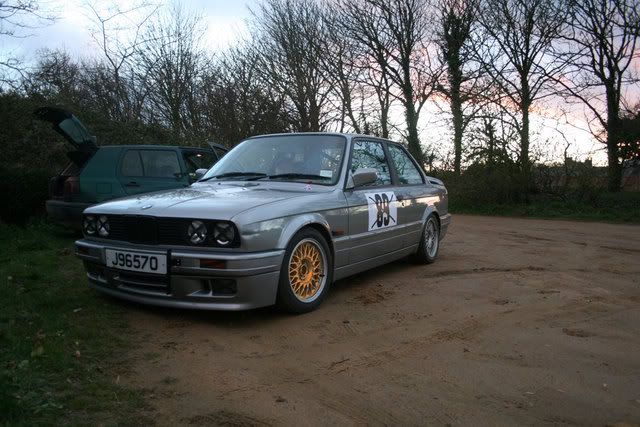

found a pic of when my mate had it and did our local hill climb in it (same one as Trise30rally did).
then it wasnt the greatest, standard suspension, needed a good service, crap tyres. wrong diff oil, well i think it was it certainly locks a shit load better since i changed the oil. so if i dont beat his time there is something wrong with me.

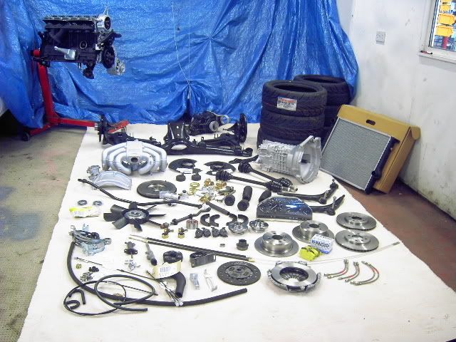

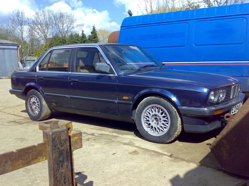

I've had my 320i for about 3 years now but started turning it into a race car about 6 months ago.
E30 320i for the Production BMW Cup.
First race completed last weekend at Brands Hatch.....
Still a few things to do like new exhaust system and some better front top mounts + passenger seat, and the most important thing is the new 'make-over' / spray job :wink:
Major purchases so far: (All work carried out myself - except roll cage installation)
OSR 1/4 panel (wing)
OS outer sill panel
weld cons', auto weld mask, spot weld punch
Multipoint CDS weld-in FIA Roll Cage
OSR battery tray / chassis leg
cambelt, tens, w/pump, head set, bolts, viscous, fans
Cylinder head pressure test
M20 engine rebuild, gaskets, bolts, nuts, O-rings etc
Cutting discs, jigsaw blades, pink paint, brushes, s/paper
Helicoil M8x2 - exhaust threads in M20 head
Gaz coilovers, front and rear, + top mounts. 600fr 300rr
Baffled sump + 3mm protection plate
Front & rear suspension consumables
6x Toyo R888 - 195/50/15
Powerflex bush kit - Black
Handbrake,wheel bearings,discs,arms,tie rod,eng mount
Roof panel - non sunroof
Pagid RS-29 front pads + 6 line braided flexi hose kit
Caliper seal kits, diff seals
Radiator - Tropical + Air con
Fuel pipes, vents, exp tank stuff, metal fuel and brake lines
Clutch, prop donut & bearing, ex mounts, clutch slave + mast
House of Kolor - Rose Neon x 2 litres
Cobra Evolution S, Side mounts, 5 point 3" black harness
Gearbox seals, rev switch, Z3 shifter, gearshift renew kit
Clutch cons, rear main, fuel exp tube, sparks, oil cooler seals
White body sealer x6 tubes
Fire extinquisher - 3.5L Electric kit with ADS

Very jealous of your cleaness James! Finally managed to stop engine oil going everywhere (by changing the engine!) and now the gearbox wants to cough it's guts up every session! Fed up with the brake cleaner/rag sessions so it's time to fit a catch tank to it...

As we're showing 205's too
From this which cost nearly £20K new and looked just like this.
Now it lives at the ring and looks like this
