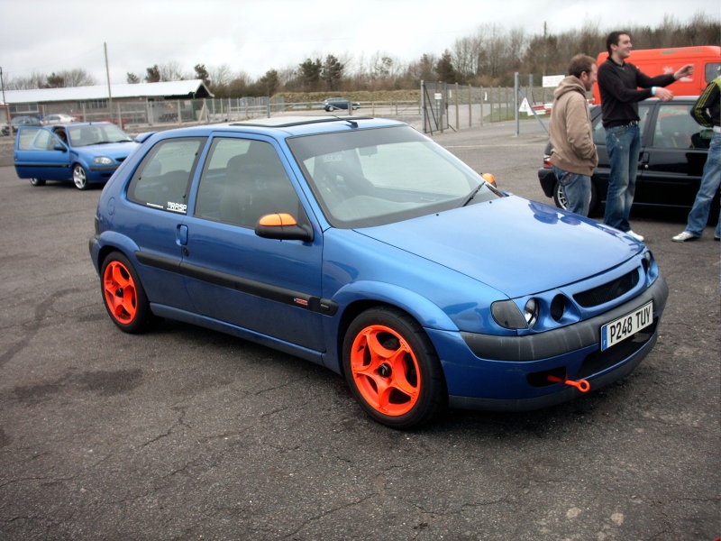

Jhonno - dampers are Koni adjustable on the front, Gaz coilover rear.
Here's the car that passed me :
PS - Tomson, it wasn't your wheel bearing that failed - I bought the adjustable Konis from rossle on here and he sent me a pair of complete struts
Since I had to strip them down to remove the shocks, I thought I might as well build the coilovers with them!
I still have the struts you sold me, less discs and pads (post 'Ring emergency repair) and one wheel bearing used to replace the dead one.
If someone wants a pair of 51mm struts, converted or standard, PM me.
