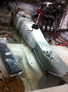

well i decided to run the fuel lines inside the car which are Teflon lined to meet MSA regs and stop them from sweating fuel vapors.
i am going to be running the brake lines inside today also as its soo much easier in stall and maintain.

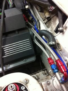

Hi ben, just wondering, what fittings are you using for the facet pump? I bought some 1/4 to -6 but the thread feels so tight they feel awful.
Driftben
Posts: 1144
Location: Westgate on Sea
Mon May 07, 2012 6:15 pm
Hi Roy
I have a AN-8 to 1/4 NPT feeding the facet pump and a AN-6 to 1/4 NPT outlet?
I must admit they were very tight winding them in there. They don't seem to leak at all though so the seal must be ok?
