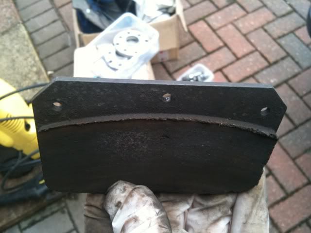

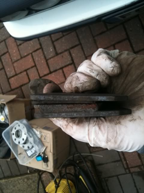

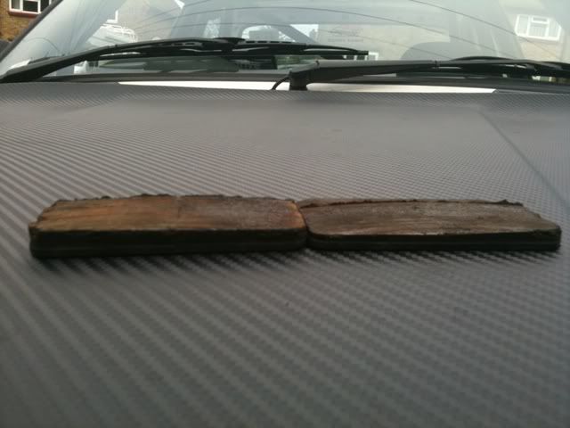

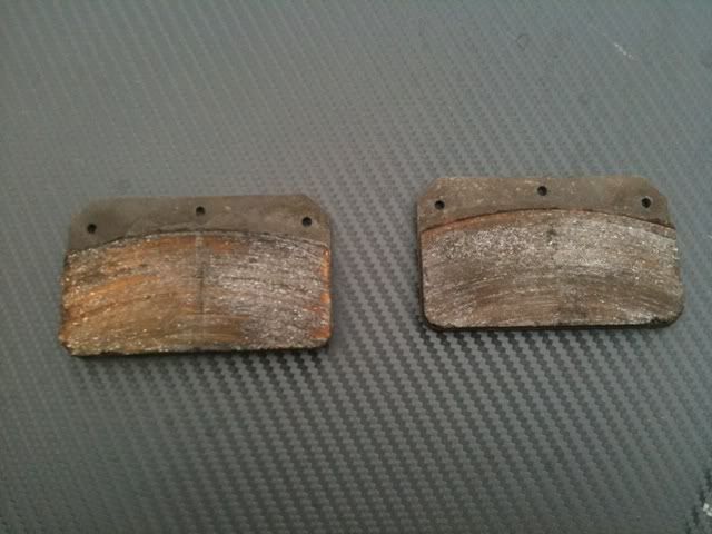

Right, the snow has finaly melted so I was able to get the wheels of today to inspect the discs and the pads....
The discs are showing no signs of any uneven pad deposit marks like the pics you showed however the pads appear to be f*'#ed for want of a better word!!
The driver side pads were absolutely fine with not too much wear at all but the passenger side is a different story. One pad has worn very unevenly (on a slope) and the other is almost through to the metal. (It hasn't damaged the disc yet and its not got that far).
I have linked some pics below for you to have a look at and welcome any suggestions as to why it happened and how to avoid it. Obviously I am going to need to replace my pads before Saturdays track day!

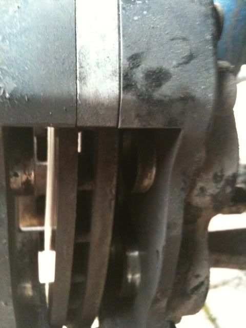

And finally a pic of the offending sides caliper with the pads removed.
One thing I don't know if it's worth mentioning or not but there is no locating screw in the disc as the hole does not line up with the thread in the hub. (Probably not relevant but thought I'd give as much info as possible).

Hi Shane, I've got EBC reds on the shelf, and can get Reds/Yellows sent to you direct from EBC (Parcel Force 24h), but to be 100% sure you get them in time, the pad you're after is the same as the split-pin Wilwood Dynalite uses (the older type, and not the bridge bolt type). Take one of your old pads with you to RD to be totally sure they are the same.
As for the tapered wear, that's normal (but a bit annoying) with 4-pot calipers, and happens because the leading edge wants to "dig in" and tries to rotate the pad, creating faster wear at the front. The way round it is to have staggered pistons (like the WMS 1.62/1.75 size T20) with the smaller piston at the front to cancel the "dig in" effect, but it's less common to do this with smaller pistons. We could break from the convention and do staggered small-piston calipers, but this will add cost to the kits and mean race teams have to carry twice as many spares.
In the case of your pads, they are nearly worn out by the look of them - a race pads (or any pad in fact) has less thermal mass as it wears, so as they get thin your brakes get hotter, and wear faster as a result, plus are more likely to fade. This means most pads get replaced before the wedge becomes an issue - normally at about 50% > 30% thickness at the thinnest part.
Could you post some photos of your discs please? There looks to be a lot of surface rust from the discs on the pads - if your discs are rusty they will of course increase the rate the pad abrasion / wedging effect occurs compared to a clean disc? This normally means the outer pad in each caliper wears faster then the inner as the inside face of the disc is protected from the elements and stays rust-free!
Get a toothbrush and brake cleaner on the exposed pistons to get most of the dust off, then give them a LIGHT rub with something like fine scotchbright to clean them up before you push them back in the bores and fit the new pads.
By the way, the 1mm "lip" you can see on the pads is because Ferodo make their pads 1mm "taller" than the EBC ones (and most other makes I've seen), all WMS kits are based on EBC pads. Of course the lip isn't a problem, just looks nasty!
The reason for the lack of locating screw-hole in the disc is exactly the same as the same-size pistons: cost for the customer.....most people would rather pay less and not bother with the screw!

The uneven pad wear on one caliper would indicate sticky pistons not retracting to me.
When using new brake pads of a different compound, scrub the surface of the disc with emery cloth to remove deposits fom the previous brake pad material, otherwise from experience you will suffer horrible vibration. I use wilwoods and wilwood pads.

e301988325i is right about scrubbing the discs clean, and made a good point about the pistons - I would get out there tonight (sorry!!) to clean the pistons and push them back in. They should go back in by hand or "very easily" if you use a clamp, if one of them is sticking let me know tonight so I have time to get some seals to you.
Just to be clear, the "wedging" is a seperate issue and happens with all similar 4-pots even if the calipers are perfect.

keri-WMS wrote:Just to be clear, the "wedging" is a seperate issue and happens with all similar 4-pots even if the calipers are perfect.
I had problems with this and found the caliper not sitting perfectly to the disc. I checked this by mounting a magnetic dti (clock) on the wheel bearing and rotating it (the wheel bearing and clock) along the caliper.
The strut mounting mount points don't have to be perfect, sliding calipers will accomodate some misalignment. I found a good trick was to use stainless washers instead of steel ones as they are about 0.2mm thicker when compared size for size. And this gives some fine adjustment. After this my tapered pad issues improved significantly,
To the OP, I think your pistons sticking have caused tapered wear as bad as you have shown in your pics.

e301988325i wrote:to the OP, I think your pistons sticking have caused tapered wear as bad as you have shown in your pics.
It's possible, but wedging is honestly very common/normal with non-staggered calipers. I guess Shane will find out when he pushes the pistons home. Here's what Wilwood have to say:
www.wilwood.com/TechTip/TechCaliperTip.aspx
"The caliper should be mounted so that the smaller piston end is closest to the rotor entrance, and the larger piston end toward the rotor exit. The larger piston end provides slightly greater clamping force to compensate for pad taper that can occur under extended severe use applications."

I had exactly the same pad wear after a session at Oulton Park, ran the brake setup for about 3,000 miles of normal road use with perfectly even wear, then with only one days hard use they turned into door stops! These were EBC reds that seemed to disintegrate very quickly on track

I run the Poly B's in my 6 pots and they seem to wear well under normal conditions.
You do get pad squeal under light application but some back road blasting soon cures that though.
No sign of tapered pad wear with differential bore pistons
