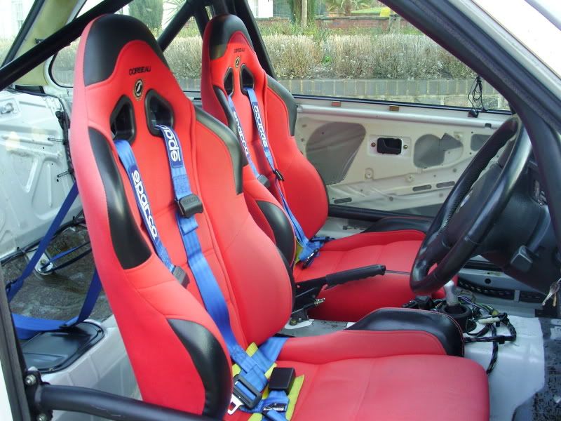

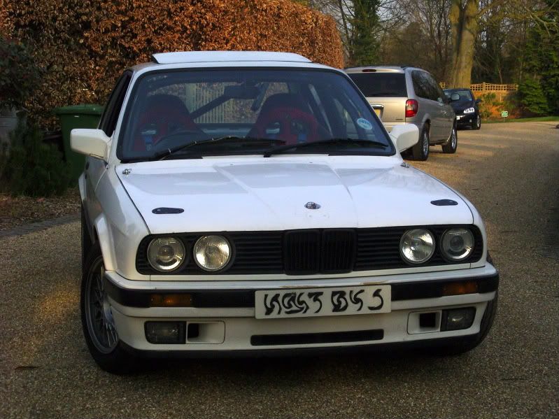

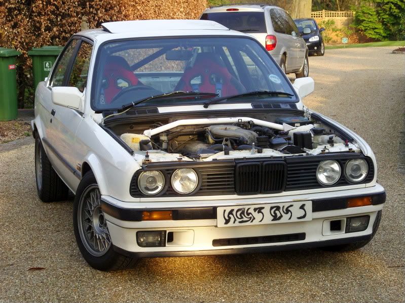

What is the blue thing in the place where your light should be?northloop wrote:Pretty sure most of you have seen my build thread.
From this
18 months later to this
Custom cage (nightmare) roll cage
H&R coilovers
Std engine with a good service
Torque technique exhaust
Fully poly bushed
Fibre glass bonnet and adjustable rear spoiler
Placcy windys
AP brake bias
Z3 shifter
EBC pads and discs
One cobra evo with 6 point harness
Std wheels furbed and coated black
R888's
1060kg's. That's about as low as I can get it without going to extreme or very expensive measures.
loads of other bits and pieces I cant think of right now.

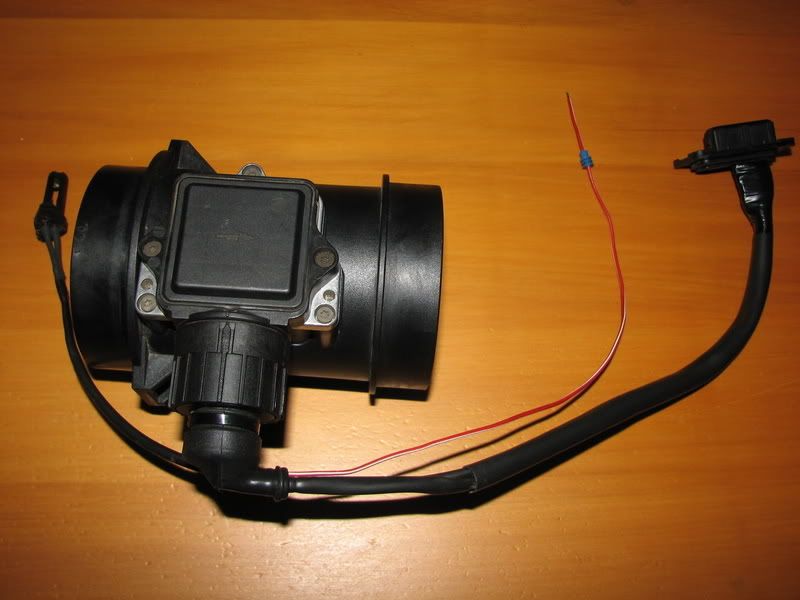

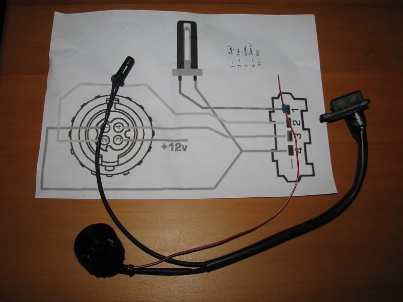

easy make one of these
using
Siemens MAF (p/n 1 703 275) out of an E36 328i
Siemens MAF to ECU connecting plug
M20 air temperature sensor from AFM
M20 4 pin male plug off M20 AFM

zimmer-320i
- E30 Zone Camper
- Posts: 1309
- Joined: Mon Sep 01, 2008 11:00 pm
- Location: sevenoaks
yes and yes.
needs remapping but the increse in response is really good. and not only that you get rid of the nasty flappy shite that was invented!!!

MAF looks like this:

Will do!oldbimmer wrote:Please let us know how you get on.. Looks like a proper bit of kit.!! Nice..AlpineAde wrote:
I'll post pics when it is all in and running.
Been buggered over in the shipment so we're waiting on that to be put right. Shouldn't be too long now.
Interestingly, their new MAFs are up on their site. They are MUCH cheaper. Might be worth a look for any interested parties. Mine will be one of the last billet ones sent I imagine.
