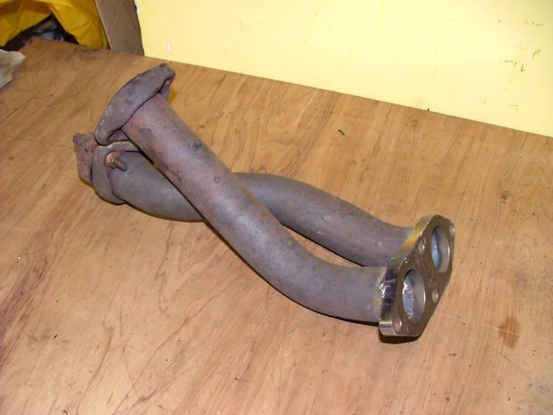

i've still got to get round to tackling this on mine. i have a E36 rack to fit but it's the M30 manifold clearance issues that will cause me problems. i'll have to hack up my nice downpipe assembly to get it all in, which will be a shame.

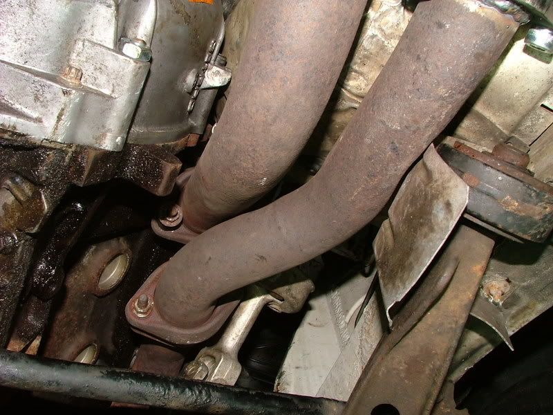

it currently looks like this:
and i currently have about 5mm clearance between the UJ and downpipes. this is the best pic i can find....
at least i could re-route the downpipes a bit so i don't have to squash them so much to clear that bush!
why oh why did BMW change the angle of the column
oh a thought i did have, fitting M3 offset bushes will push the wheel forwards which will in turn compensate for mounting the rack in the front holes. i have these to go on too
