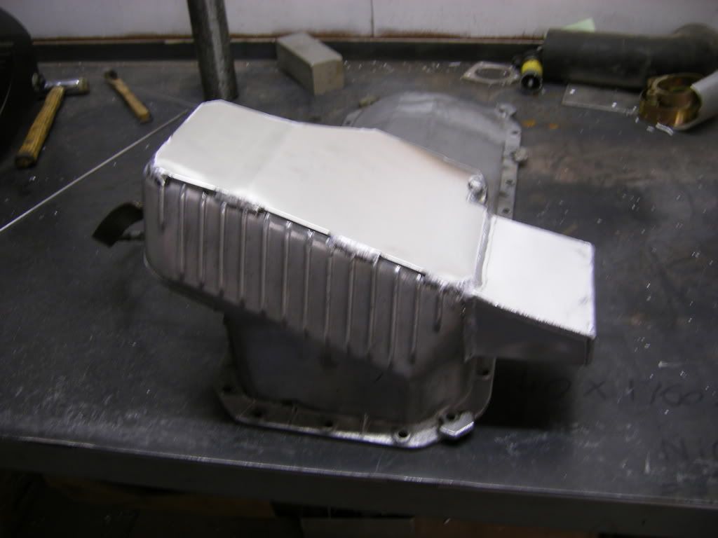

ive been playing around with a 325 sump and have come up with this, just need to add the baffle inside to help the oil. it has an extra wing on the side that holds 0.5litres and a thick alloy plate on the bottom to help guard the sump and protect it. we are still trying to work out a final price but they will be offered on a return basis at around £88inc vat.

was expecting it to be more than that, I'm very interested in one of these!

The sump in the pic is now fitted to my 325i trackday car. Seems ok, apart from the oil pressure light wont go out. any ideas?

Just to say have had sump mod done by Alloyproducts and can voucher for it doing the job. :thumb:
Have just come back from Spa where there is a fast 4th gear down hill left hander and last year the oil light used to come on for a couple of seconds every lap... this year, same track, more grip as slicks and bone dry not damp.... but sump modded and NO light :wink:

M50 - e34 sumps for the 24v guys?

I'll be needing another as I think I cracked mine going round paddock airbourne :(
Be buzzing you later Nigel as have some different ideas i'd like to try out, also need a couple of swirl pots :)
Quality of the work is top notch, just dont try too much stunt driving :lol:

thanks for that, no probs about the sump, have you got another one? if not i may have one somewhere.
your swirl pot is ready, but im struggling to get the disc cut. if you like i can send you the swirl pot first if you like?
call me with any ideas. got some stickers for your car as well :D
24v sumps shouldnt be a problem, i will have to see if i can get hold of one to start on. :D

Excellent design! Would definately be interested in one of these!
Two questions -
1. What will the turnaround be?
2. Can the sump be removed/refitted without removing anything else with engine in place? (Sorry not only a newbie but also mechanical numptie!!)

hi furbster the current turn round is approx 1 week. if its for track days then i would recommend having the extra capicty added as well.
