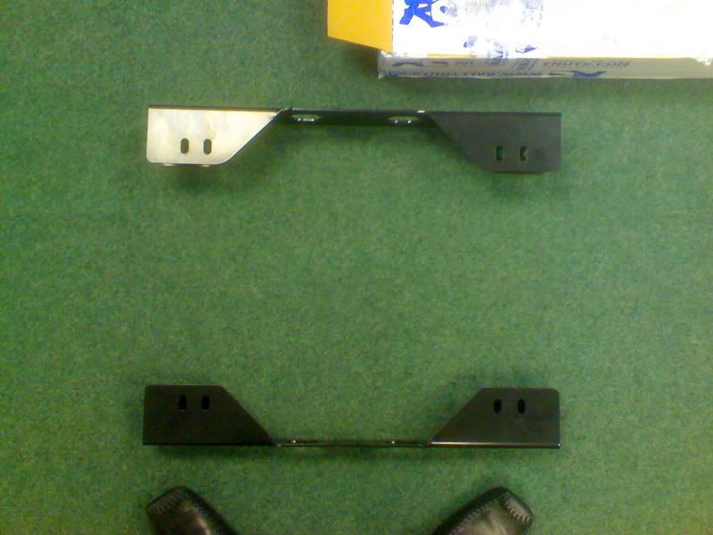

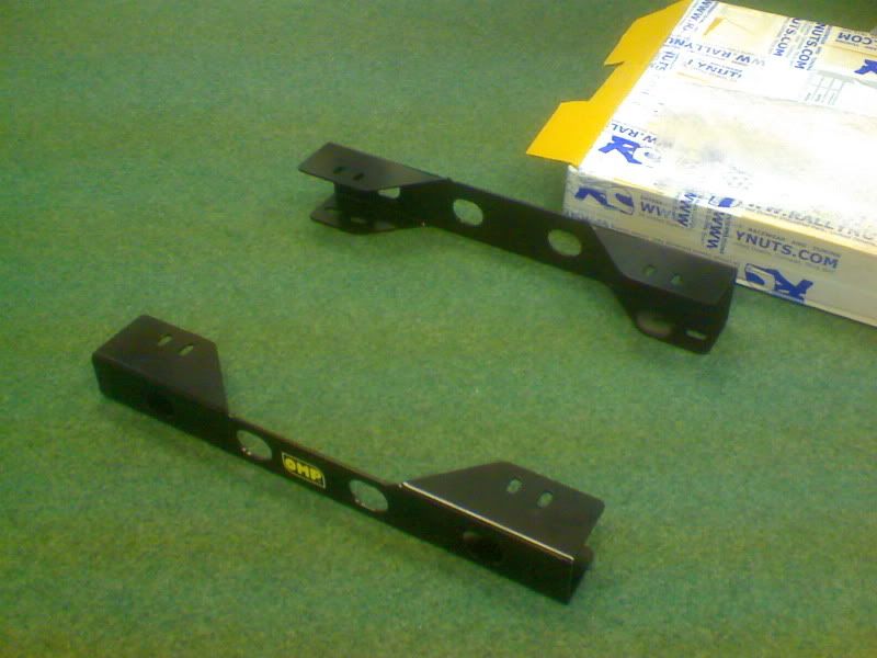

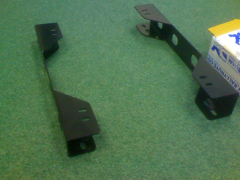

Fri Mar 30, 2007 11:41 am
here you go.

Fri Mar 30, 2007 5:19 pm
My RS is side mounted, so don't think those would fit??

Mon Apr 02, 2007 7:50 am
So is mine, But I asked at rallynuts, and he said the sidemounted ones would fit to those, bloody hell, I hope they do :(
agent006
Posts: 701
Location: Cheltenham
Mon Apr 02, 2007 6:56 pm
Can't see how it would fit. OMP do a set of mounts to convert base mount seats to side mount, but not the other way round.

nice shoes lol winkeye :mad:

Tue Apr 10, 2007 12:53 pm
Mine are side mounted too so can't see how they would fit???
Next picture please of them mounted!!! :D winkeye

Wed Apr 11, 2007 1:39 pm
Looks to me that the side mounts mount ontop of them, and they mount between the car and side mount??
Which will raise the seat, at the same time- nice
If you can send the seats and mounts back, cobra do e30 side mounts for thier side mounted seats- see deal thread
If not its a case of drilling the floors and making a safe/strong mount, I use a roll cage tube running through the floor, but thats a bit involved

Wed Apr 11, 2007 9:41 pm
Looks like if you get a standard set of side mounts then they may bolt together with what you've already got and possibly match up with the original mounts.
