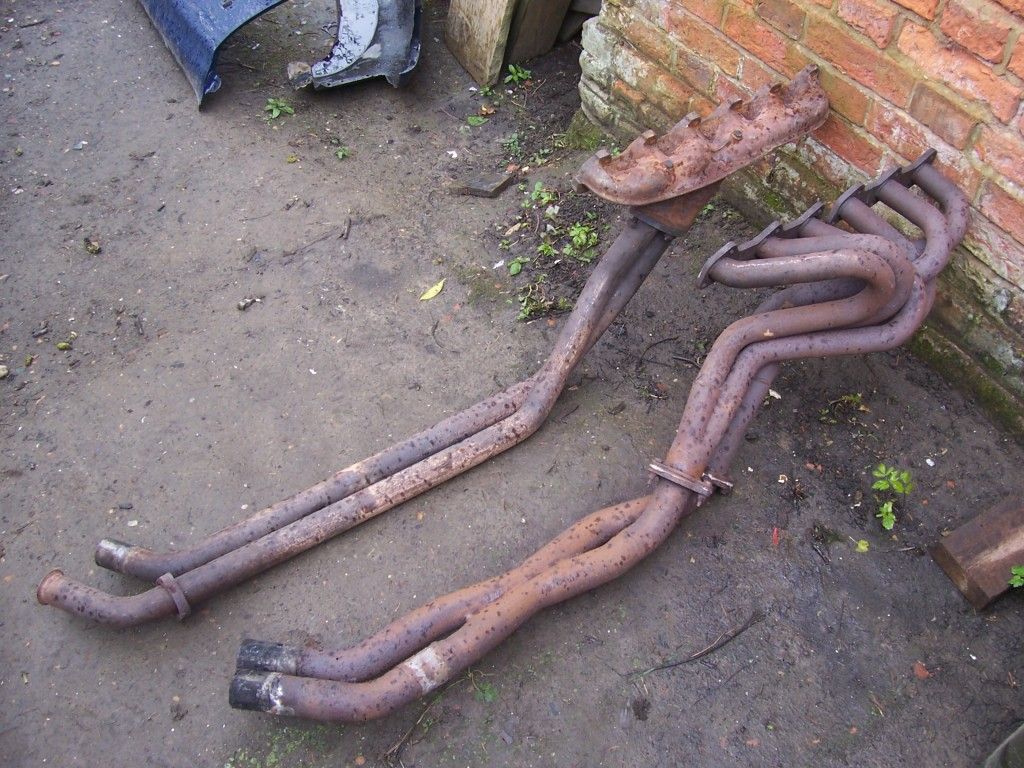

I know this was over a year ago but.. What was the outcome? Currently have an unknown most likely ebay stainless manifold on my e30 6 branch and im wanting to upgrade to a e36 rack would be good to know before buying danthe's kit. Cheers Tommy.
- Posts: 28641
- Location: Staffs
Thu Jul 04, 2013 7:21 pm
Look at the difference in the bends on 4/5/6 in this pic, the collector is further over too
From looking at the pic id say you got no chance
