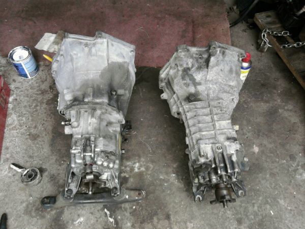

I am under the impression that the difference between the e30 and e36 "is" box is only a different ratio. Is this correct ?

currently putting a box from an E36 318ti compact on to my m42. output flange on the e36 box has 12mm holes and the e30 box has 10mm, the two are not interchangeable due to different splines on the output shaft.
the e36 box is also slightly shorter.
e36 ratios are:
1 2 3 4 5
4.23 2.52 1.66 1.22 1.00
e36 ratios are:
1 2 3 4 5

OK great, I wonder if this means the engine can move back a little bit
Thanks for the good info !

My brother has a 318is e30 with a 318is e36 box fitted. I'll have to quiz him later!alan1272 wrote:currently putting a box from an E36 318ti compact on to my m42. output flange on the e36 box has 12mm holes and the e30 box has 10mm, the two are not interchangeable due to different splines on the output shaft.
e36 ratios are:
1 2 3 4 5
