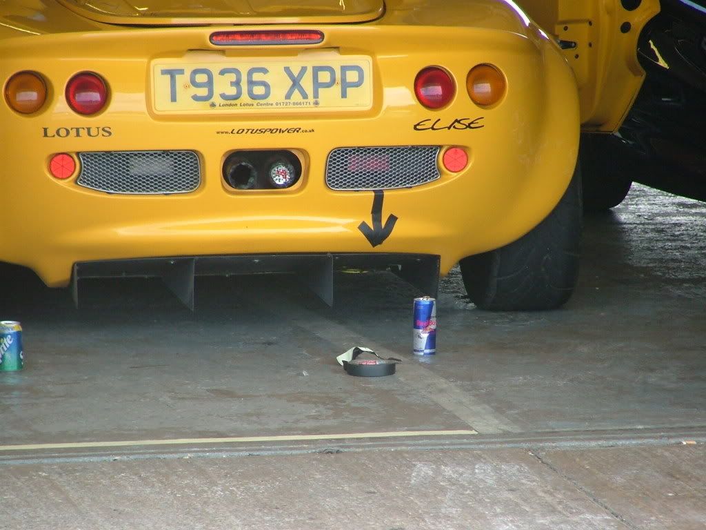

Last time i went this guy with an elise was to noisy because of his exhaust system and resorted to using a a red bull can and black insulation tape
See pic,
Blue Peter stylee!!
