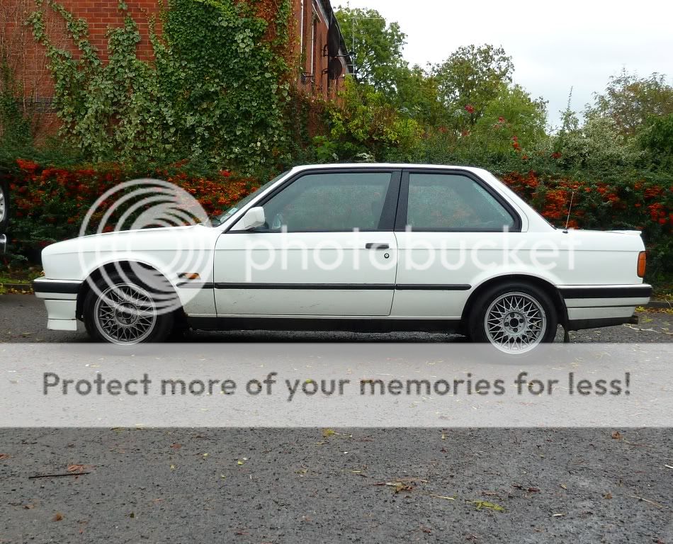

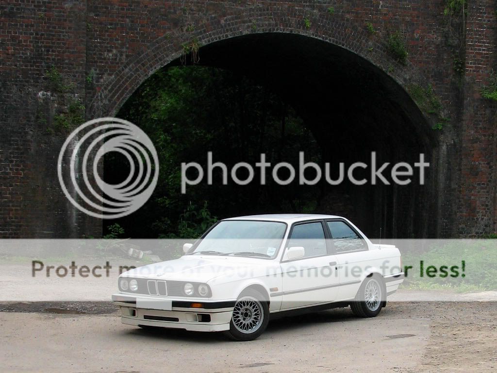

If you're looking for springs to use on track days then these are too soft IME. HnR are stiffer and handle better, for the same quality and Apex work well as a budget option.
I have some IS Eibachs in a cupboard after replacing them with Apex -30 kit. The Apex -30s sit a little higher than the Eibachs and ape the OE M Tec stance of the rear looking lower than the front. Perhaps the -60s are too low for handling and they need shortened dampers so HnRs seem the best option for a bit of everything IMO.
On the road, the Eibachs were compliant but the car felt wayward in faster corners as the front was too soft by quite a bit, when compared to the rear, and for the small change in ride comfort, the Apex springs were a very good upgrade for fast road driving - Apex and HnR share similar rates so the HnRs should be very good also.
If it's just styling that you're after then the Eibachs did sit well.
On the Eibachs and 55 profile tyres
On the Apex with 50 profile tyres
HTH
