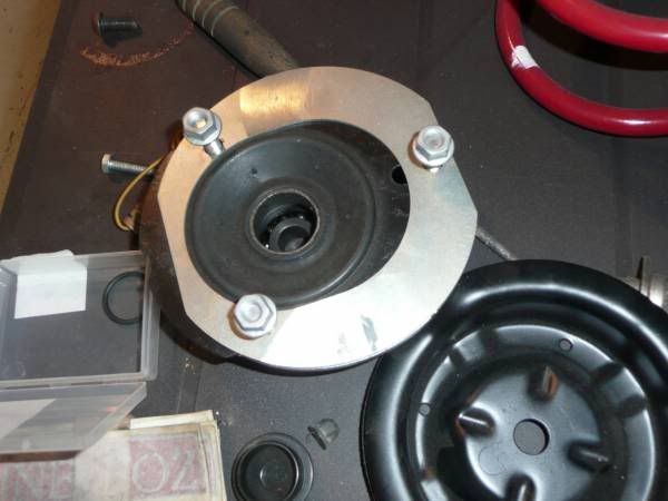

The cheapest way is with some plates similar to the ones Uwe used to make
But you will soon want more :)

DanThe wrote:The cheapest way is with some plates similar to the ones Uwe used to make
Are these some you have had made up Dan?
Sun Jul 18, 2010 11:44 pm
No those are what Uwe used to make

If you dont want adjustablity just fixed camber then you can just adjust standard ones by removing the studs welding some metal on the outer, removing some from the inner and redrilling

DanThe wrote:No those are what Uwe used to make
I know, I know, need to make some more. I am just so tied up with other stuff.
I also developed some solid mounts which won't rattle over time
(ask Jhonno) in the same style as my rubber type.
As soon time allows I will start production. Just don't hold your breath winkeye
