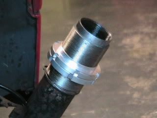

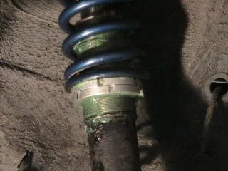

These are the rally design coil over kits,, i think the lock nut that holds the damper in needs to be turned down a little on a lathe. I fitted mine by just cutting off the original spring pan but left the weld intact, i then just dropped the threaded part down with no welding needed. One thing to consider if wanting to lower the car is that standard dampers will bottom out quite quickly,, i have bilstein dampers which work ok for track but aren't ideal.
So you can use the rally design kit then. Stoney, what length springs are you running?

Interesting to see that, looks like the RD threaded tubes are much shorter that the GAZ version. Mine reach fron the top of the strut down to the brake pipe hanger.stoneyV6 wrote:These are the rally design coil over kits,, i think the lock nut that holds the damper in needs to be turned down a little on a lathe. I fitted mine by just cutting off the original spring pan but left the weld intact, i then just dropped the threaded part down with no welding needed. One thing to consider if wanting to lower the car is that standard dampers will bottom out quite quickly,, i have bilstein dampers which work ok for track but aren't ideal.

That's one tube cut in half to do both sides,, it was all i needed for what was a very cheap track biased setup which has got me through a couple of years till i buy something better.I cut the other tube in half and used them as adjustable spring perches for the rear,, cheap as chips.
It is a very compromised setup but has at least cut out lots of body roll on track,, not such a pleasant setup for the road however.

I bought the springs of gunni some time ago and tbh i am not sure of the exact spring rates, i think the fronts are about 375-400 lbs , which on uk roads is a little to much for the dampers to handle.
the rears as stated vary widely,, mine are not a coil over at the rear but are adjustable spring perches that locate in the stock position, i think they are about 600-700 lbs again i am not sure tbh.
Its been a good cheap set up that has got me through many trackdays but i think when i am ready to spend a little more i would probably go for a GAZ race spec set up or similar.
