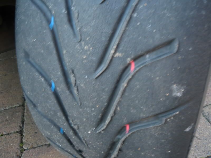

Picture after 100 miles on a hot track, in total I got 5 track days out of them ona car weighing 1100kgs
