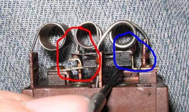

Why do these fail ?
tezk
Posts: 537
Joined: Thu Mar 29, 2007 11:00 pm
Location: Alfreton, Derbyshire
Post Tue Mar 11, 2008 8:54 am
I had one fail where the conductor strip broke away (blue circle) the red circle shows the safety cutout - grime and corrosion can cause poor contacts here.
If I'm ever wandering around the scrap yard, I normally liberate them from and E30s I see.
