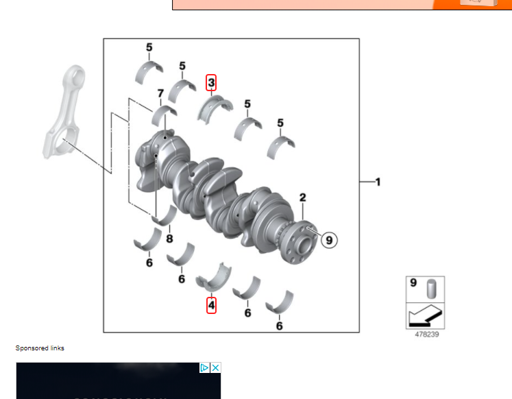

Hoping you can help here. I've got my 2012 Mini Countryman Cooper SD All4 up on a mates ramp trying to source an oil leak. We have the sump off and have found bits of the guide bearings in the pan.
I'm pretty sure its the spacer / winged sections of parts 3 and 4 in the diagram below:
On RealOEM there are three of four variations on both parts, with different colour and thicknesses listed. If I provide a VIN number or something, can you tell me which colour and size bearing guides I would need to order?
Joe

Hi there, yes send us your vin no and we will have a look.
